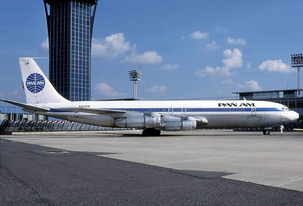

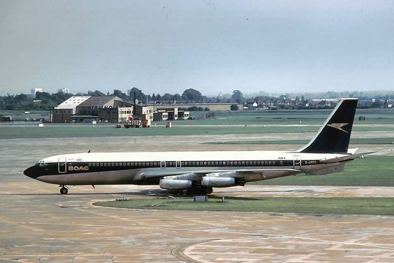

Paul Jefferies Posted September 16, 2016 Share Posted September 16, 2016 Could it be "Dutch Roll" I wonder? Dutch roll is a phenomenon of some swept wing designs and is the reason that fullsized jets have Yaw Dampers. Basically, the aircraft yaws and when it does so, because of the swept wing, the airflow on one side is more across the wing whereas the airflow on the other side flows more along the span of the wing thus creating more lift on one side than the other..... So if it "skids" to the left, it will roll to the right until the whole thing is so out of line that the drag on the fin pulls it back. However in trying to get back to "balanced flight" it has to skid the other way and then it rolls to the left and so on........ in a fullsized aircraft this can build up to an oscillation of 30 degrees or more each way. It is very difficult for a mere human to stop it and hence they invented the yaw damper which is a gyro stabilized device which applies minute amounts of rudder whenever it detects the smallest amount of yaw. If this is what is causing your fishtailing then I think a forward underfin will only make it worse and I think all you can do is increase the size of the fin and/or increase the length of the fuselage by a couple of inches to get the fin further aft....... Perhaps an AFT underfin or big tailskid might do the trick........ Paul Quote Link to comment Share on other sites More sharing options...
Paul Jefferies Posted September 16, 2016 Share Posted September 16, 2016 FWIW the early Boeing 707 had a bad tendency to Dutch Roll....... I am not sure if it was due to our CAA or BOAC but before it flew in BOAC they added an underfin to try and reduce the Dutch Roll...... though it still had a Yaw Damper. A similar underfin should not be too difficult to add to your model. Paul Quote Link to comment Share on other sites More sharing options...
