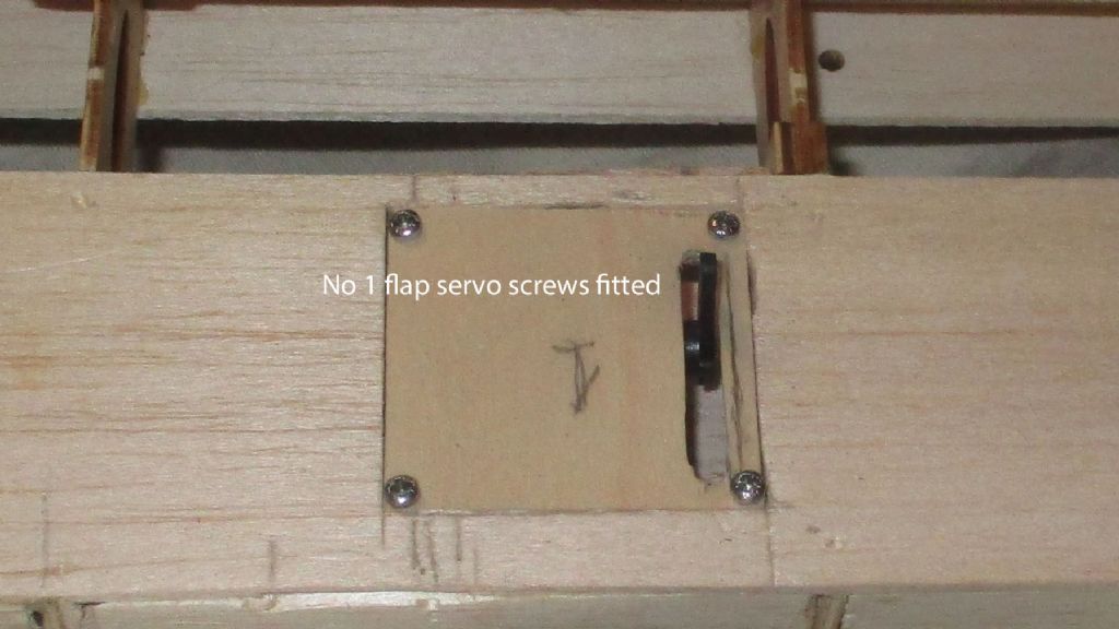

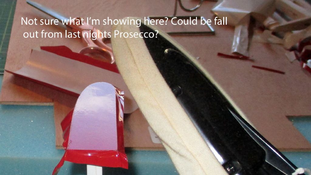

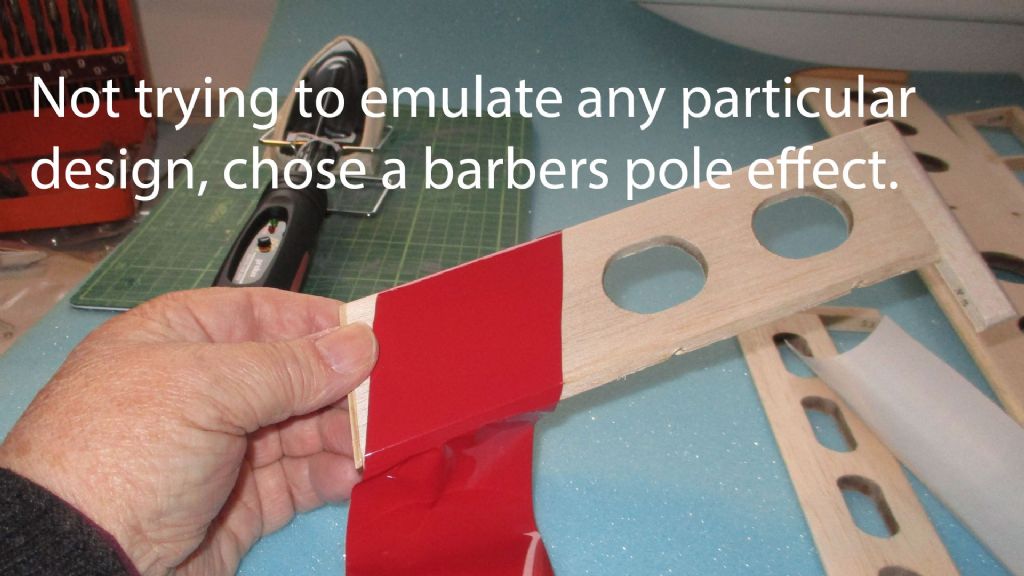

Today, I screwed the flap servo mounts in place, mounted & epoxied in the horns & made up the control rods. Then the second batch of screws arrived. Next, I cleared the bench & dug out the film iron I bought last year & the Oracover in white & red. I hadn't used covering film for ages, & Solartex around 11 years ago. So I set up the iron on my cutting mat on top of my foam pad, unpacked the red Oracover, cut off a strip to make some diagonal slashes on the rudder. I have loads of colour scheme pics, but they either involve curves or very bland, so I'm designing my own as I go. The iron seemed perfect at the setting it came at, low end of hot, so I tacked on the first strip making sure I didn't cross the pre cut holes in the rudder. I then added the second strip, turned the rudder over & copied it on the other side. Then I dug out the white, cut a strip of that, which I'd allowed an overlap, then realised I should have started with the white, in case the red showed through, luckily it didn't. However, I do need to allow a wider overlap as one piece shrunk to expose the wood, mental note for next time. All in all a fairly successful day. More tomorrow.
I was determined to continue as I left off yesterday as things went better than expected, however, an early post distracted me, the BMFA mag', my Access bill, which was in credit as I double paid off an amount,blush & the Outlaw plan from BB finally arrived so I had too peep. Hoping it would be a better print than the one from the USA, it was & it wasn't. The actual printing was very faint, will need to go to spec savers before building this, the good thing was it showed the full wing, not just 3/4 as the US version & there is also a set of instructions on how to build it. There was also an amusing sticker from him, (see pics). The ali disc I ordered from Ebay for the scroll saw bed also arrived, so it was mid morning before I plugged in the film iron. I patched the rudder where I had managed to open an overlap, then started on the elevators. I couldn't go any further without dry fitting the tailplane & fin. I marked where the film shouldn't be then proceeded to cover it. Unfortunately I induced a warp lengthwise, so had to resort to heavy means to try to cancel it out. Left it weighted down to cool off. So that's it for today.

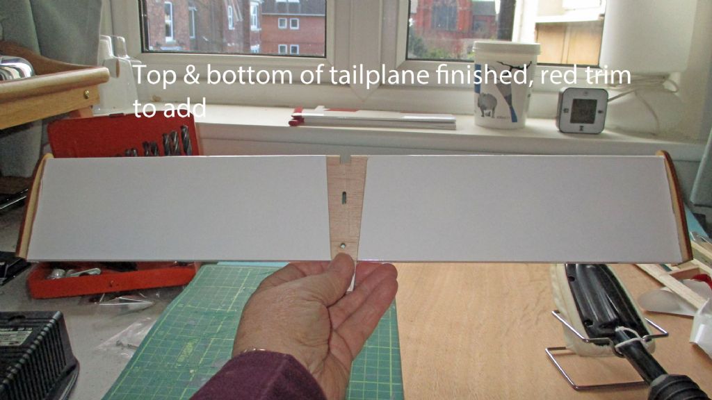

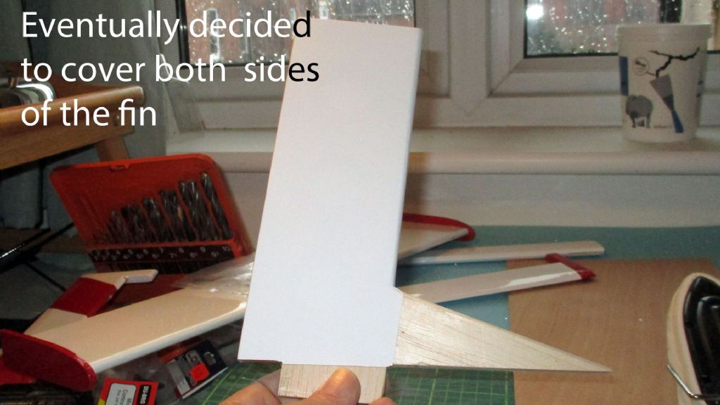

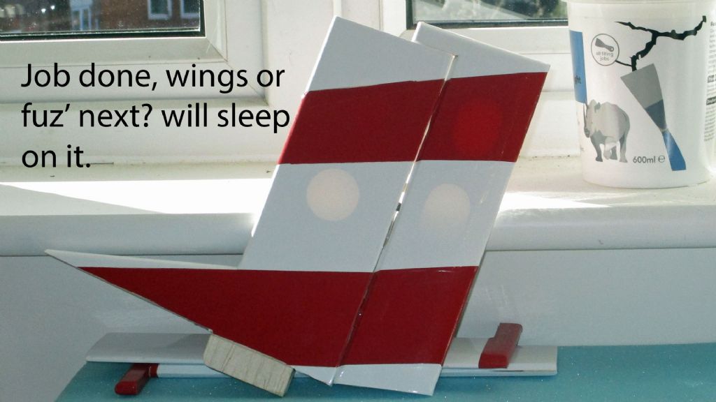

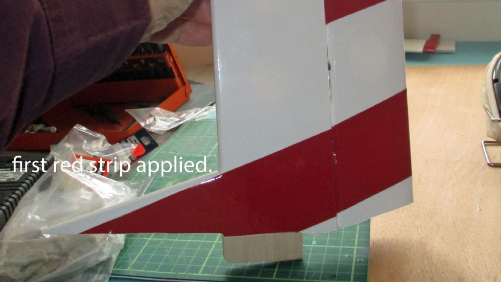

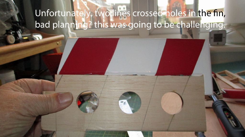

After a depressing Andrew Marr show, I switched on the iron, then finished the TP by covering the end plates, Oracover doesn't like ply, found it a struggle to get a good finish. Then I dry fitted the rudder to the fin, unfortunately, my trim lines clashed with a couple of holes in the fin.. Eventually, I decided it would be easier to cover the white with the red than try to overlap them. After covering the fin in white, I marked out the red trim & added the first piece, I don't think Oracover likes being covered with Oracover, had a hell of a job getting the bubbles out, eventually I used a pin & was reasonably happy. I suppose this is where pre made vinyl trims seem to have taken over? Used a few on the boats I've owned, hopefully they have improved since then?
Finally finished off trimming the tailplane elevators, rudder & fin, & unplugged the iron for the day.. As I stood up to move to the PC I snagged the iron cable & knocked over the wire iron stand. Silly me picked it up, it was blistering hot so I dropped it pretty quick. Result one finger marked but no blisters, double dose of Prosecco tonight.

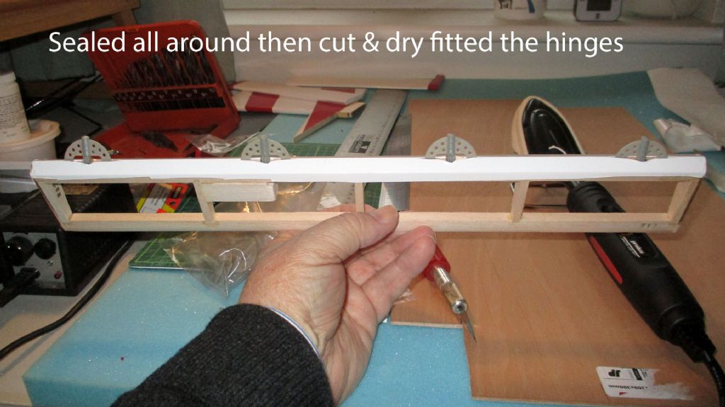

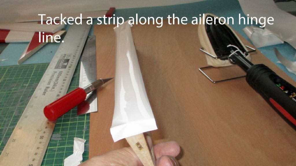

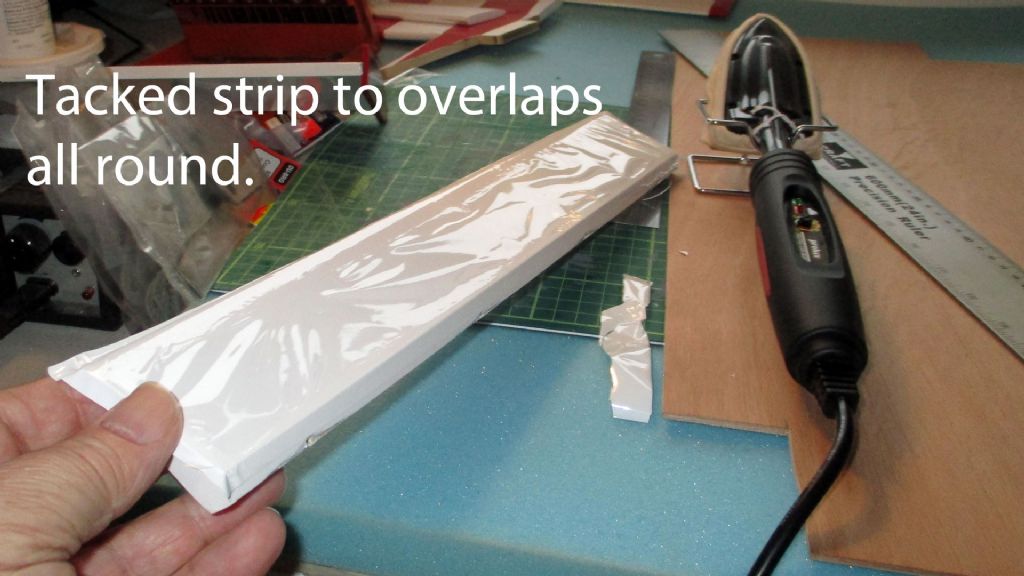

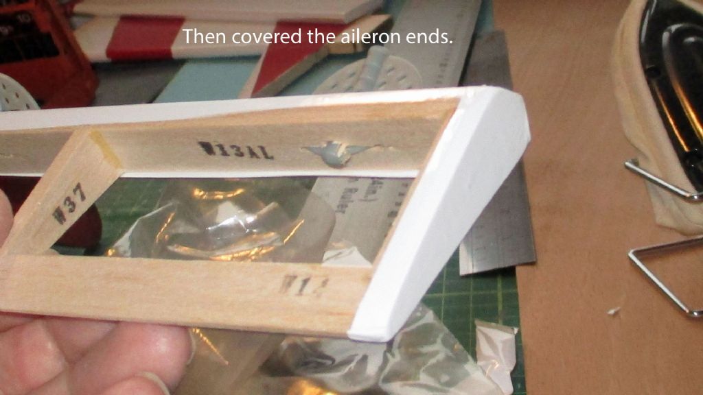

Plugged in the iron, collected the ailerons & cut a strip of white Orafilm to cover the leading edge of the first aileron. Tacked & sealed it in place, then trimmed it. Then did the same on the ends. Cut a strip to cover one side, tacked that all round sealing it to the bits already in place, then shrunk it tight, & trimmed off the excess & re-sealed the edges. Cut the covering over the hinge slots & dry fitted them. Then repeated the operation on the other aileron. That's that for today. Oh added an extra pic of the Solarfilm "Solite" purchase from yesterday.

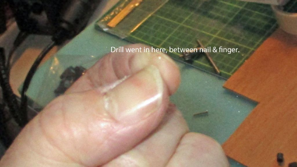

The day after my trip to Solarfilm, I set to trying to fit the kit supplied horns rods & links to the ailerons. This was the first real problem I've had with the kit, IMO they are rubbish & I ended up drilling into the gap between the nail & finger with a 1.5mm drill, owch!!! which could have put me off for life.
The problems with the components, the rods were like piano wire & coated with some substance which made then difficult to bend & cut. The quick links were practically impossible to thread onto the rods due to the coating & undersized holes compared to the rod thread. The horns had the same problems & I resorted to drilling them to fit. One however, broke as I was trying to thread it onto the wire peg, The 3 holes in the horns were practically impossible to align with the threaded bases, the holes again were too tight & had to be drilled to get the screws to tighten up, which is where I had the accident with the drill, which has taken 3 days to heal to allow me back to the building board.

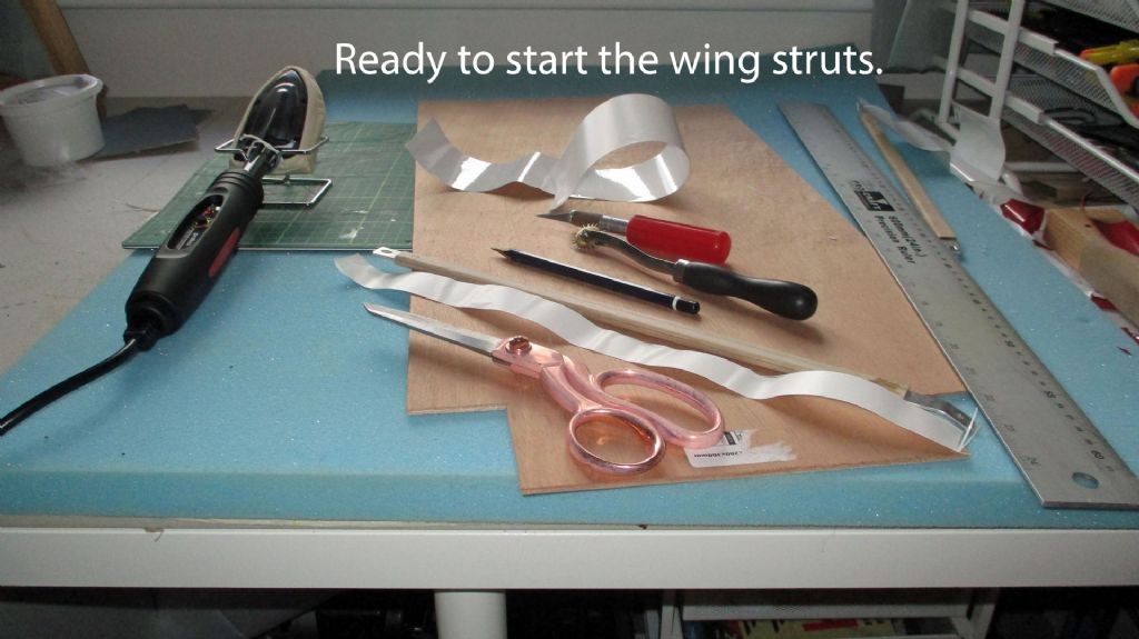

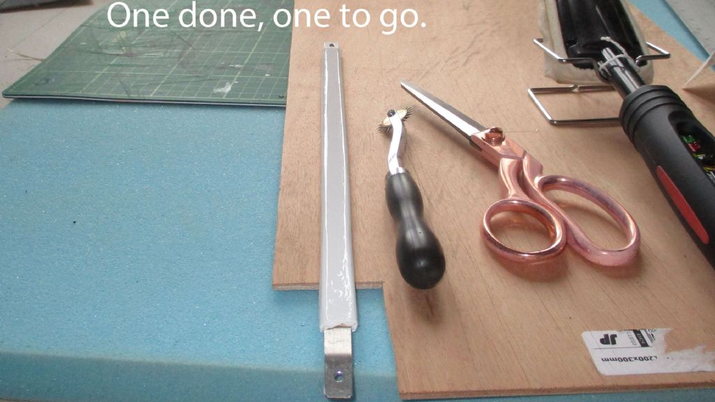

I had some useable strips of white Oratex left, so I decided to cover the wing struts. After clearing the bench, I assembled the parts & tools, plugged in the iron & cut the first strip. The wing struts are made from some sort of hardwood & after the problems I'd had with seams opening on the ailerons, I decided to turn down the heat on the iron a few degrees before starting.. I tacked a cut strip at each end of the strut, then sealed each side. Finally, smoothing down the centre, "seamed ok", (pun intended). I then repeated the process on the other side, but one of the overlaps shrunk too much & opened the seam. So I turned the iron down a tad more, & tackled the second strut, better this time. It appears the balsa absorbs the heat better than ply & hardwood, so in future, I'll use two separate settings. Finally, I tried the TF woodpecker substitute, found the wheel too loose & couldn't do a straight line. Luckily, the wheel was mounted with a nut & bolt & I was able to tighten it & get the pressure I wanted. One problem, the sock on the iron has developed a hole, possibly a sign I had it too hot. Will have to get my resident seamstress to knock up a couple more, that reminds me, she hasn't done the lipo straps yet

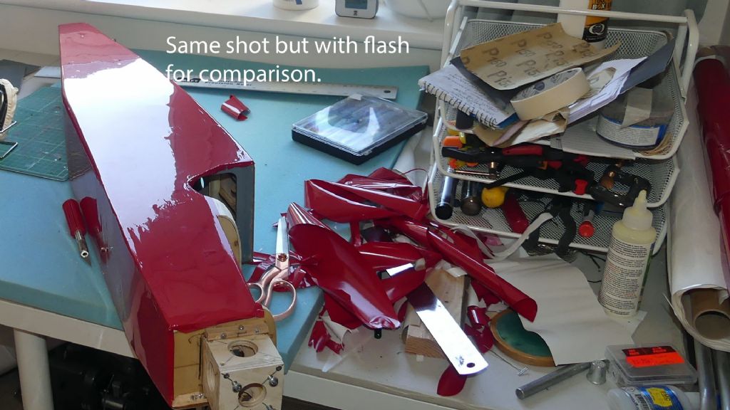

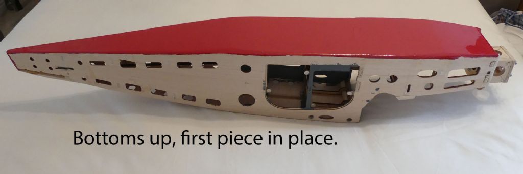

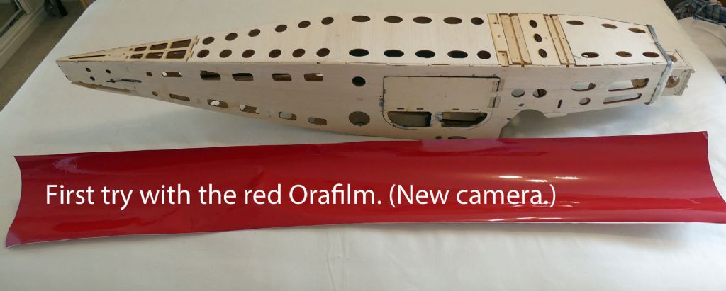

I decided to try the red Orafilm for a change & cut a piece to fit the bottom of the fuselage as per the manual. Removed the reinforcing metal band on the front bulkhead, fired up the iron with a new sock & tacked around the edges, sliced off the excess film with a scalpel blade, smoothed down the cut edge then shrunk between the edges. All in all a success with the iron at a lower setting, couple of ripples where ply & hardwood were covered, may need extra heat on those. Not sure this is as good as the Solarfilm I remember? More tomorrow.

Didn't really feel like adding more Orafilm but couldn't think of anything else so I've covered one of the sides, the one without to infamous door seemed easiest, so after cutting a length of the red Orafilm (still prefer Solarfilm) I tacked around the edges, then shrunk over the balsa side. Next the fiddly bit, the window openings. With a new scalpel blade, I sliced off the excess, leaving enough to cover the bare wood in the openings. Then made slits around the radius & gradually eased the film into place with the iron. The second window went better (sods law), but not the best I've done before. In retrospect, it may have looked better if I'd filmed the openings first. Running out of red film, may have to make a trip to Steve Webb's in Frodsham shortly.
