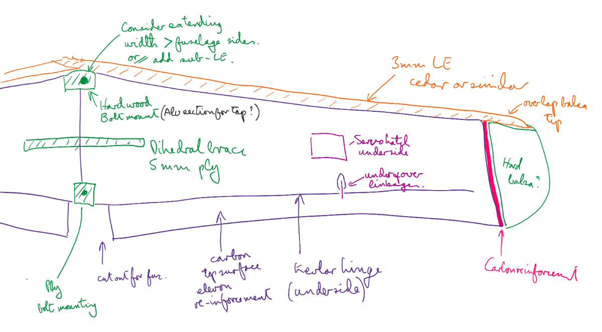

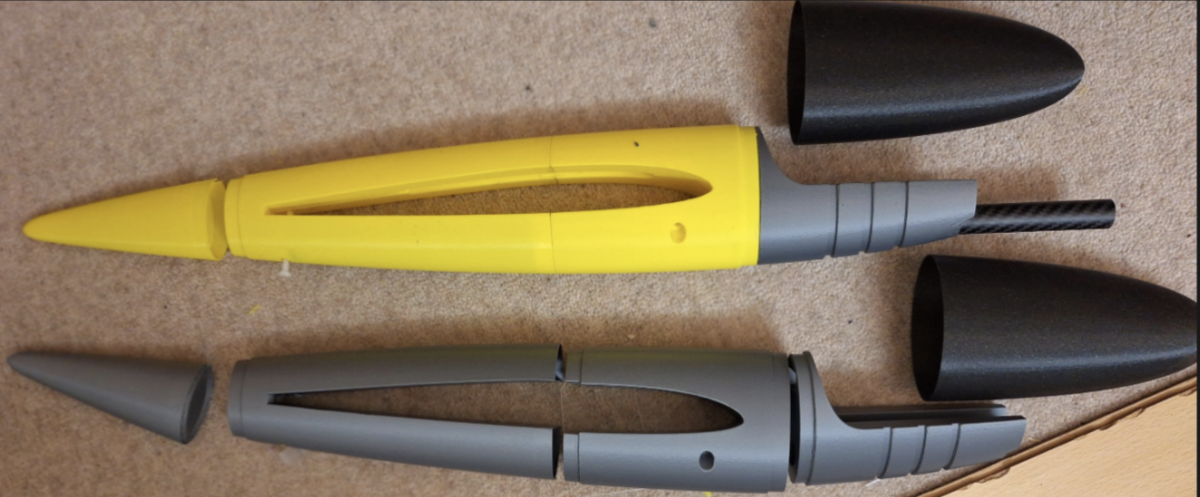

Mike Chantler Posted April 30 Author Share Posted April 30 Current thoughts are to print another PW51 fuselage without any mods, to add pretty conventional veneered foam wing: Not sure about best way to do front bolt fairing/mount thing or best materials for tips to make light but ding proof 🤔 Quote Link to comment Share on other sites More sharing options...
Mike Chantler Posted April 30 Author Share Posted April 30 A start: 1 Quote Link to comment Share on other sites More sharing options...

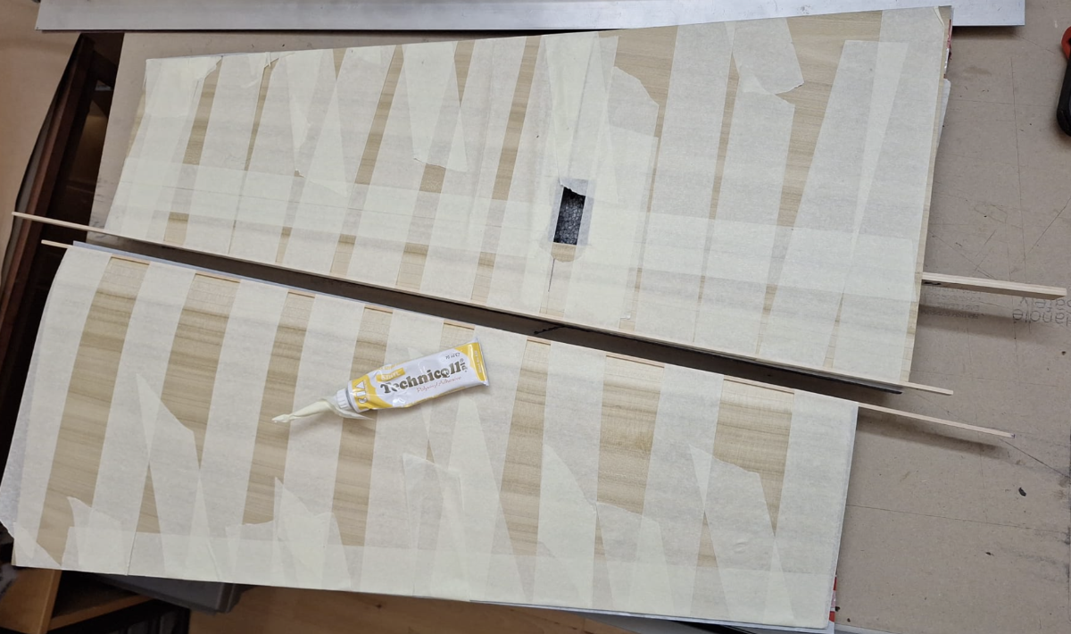

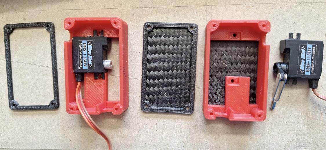

Mike Chantler Posted May 9 Author Share Posted May 9 (edited) Busy at work - so only had one day building. Bagging had worked ok but for some curl on the TE, and top skin slipping back a little at LE. Forgot carbon reinforcement over wing brace - grrr! Should be strong enough without 🙄 Started under/over servo housings. Miss-placed template for servo linkage channel slightly, as lined up on veneer rather than core - sand root square first next time to provide correct datum! Promised myself last time that I would 3D print servo boxes (making them both took a good afternoon+ I think). Designing took 1/2 day 🙂 Starting to square sand tips, LE and trimming extra 5mm off TE. Next time I should look at extending the TE as one veneer shifted and others did not glue as well at LEs as I would like. Getting there though 🙂 Edited May 9 by Mike Chantler 1 Quote Link to comment Share on other sites More sharing options...

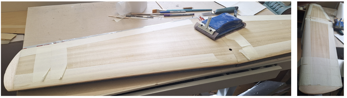

Mike Chantler Posted May 10 Author Share Posted May 10 (edited) TE cut with side dremel + 1" L section alu guide -- worked really well 🙂 LE and tips sanded square -- 1m 180 grit sanding bar worked well 🙂 (thought it might be too rough) 3mm cedar (or similar?) LEs glued with foam sort-of contact adhesive (could not remember what I usually use for this! - think I have tried white glue (does it stick?), 5min epoxy (pain to sand), gorilla glue (messy as expands everywhere 😞 and this contact stuff which being a contact adhesive will not fill voids) - so fingers crossed! Noticed that right wing veneer lifting slightly at LE, but taking the chance that the 3mm LE will keep it all together 🤞🤞 Well taped!! Now the hard part - resisting temptation of removing the tape to see if the glue has stuck yet 😳 We'll see if my run of luck continues 🤞🤞🤞 Sunday weather looks good for a fly of existing versions with the Pentlands club 😊 Edited May 10 by Mike Chantler Quote Link to comment Share on other sites More sharing options...

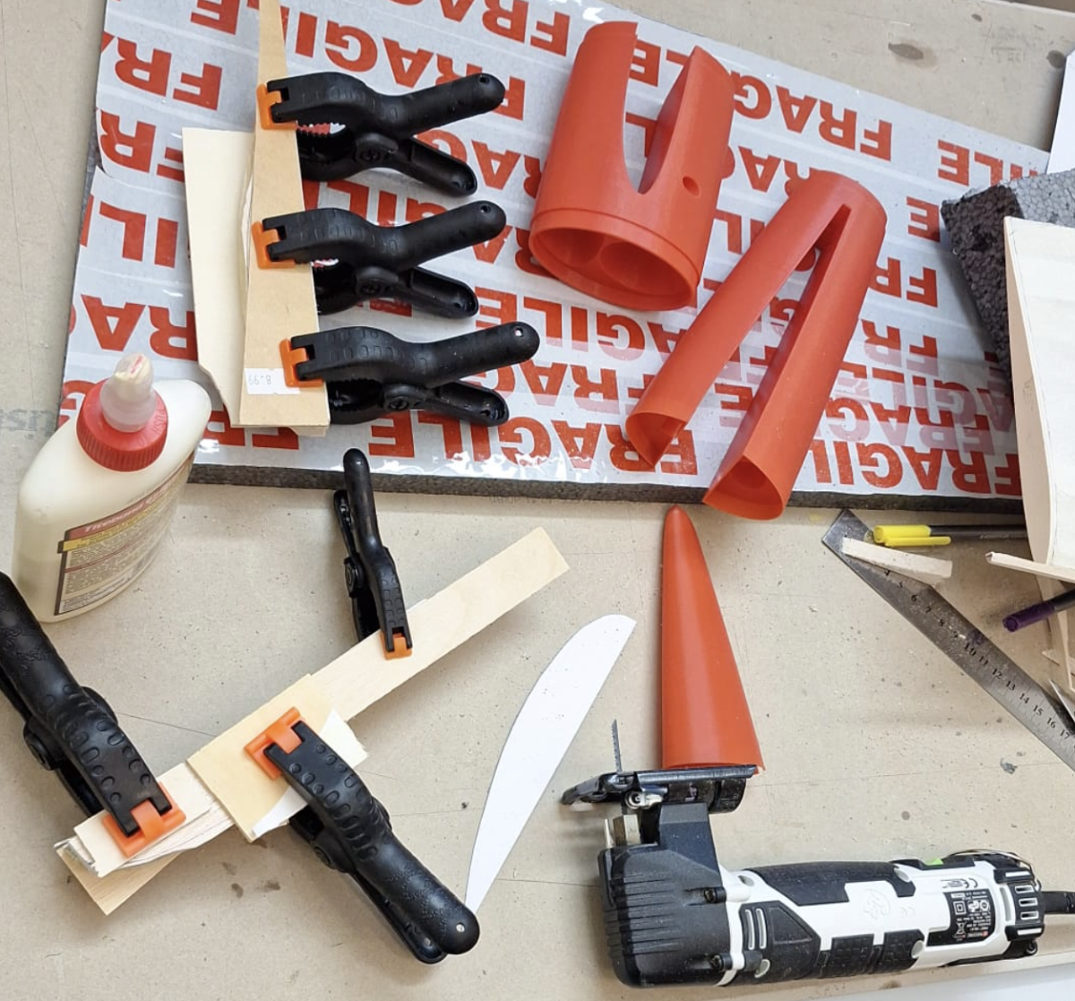

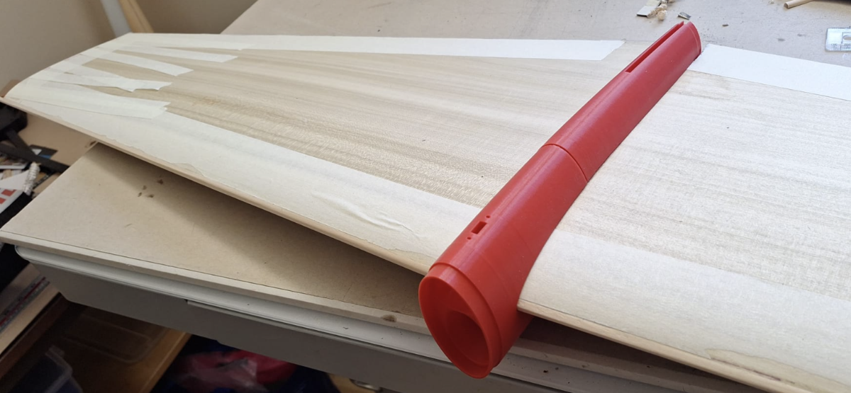

Mike Chantler Posted May 12 Author Share Posted May 12 (edited) Just started to print a couple of fuselage sections when I found i had already printed them : senior moment or what 🤒 Cut out recesses in rear of wings for fuselage and shaped LEs enough to test fit: Phew - looks fine 🙂 (setting the right kerf on the hotwire program can be a bit hit and miss) Added 3mm liteply sub-tips (with the contact adhesive again as this worked well on the LE strips). Hoping this will stop LE being staved in at the tips on fast landings, and protect the ends of the elevons a bit. Cut and laminated some balsa for the tips - first bit of balsa on the plane 😮 Last time I remember I should of added tip gussets - hmmm... Edited May 12 by Mike Chantler Quote Link to comment Share on other sites More sharing options...
Konrad Posted May 12 Share Posted May 12 Senior moment, not just you. I’ve been staring at that photo for a long time and seeing an EDF bifurcated inlet and exhaust. It took a second or third look and seeing the heading soaring to realize it is a fuselage with clearance for a wing. Quote Link to comment Share on other sites More sharing options...
Mike Chantler Posted May 13 Author Share Posted May 13 12 hours ago, Konrad said: I’ve been staring at that photo for a long time and seeing an EDF bifurcated inlet and exhaust. It took a second or third look and seeing the heading soaring to realize it is a fuselage with clearance for a wing. lol, that did make me laugh, and I see what you mean 😂 1 Quote Link to comment Share on other sites More sharing options...

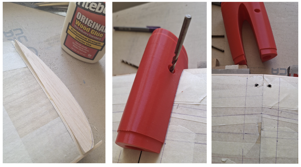

Mike Chantler Posted May 13 Author Share Posted May 13 Balsa tips on, resisted temptation to shape and make them dingable. Used fus to mark out positions of wing bolts: Seemed easy 🙂 hmmm... Quote Link to comment Share on other sites More sharing options...

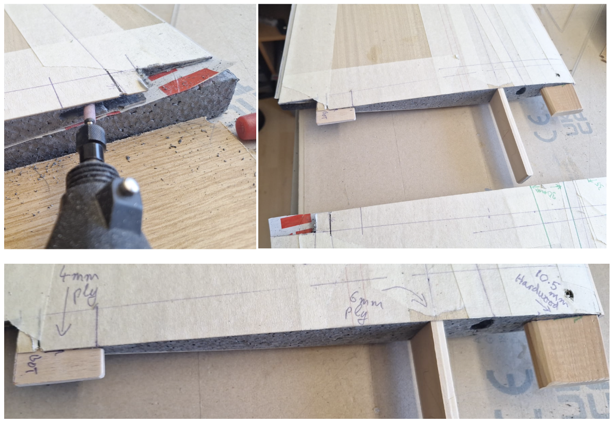

Mike Chantler Posted May 13 Author Share Posted May 13 Previously I've cut chunks out of the wing and then replaced with solid balsa, this time I'm trying biscuits 🙂 Quote Link to comment Share on other sites More sharing options...
Konrad Posted May 13 Share Posted May 13 Biscuits and a hot cup of tea?🙄 Sorry can't this too well, are the Biscuits glued only to the LE & TE only? I don't see any bonding to the wing skins. Is this by design? Quote Link to comment Share on other sites More sharing options...
Mike Chantler Posted May 13 Author Share Posted May 13 (edited) Aye, good point, got lazy so in places they fit into the foam at the moment. I'll clear a bit out more foam round the bolts and inject in some micro-ballon/epoxy mix in-between the biscuits and the lower skins where needed. The rear mount is pretty tight round the bolt location so won't need much if any epoxy. The front mount will definitely need some below the biscuit on one side (as I only plan to use one bolt at the front). We'll see if this is easier than making the biscuits the 'proper' shape 🙂 The wing is mid-mounted which means that the bolts are really only needed to stop the rear fus section moving away from front fus section, or sliding off to either side; the fus does not need to be squeezed against the wing as tends to happen in a high-wing (or low wing) glider. Also, the large carbon tube down the length of the underside of the fus, keeps all the components in line and the large overlap between front and rear wing sections means that they only need held together (hence the bolts at both ends). The other function of the front biscuit is to reinforce the LE and so it will be well epoxied to it. We'll see how it goes with the biscuits glued into one wing - then I'll think more about which bits need to be reinforced 😮 yup - being a bit lazy in my design thinking, but it'll be all right on the night 🤞 😮 🙂 And thanks for looking out for me and posting your comment 👍 Edited May 13 by Mike Chantler 1 Quote Link to comment Share on other sites More sharing options...

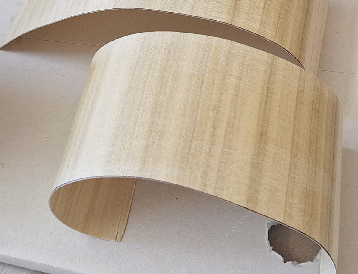

Mike Chantler Posted May 19 Author Share Posted May 19 (edited) Slow progress as have been faffing around a bit. Getting near to varnishing stage, so as the ailerons are pretty thin I've been looking at the effect of varnishes on veneer: Water-based varnish definitely makes it curl! 😮I may well use a solvent based varnish on the wings - but will need to watch I don't melt the foam! I also experimented with shaping hardwood to fit the void above and below the front biscuit, decided this was a bad idea as no matter how careful I tended to distort the unsupported skins a wee bit, so filled them with 20 min epoxy instead (potentially very messy even if you use using syringes etc.) The thing I really didn't like was that even the epoxy tended to distort the skins a little (1/2 mm or so) - not a big deal until you come to join the wings and you are using the edges of root sections as the datum 😞 I did have the beds but like to use the root sections to double check by running a finger across the seam. Nearly forgot the dihedral brace as I was putting it all together! We'll see if the wings each now have the same AOA on its maiden! Edited May 19 by Mike Chantler Quote Link to comment Share on other sites More sharing options...
Konrad Posted May 19 Share Posted May 19 Try to avoid solvent based varnishes as they will dissolve the core foam should the vapors contact the foam. When varnishing do try to use opposing force to counter the curling tendency. It is best to use “dry” coats at first. If a curve develops you can iron out the TE with an iron and some low level heat and counter force. 1 Quote Link to comment Share on other sites More sharing options...

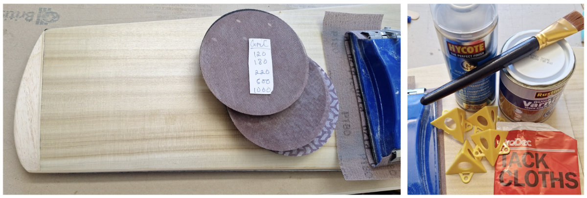

Mike Chantler Posted May 24 Author Share Posted May 24 Used 3 coats Hycote spray lacquer on aileron areas, predicably this stuff destroyed test foam when sprayed really close, but did not get though veneer when sprayed 2 passes x3 @ 8". However, it did not prevent brush-on water-based acrylic curling test piece(maybe didn't leave spray to dry long enough). Used the brush-on stuff for the rest of the wing as I got really bored/frustrated using the spray.🙄 For the first time I used gradually increasing grits as all the videos tell you too - made the process real quick - duh, should of been doing this years ago 🤔🙂 Quote Link to comment Share on other sites More sharing options...

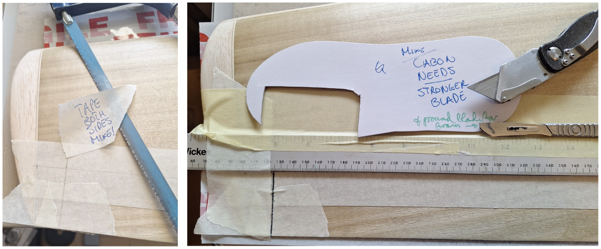

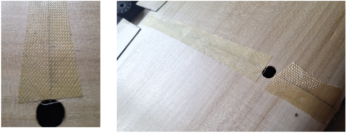

Mike Chantler Posted May 24 Author Share Posted May 24 Added 1oz aramid wing bandage as there is very little room for anything thicker, we'll see if this is strong enough when it flies! Started scary part: cutting/hinging the ailerons, followed Speedsterden vid on RCgroups ArtHobby thread this time. Liked the clearance the hacksaw gave at the ends but they needed tidying up a bit (tape does help stop the tear-out). Cutting from the non-hinge side first definitely made aligning hinge and top-cuts easier 🙂 And I really liked the idea of using a blade with the tip ground off to stop it damaging the thin aramid hinge. 🙂 Quote Link to comment Share on other sites More sharing options...

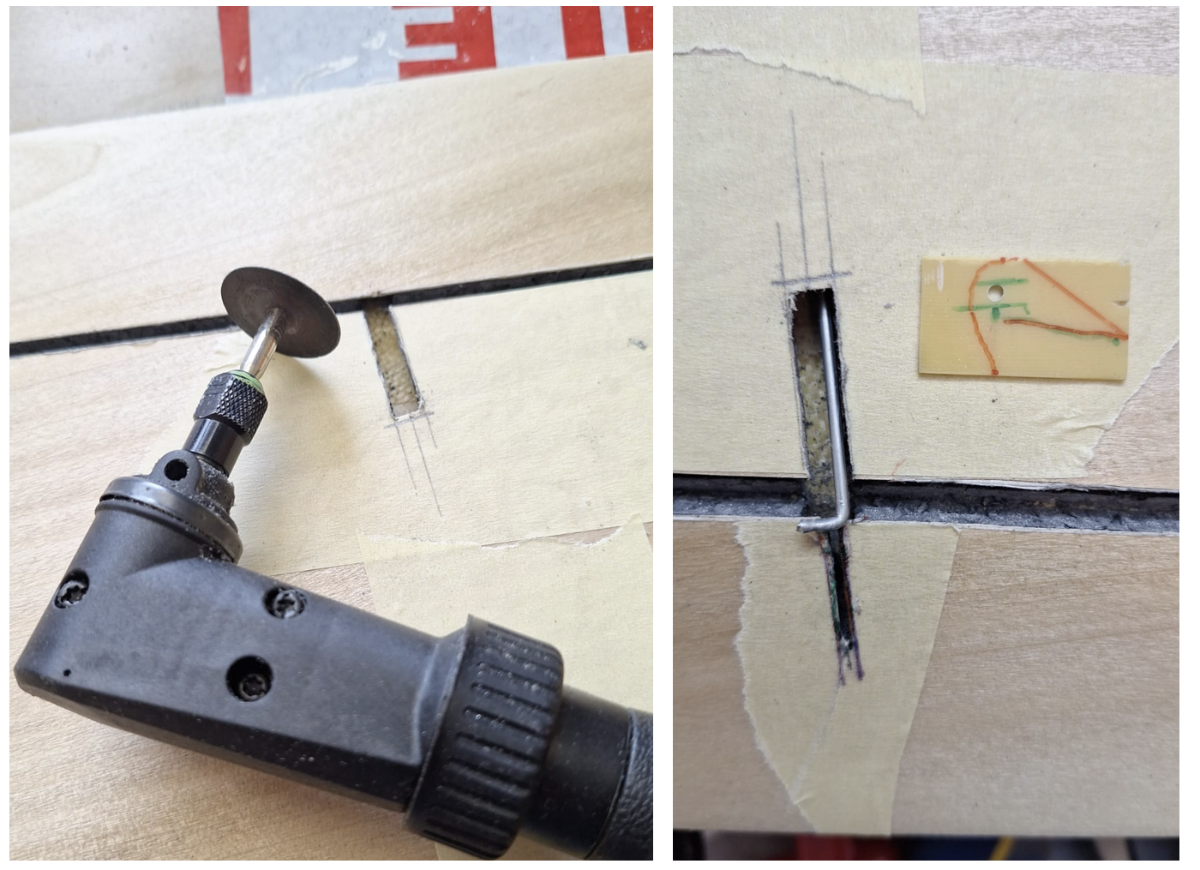

Mike Chantler Posted May 24 Author Share Posted May 24 (edited) Just started on under/over linkages Servo frames were too good a fit(!!) and would not release servos once they were in the wing so had to dremel a bit of clearance. Carbon tops and bottoms add 2 x 0.3 mm so had to adjust height. And put lead exit hole in wrong place initially! But mega-chuffed with the way they have worked out 🙂😁 Edited May 24 by Mike Chantler 2 Quote Link to comment Share on other sites More sharing options...
