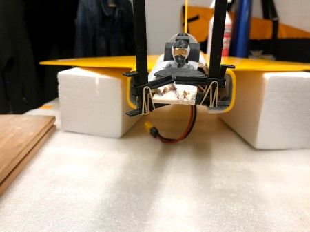

The repair is well underway. I double the damaged former(with holds the battery sidewise). And put a 2mm balsa plate under the area with the small fragments.
Some extra wood to align and top deck:
and glueing everything back together:
All holes were sparkled with light weight car body filler and sanded afterwards. I noticed front and back fuselage have little contact after one cuts the battery hatch. I reinforced the gluejoint in the lower triagle stringers with 1mm ply plates in the air intakes and a piece of 25gr grass over the bottom of the fuse to the air intakes.
Litt paintwork in the cockpit, glue the canopy back on and ready for covering again.

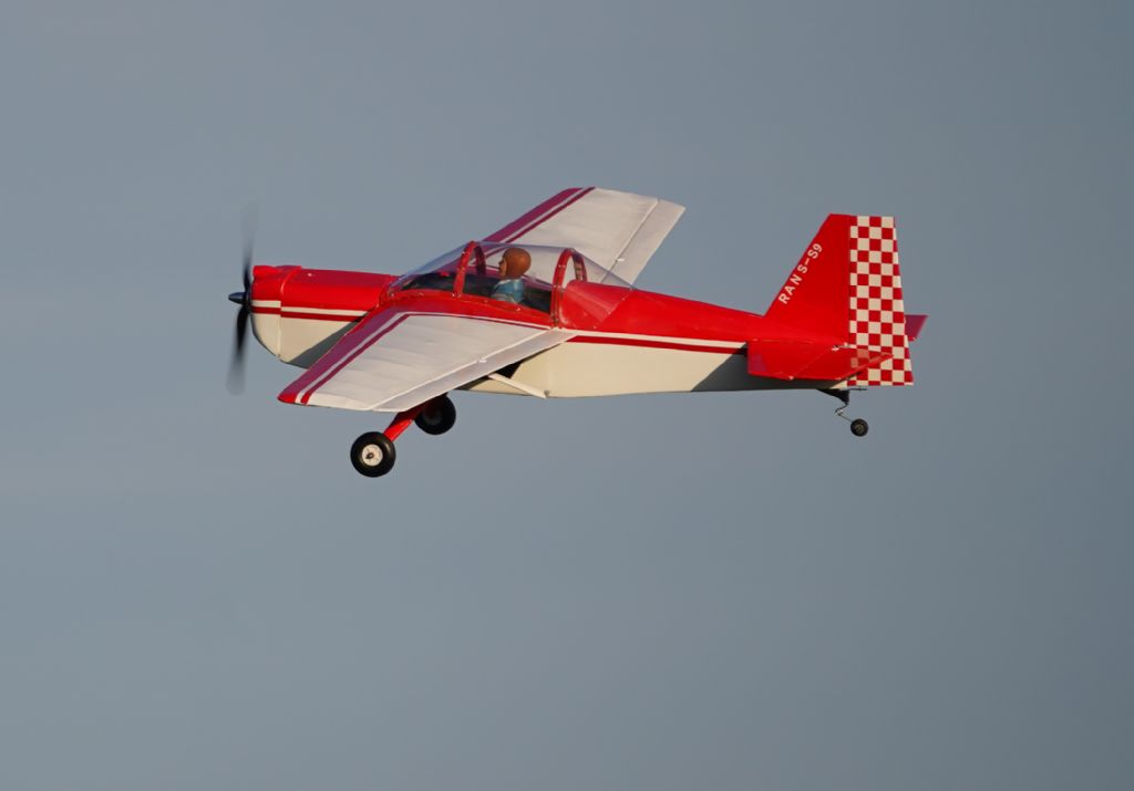

The maiden was eventful, to say the least. I had chosen a site where the launcher could stand about 4 m. over the terrain. At launch she sank a bit and then was away like a scalded cat. Very quickly very small.
I had to trim the elevator up a lot before she would fly straight and level. Elevator authority was lacking with the specified 6 mm up and down and 30% expo. Aileron was ok.
What I had not though well through about this site was the lack of a straight line in and out for landing and abort. When coming I saw the gnat going too far and when aborting I pulled a turn with too low speed. The inner wing dropped and touched the grass, with a cartwheel leaving the fuselage cracked before the wing.
