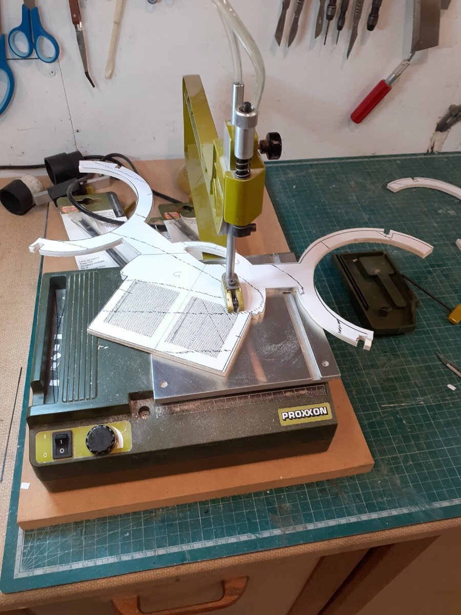

    I used PDF scaling software to increase the plan by 6% and sent the files off to be printed by an on line service using a plotter and rolling the plans, printed on technical grade paper. The plans have come out well, however, as a warning, if anyone is inspired by this, the original scanning of the plans was not perfect and there has been some distortion of the plans. For example, some of the formers are slightly lozenged, double check everything before cutting. In addition, with this type of build you need to be experienced in plan building, you are on your own in terms of fan installation, retract installation, power system location etc. There is no build article or notes to go with the plan. Whilst there is a company in the USA that still sells laser cut kits and fibreglass components, once I decided to go to larger than plan, I am on my own for all items like this.
    The fuselage sides and bottom are 1/4 sheet balsa with some ply doublers around the wing opening. Most of the formers are 1/4 balsa sheet apart from the engine nacelle formers which are 1/4" birch ply in the plan, but have been swapped to light ply for my EDF build. The fan bearers will remain as birch ply. The fuselage is starting to take shape. It really is a simple shape and lends itself to the simple design in the plans.
    Photo of a model from many years ago.
    Cutting out formers.

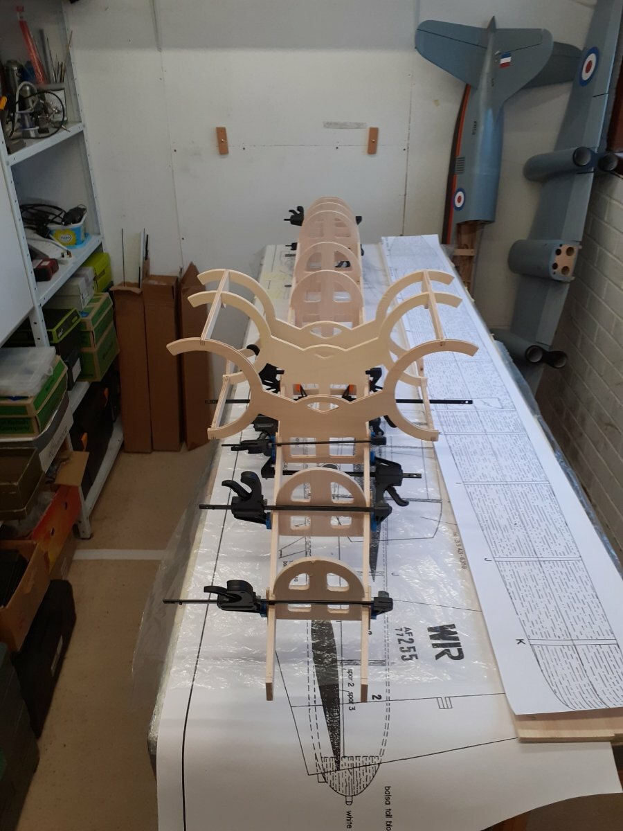

    First stage after gluing the sides and mid section formers. These formers all have the same width, making this stage easy. Glued in with PVA, tacked with cyano. Also shown is one reason for getting the winter modelling mojo back, the diesel heater, makes building at this time of year much more pleasant.

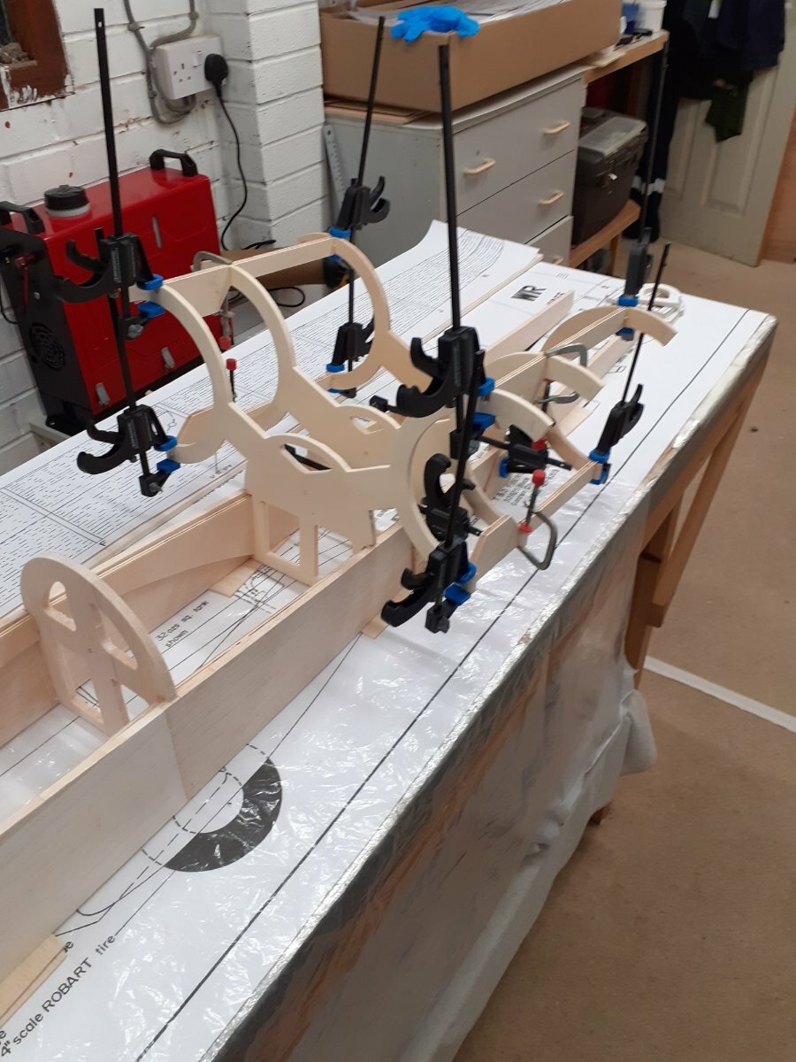

    Gluing the formers for the engine pods together as a single unit with the fan bearers. These are in position in the fuselage but not being glued in at this time. The fuselage starts to taper in here making lining the formers up a bit trickier. The ply doublers over the wing openings can be seen. The wing openings will be cut out later. These formers and fan bearers were glued with 30min epoxy. The front 2 formers whilst being light ply are better quality with 5 layers and are denser than the lightest light ply, the fan sits between these. The rear former only supports the exhaust tube and is light light ply with only 3 layers.

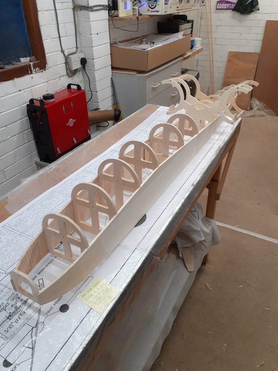

    Engine pod, rear and front formers being installed. The bottom sheeting template can be seen by the side of the fuselage on the bottom sheeting.
    Fuselage sides with formers installed ready for the bottom sheet.
