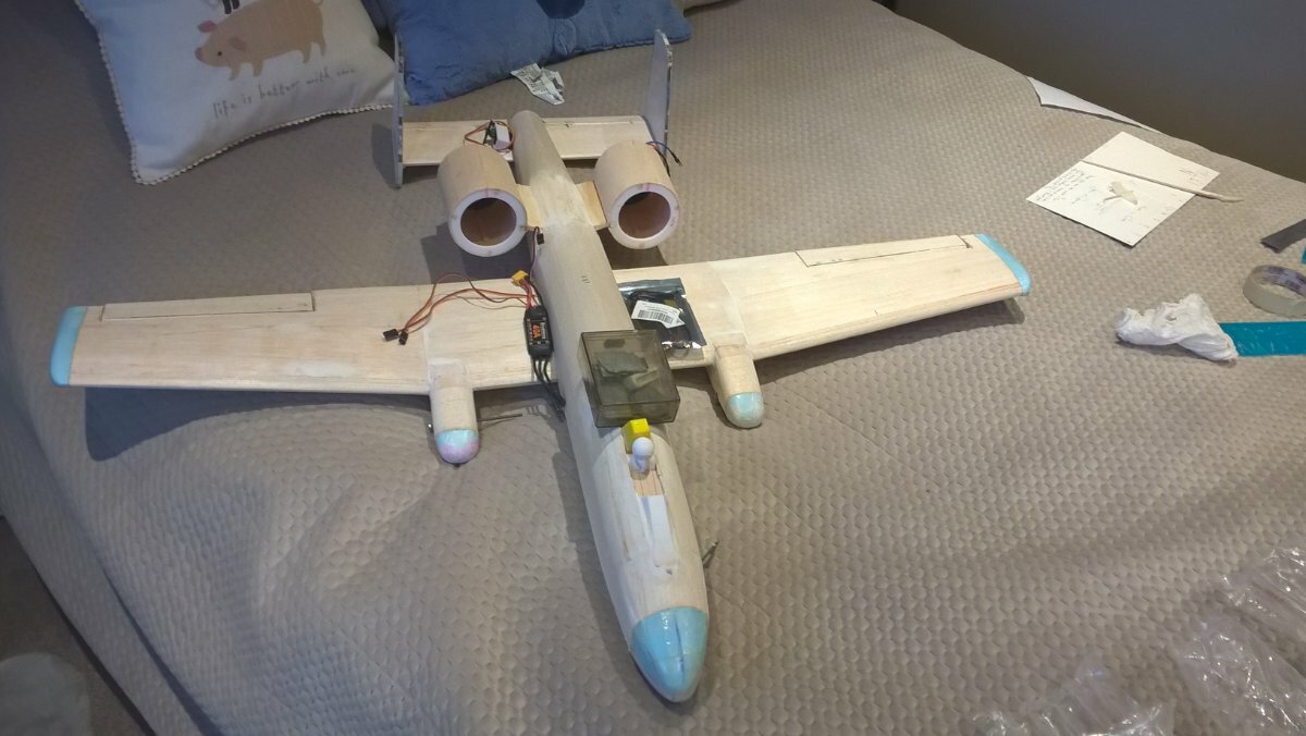

  1. I am coming towards the end of the build.
    I have a number of questions with respect to
    • where have others placed the elevator servo. I dislike bowden cable, the one I have is pants, the better ribbed type inner, are now ridiculously, wallet busting expensive. I have been considering close located, push rod location. Also wire trace push pull system, located very far forward, although the 90g servos output shaft run in the plastic case.
    • How have others attached the inlet and outlet formers. Are they stuck to the balsa middle bit, or attached with screws.
     I have now set the model up all the equipment and dummy Lipo to access the Cg movement with various layouts. It moves about 12mm.
