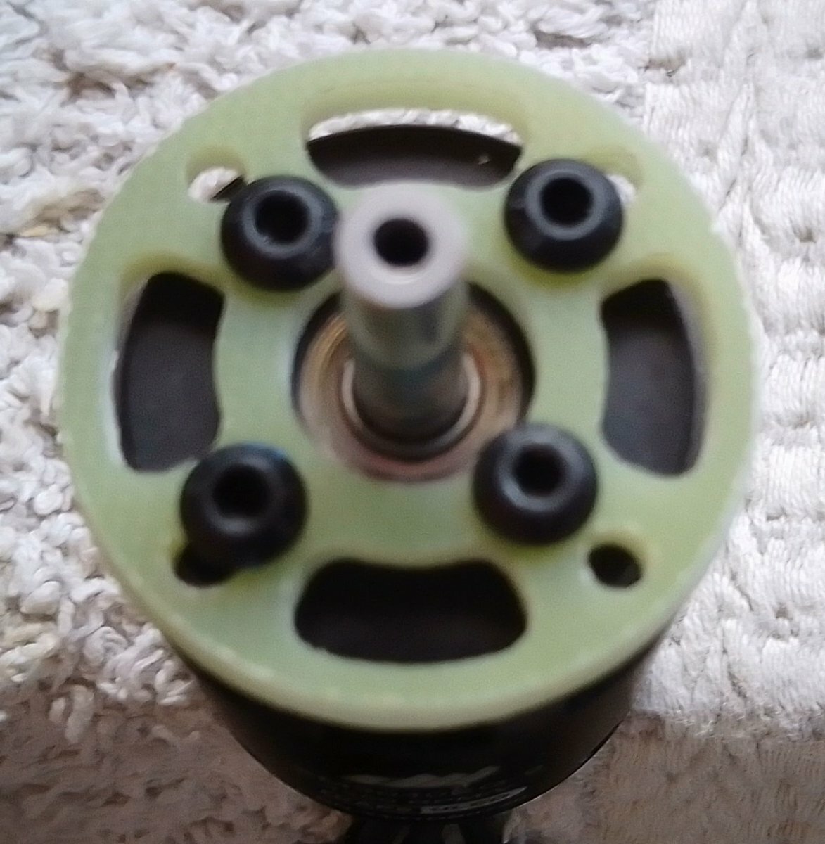

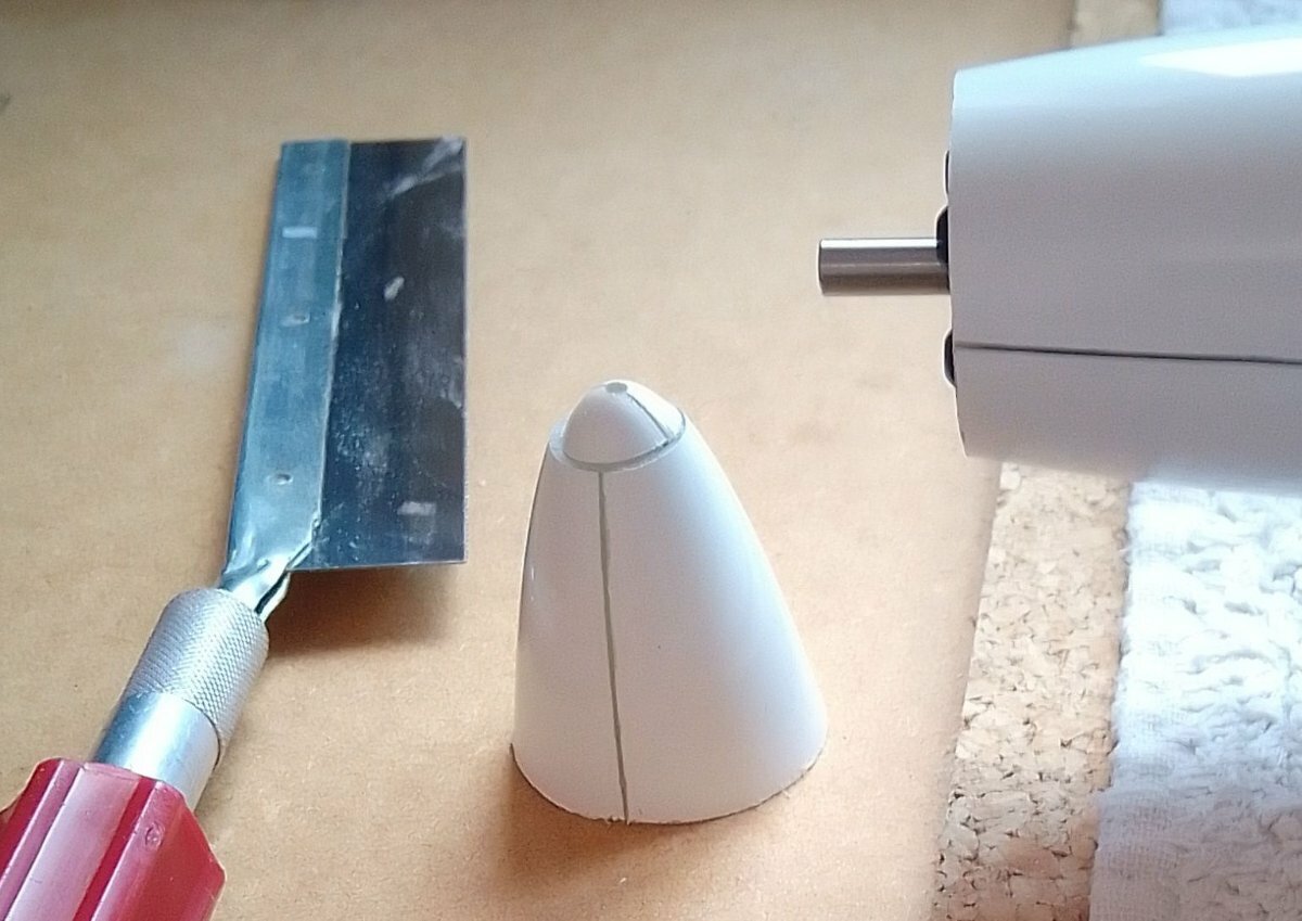

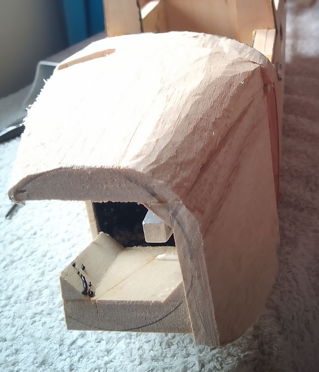

  6. The supplied motor mount was made to fit the motor and the fuse large for a 32 mm diameter spinner.
    The fuse large nose was cut off at the 32 millimeter diameter.
    The tale servos were fitted.
    This is the link for the rudder

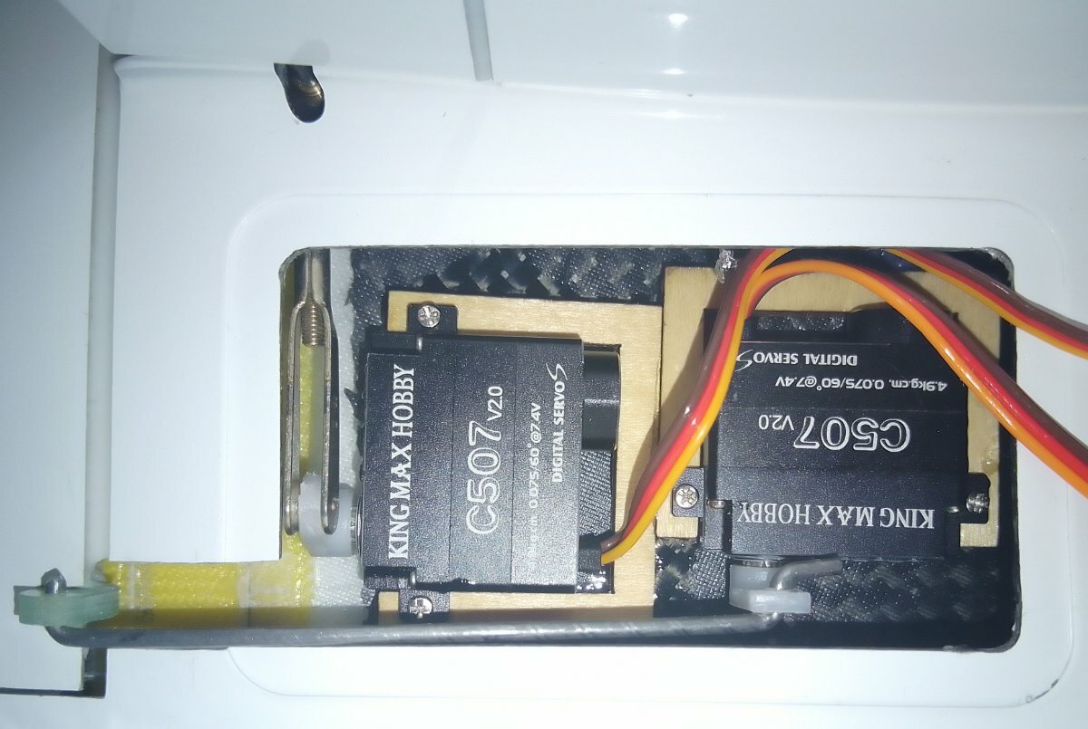

  11. Here are both sides of the ailerons waiting for glue.
    As you can see at the bottom the use of the clevis has caused me to budge up the installation. I think there has to be a better way.

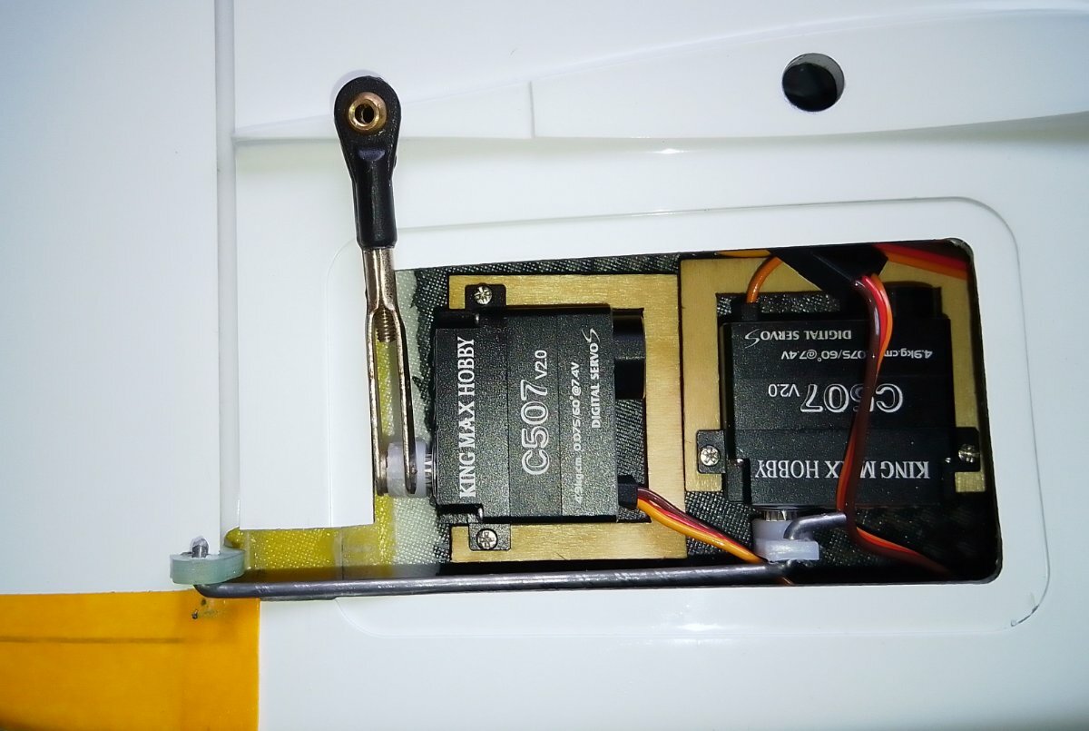

  12. Thanks for all the suggestions guys and after a lot of thought I went with the clevis solution.
    And here they are waiting to be glued in.
    Next the ailerons.
