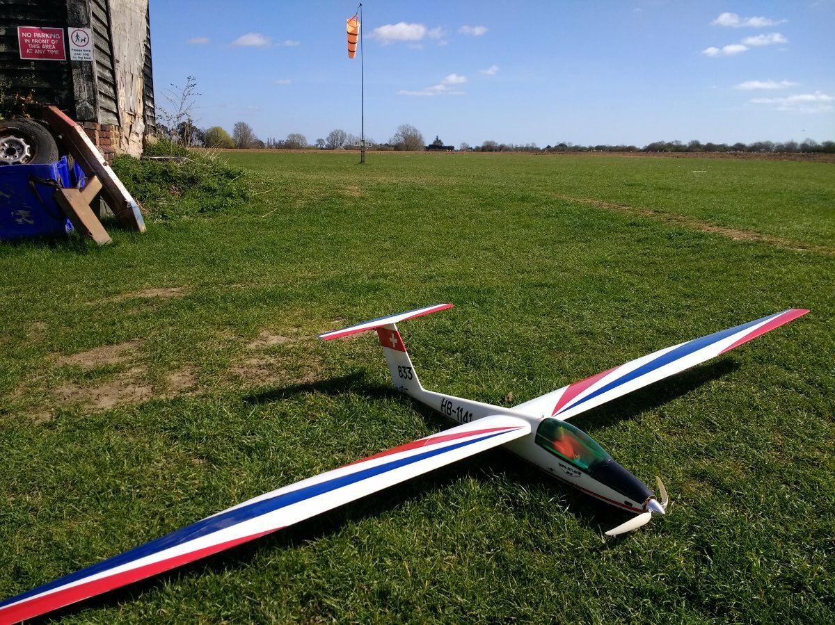

14 hours ago, Mark Hewett said:
I cut the access hole and found both holes in the bellcrank were oversize for the clevis pin, and wire rod Z bend. The clevis I was able to move to a different bellcrank hole. For the Z bend slop I used a drop of medium cyano, this certainly works but I'm not sure how long it will last, so I've left the access hole hatch just tacked in place with hot glue.
Well done for identifying the mechanical side of the elevator issue.  Don't worry too much about the cyano, once set it is usually rock-solid and likely to last.
  • Like 1
I flew it again today, wind about 10-15 mph. It handles much better with the slop taken out of the elevator linkage and the turbulator tape seems to have mellowed the tip stalling. I found that under full power you can get in a nose high low speed situation, that full down elevator cannot correct. When the stall does then occur it is a spectacular departure from controlled flight. You can avoid the situation by lowering the nose with elevator while you still have flying speed, and/or reducing power and re-applying when the nose attitude has been lowered. I suppose this is because the T tail doesn't have prop wash over it increasing elevator effectiveness, and/or may be blanked in turbulent air of off the stalling wing. I hope spin recovery will be possible - I haven't tried yet.
Running the motor at minimum power does seem to add a little drag and so make the landing approach more manageable - thanks Pat for that useful tip!
