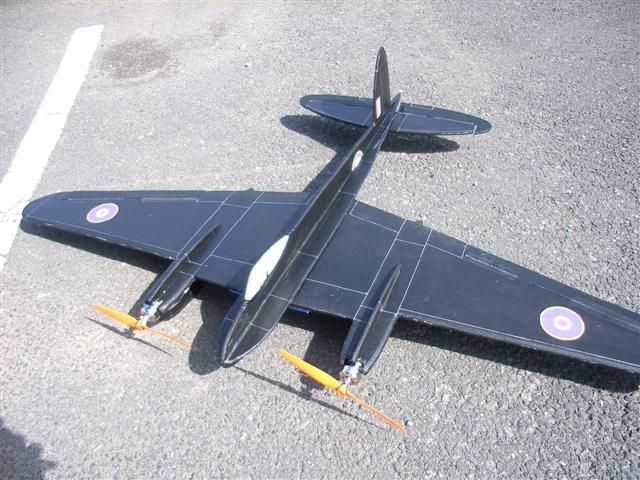

eflightray Posted June 28, 2015 Share Posted June 28, 2015 My recommendation would be build it as a profile at that size, or be very careful with the weight if going the whole hog. 50" span, 20.25oz flying, 6mm Depron. Quote Link to comment Share on other sites More sharing options...
