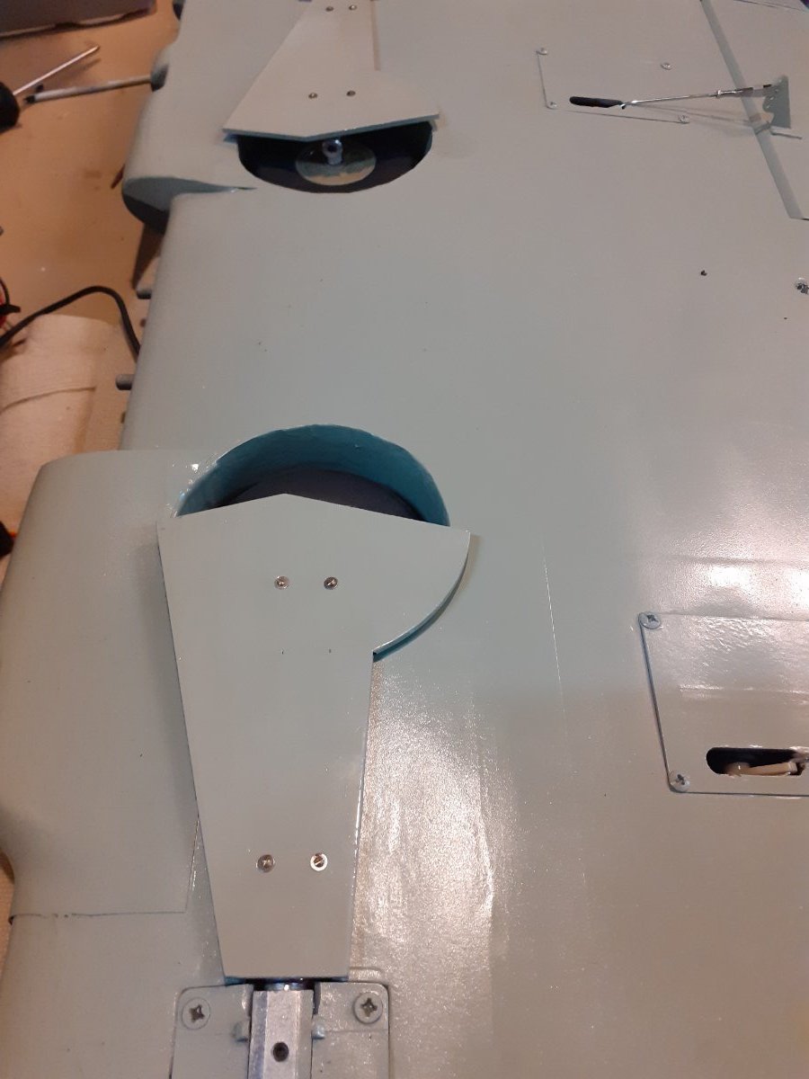

I recently picked up an unstarted Seagull Sea Fury kit from a modeller who was giving up. Obviously these kits have been out of production for quite a while, and the kit is not quite up to current standards. For example, it has no electric provision (mounts / battery space etc) and no removable top hatch.  Danny F and others have some time back detailed modifications for electric and demonstrated that the model can be redone in other paint schemes.
So far I have fitted some HK electric retracts and oleos in place of the supplied mechanical units with wire legs. I have increased the wheel wells to take proper size wheels (3.5"). And repainted the model to disguise the  pretty boring and unconvincing film finish it came with. I have decided on a Dutch naval scheme and am modelling 860which was part of the 1959 Dutch Naval aerobatic team that used Sea Furies. I feel its a much nicer scheme than the Canadian racing colours supplied as standard. Eagled eyed will see I have the cowl on upside down  098 instead of 860!
