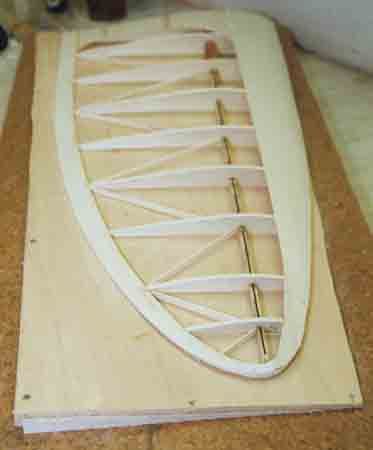

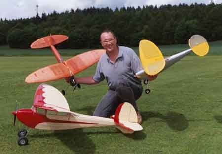

Tim Hooper Posted February 11, 2016 Share Posted February 11, 2016 Ten years ago I found myself the owner of three Scorpions - two standard size and one super. The two little ones have found new homes, but I still have the Super Scorp. I built it from the BB plan, and made a few mods as I went along; the wing splits in two for storage, the tail surfaces are removable, the trailing edges and outlines of the tail are laminated from thin strips of balsa. I built the wing halves on a twisted piece sheet of ply to build-in 6mm or so of washout. The covering is cream Litespan, with Solarfilm trim. It's powered by a brushed Astro 15G motor (which cost £150 at the time!), and was fed by 12 sub-C cells. The pack weighed 1 1/2lb alone. These days I've switched to a 3S li-po, so saving nearly 1lb off the AUW. It's lovely to fly, although it does have it's quirks; take offs are a mad zig-zag along the strip, the elevator trim needs constant adjustment depending on the throttle setting. tim Quote Link to comment Share on other sites More sharing options...
