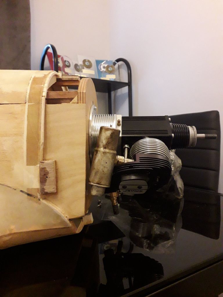

had a forage after work and found the cowling. still need to find my plans though.
Anyway this shows the 240 installed...an no, you cant have a black one :P
I dont have a 300 spare but the heads are 10mm taller than on the 240 so im sure you can imagine how it would look.
I intend to remove the firewall below the mount and do something clever with the tank bay. I have to get my cooling duct in there somewhere as well. Im sure i will come up with something.
