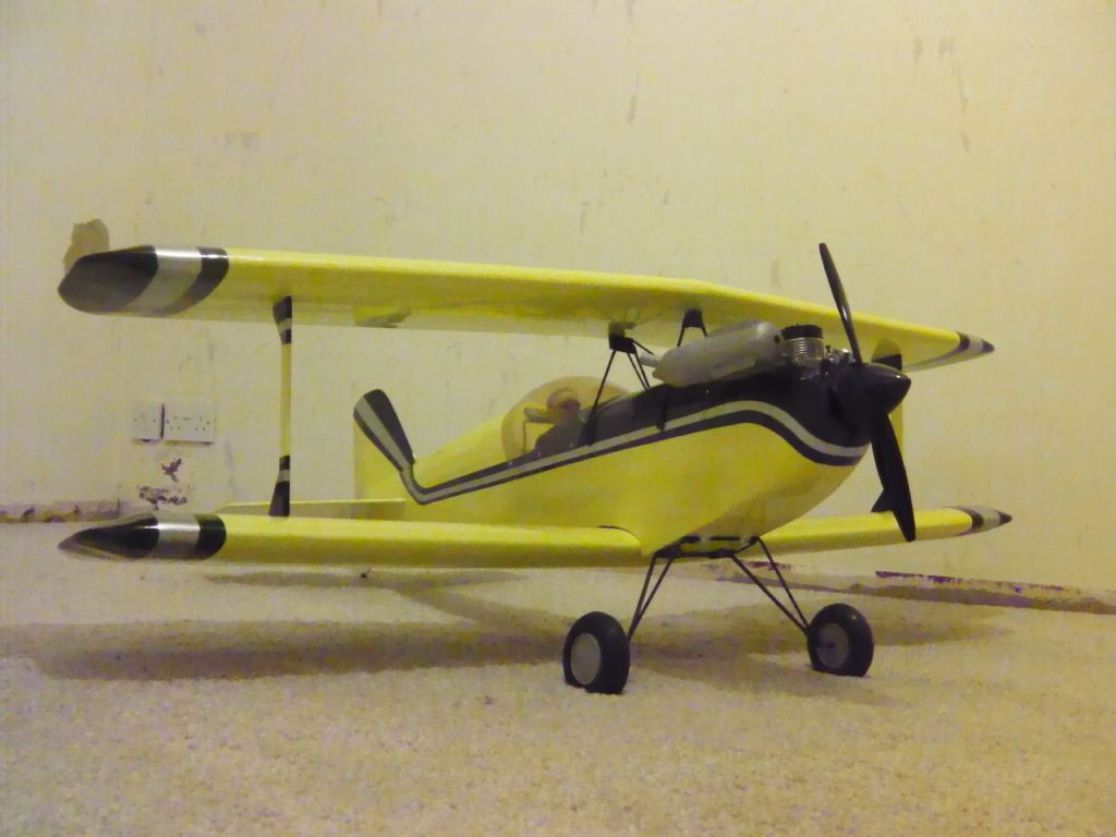

The original versions used engines like Merco 61 etc which are probably more equivalent to a modern 60 four stroke than a 90. Even a 60 four stroke seems maximum for a 48 inch span bipe!
All of my Aeromasters have been the double swept wing 52" versions. Early ones were powered by an HP 61 and an OS 61 FSR, both were ample power. Later ones have had OS 91 Four strokes and ASP four stroke, again ample power.
Jeff that's very nice, I like the black and silver flowing around the nose and tail.
Where did the canopy come from?

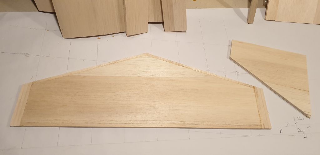

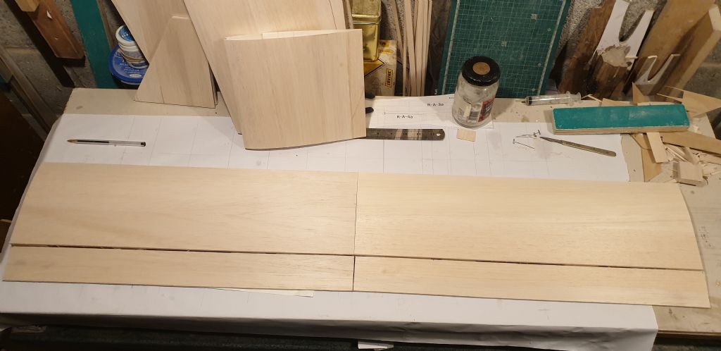

After I did that, in the interest of the infamous first line of any old magazine build article "step 1, cut a kit of parts", I decided that it might be an idea to make the wing skins. But before I did that I wanted to know (don't ask, I under-ordered on the 1/16 balsa sheets) what I would need for sheeting the tailplane. So, a brief diversion from the wing... I usually make the bigger fixed bits of the tail end from a sheeted framework of 1/8 x 1/4 (or thereabouts, quite often it is just a case of raiding the scrap box and seeing what I can use):

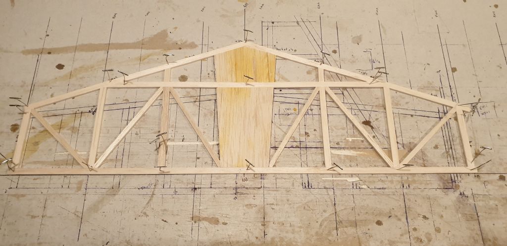

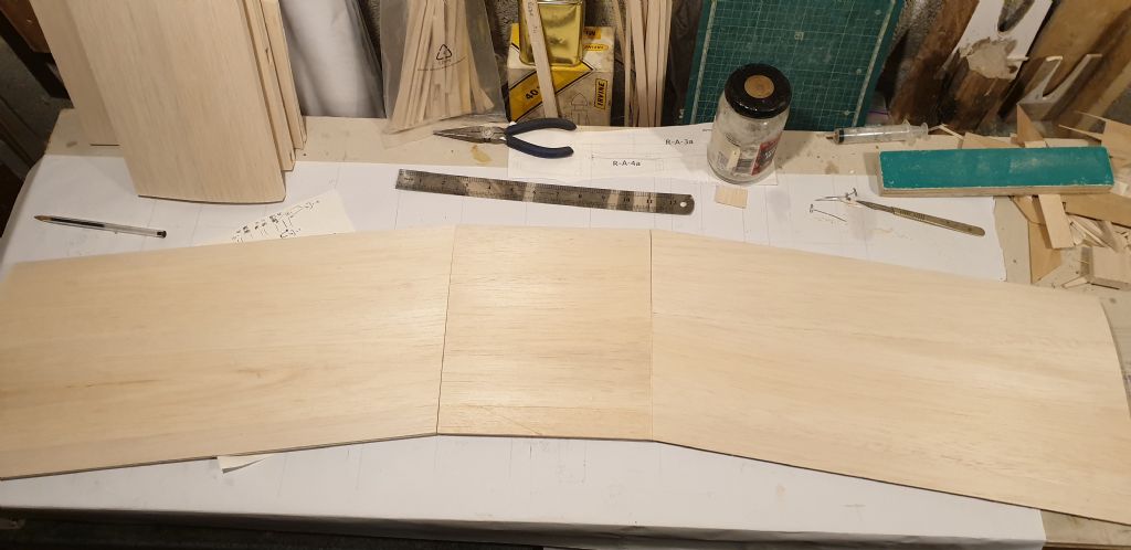

That is near 20" span. Two full sheets of 1/16 required to cover the framework. No photo, but the inside of the fin looks roughly the same. The "spar" is put where the join in sheeting is, so I can get a nice flat join when it comes time for finish sanding. The fin used up the leftovers from the tailplane.

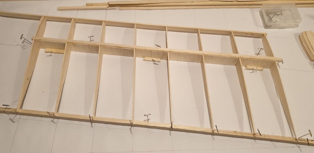

After the tailplane, it turns out I have just (and I do mean just) about enough sheet, so I need to be careful with the wings. No photos of me joining wing skins - been done before lots of times.

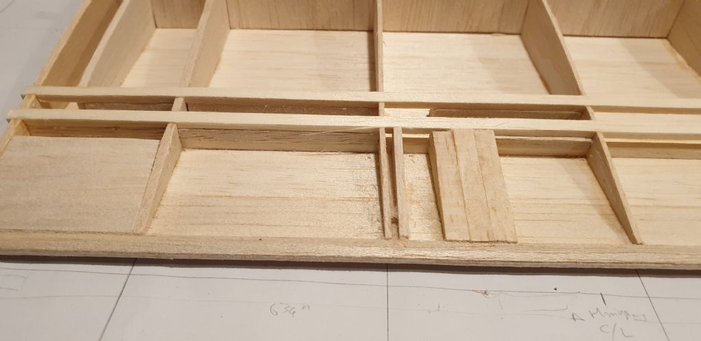

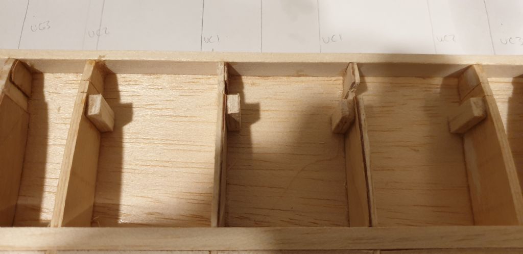

There is nothing particularly unusual about the wings. I am building all the panels separately and will join with glass later. The lower wing has a pair of, er, pairs, of rear spars (a quad of spars?) to demarcate the ailerons, which I am building as part of the main structure and cutting free later:
it also needs some webs, some blocks laid in between the rear spars for the hinges, some riblets for the aileron edges, and some other bits that didn't make it into the photo below - some block at the centre to stop wing bolts from crushing the sheeting, more blocks inside the rear spars to hold the torque rod bearings, ...
I found all those bits quite fiddly. It probably took about as long to get those sorted nicely, as it would have done to plane and sand a pair of solid block strip ailerons. Hey ho. I think at heart I just like carving away at big lumps of soft stuff until an airplane appears.

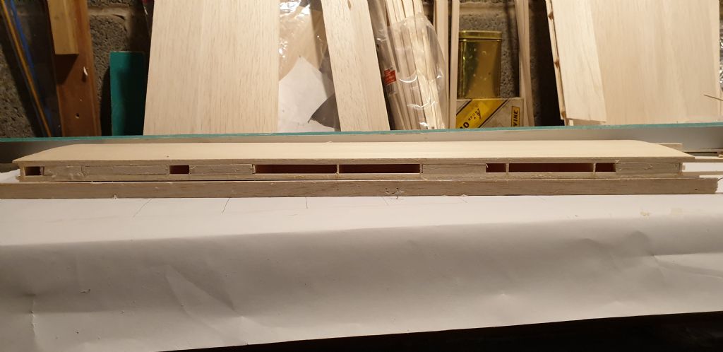

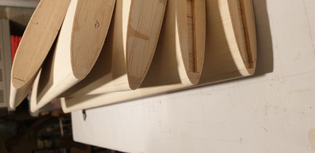

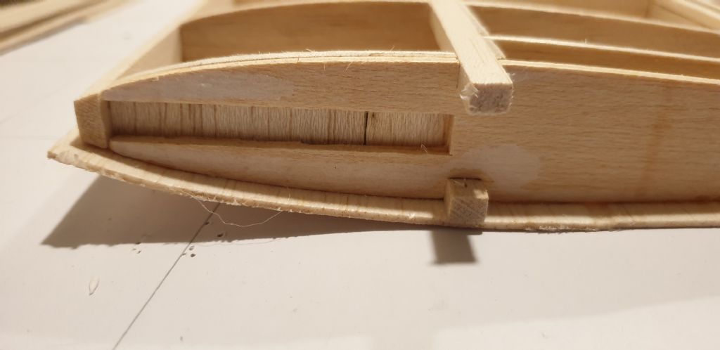

Ok. Last photo for this update. At this point one of the wing skins is on. It should explain why the root rib is so chunky near the LE:
The root rib is liteply, slotted to accept the wing dowel.
The middle section of the rib well end up being dremelled away when I mount the central aileron servo. I already stuck in a half rib to form the sides of the servo well.
Since that photo, I have completed the sheeting on the lower wing panels and while the sheeting remains oversized and unfinished (and thus instantly far more resistant to workshop dings), have put them aside to move on to the upper wing.

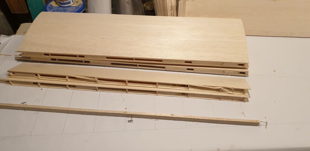

I went to examine the lower wings with a view to sanding the sheeting back in line with LE and end ribs (etc), and discovered a major horror on the lower wing - whilst one panel is good, I have managed to build a warp into the other panel. The TE itself is straight. But, I believe the ribs flexed around the aileron spar location and caused the panel to take on a set as I pressed the sheeting on. This means the TE is straight, but, the remainder of the panel is not. At one end the bend in the rib is quite apparent, around the aileron spar point. All in all a bit of a setback as I cannot adjust at this stage, the sheeting is on and that is that. I might need to strip back the sheeting and try again - if I can get the sheet off cleanly - although the problem there is that I definitely do not have enough replacement material. I am tempted to buy more wood and simply start over for the lower wing and do it right this time.
I guess if I had jigged the wing up with the jig strip at the aileron spar location, where the rib is nice and strong, that would not have happened. Live and learn.
Tonight's session was a minor victory.
I had a basket full of wood on the slec webpage and was ready to order, when the thought occurred i had nothing to lose, what is the worst that can happen if i try and sort the warp out?
I started by having a good look at where the warp was and figured that if i could fix a corrective twist into the two bays at each end i would be back to very nearly warp free.
Before going any further i cut the aileron free.
I then managed to slice the join between sheeting and the end rib easily enough. The next rib in was tricky to reach and the join with the sheeting was cut blind. I think i probably cut through the rib itself anyway it was enough to allow me to flex the panel and stick the sheeting back down with thin cyano.
Don't know if it comes out in the picture but the panel is now within 1/32 of flat at the aileron hinge location.

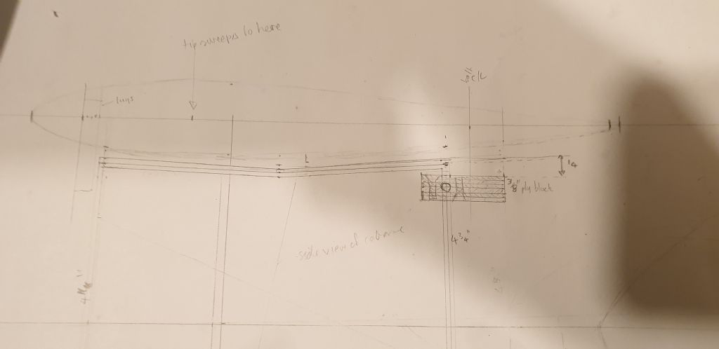

Next big job on the wings will be getting the centre 9" section together. This is the bit where the cabane attachment is done. The plan is to use 1/4 ply lugs, two of them, at the leading edge, the two sides of the cabanes will have forward facing prongs to engage with the lugs, and at the rear, a cabane crossmember will have a hardwood block clamped to it, to receive a standard 6mm wing bolt:
To make all that work, when making the centre section, I have to make sure I have a nice accurate slot in the ribs for the lugs, and I have to put some soft block filler around the area where the bolt will go.

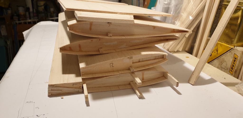

Starting to make quite a stack of parts now:

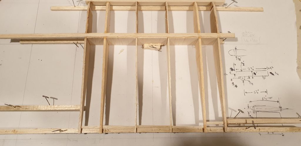

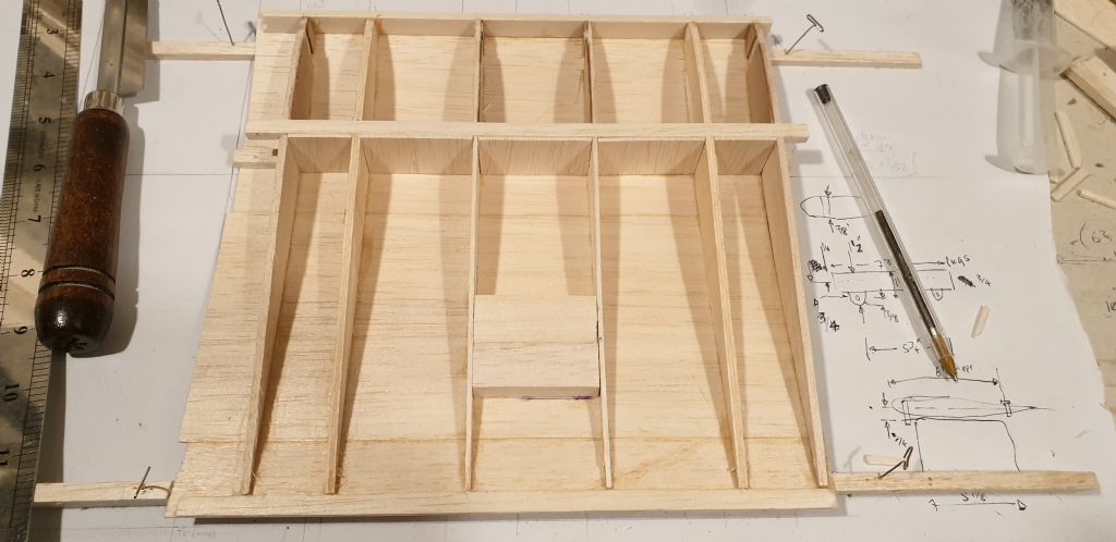

Most of the time has been put into the upper centre section. After part-cutting the slots for the ply lugs, I got the basic structure - ribs, spars, webs and LE - assembled:
Very basic jigging as usual, just a strip near TE and near LE. Providing one doesn't bend the ribs (!) - see previous tribulations with lower wing - this is plenty to keep everything nicely straight and warp free.
The balsa ribs in this section have some ply doublers to help strengthen things up. The two ribs that sit over the cabanes have been made from liteply so won't need doublers. It is probably a little overkill but won't add much weight to the whole build. My thinking is that all the ribs can help out near the LE by distributing the loads from the lugs into the wing skins and the liteply rib will sit on the cabanes and help spread any loads from those at the bottom skin to the top wing skin. I usually try not to be shy with material use around the key areas where wings attach to fuselage. Strength at stress points doesn't go amiss.
On this section I stuck in some scraps of 1/16 near the TE of the ribs, in order to keep them correctly spaced:
With these in place I only had to hold the outside two ribs in place whilst doing the sheeting.
Once I had the lower sheeting in place, I added a lump of soft balsa to prevent the wing bolt from crushing the wing:
and then put some pieces of 1/4 sq (ish) next to the slots, to provide some extra gluing area for the ply lugs:
I also poked the knife through the lower sheeting to mark out where the slot will be made.
With that done I was ready to button up the panel with the upper surface sheeting.
