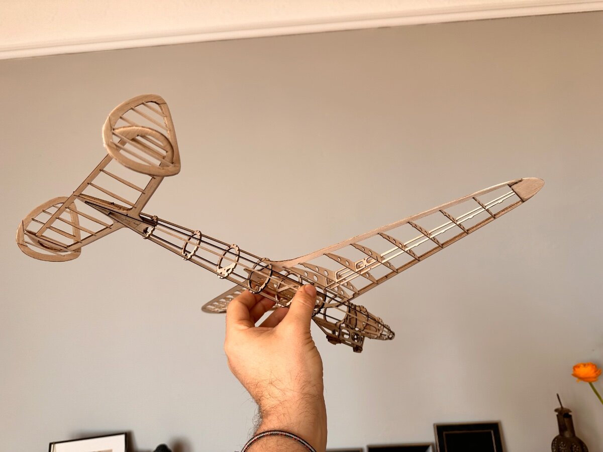

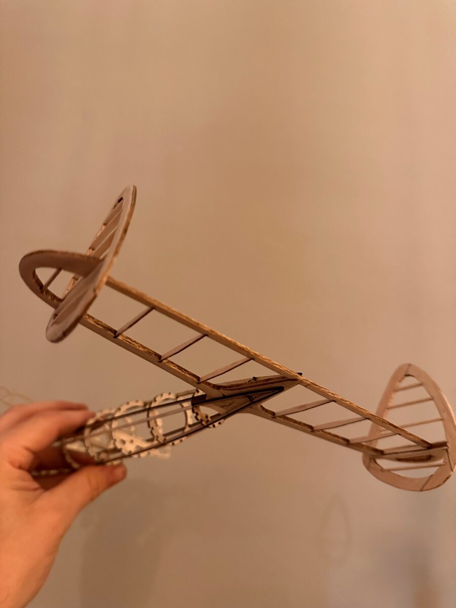

shepeiro Posted March 16 Author Share Posted March 16 Some progress lots of little jobs (everything’s little on this) wings and tail feathers are all sanded and ready for putting together. Need to decide on colours befor I can progress with that though!!! Quote Link to comment Share on other sites More sharing options...

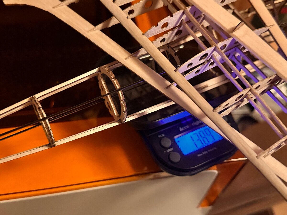

shepeiro Posted March 16 Author Share Posted March 16 Currently sitting at just under 14g Quote Link to comment Share on other sites More sharing options...

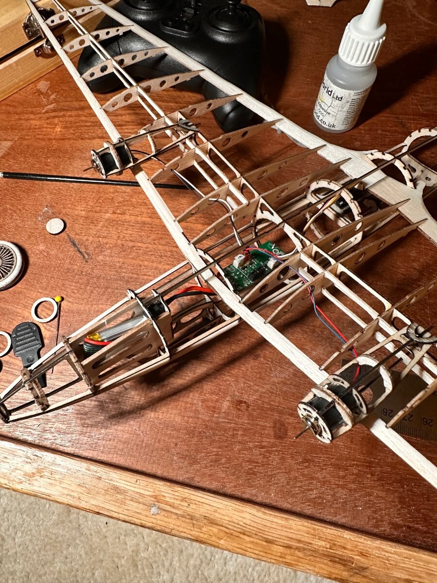

shepeiro Posted March 16 Author Share Posted March 16 Mixed news tonight though. Build coming on, paused putting stuff together to do a dry run of the electronics positioning. Going to have to do some alterations to the internals but nothing too bad. Worse was when I plugged in servo to see which direction it needed to be in to make sure it’s not inverted (won’t be able to flip with tx) the servo arm just kept spinning! Will need to rectify this before I can go much further unfortunately. Anyone have any idea! Never had this happen before Quote Link to comment Share on other sites More sharing options...

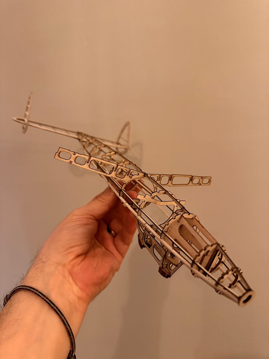

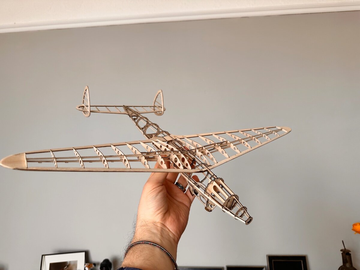

shepeiro Posted March 16 Author Share Posted March 16 Otherwise starting to look ship shape 1 Quote Link to comment Share on other sites More sharing options...
shepeiro Posted March 16 Author Share Posted March 16 Took servo apart all the gearing is fine including the pentonemeter whotsit seems to be connected in properly. What I did notice was that it occasionally worked as it should when the connecting wire was in certain positions so think there is some connection issue though I couldnt see anything further. slightly worried that it may be a signal issue from the rx but this is only system I have that uses the five wires servos so can’t test that theory. have bought new servo off Ali express so will find out in 9-16 days 😞 Quote Link to comment Share on other sites More sharing options...

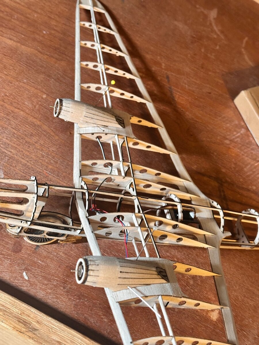

shepeiro Posted March 18 Author Share Posted March 18 Wings are on, nacelles frames on wing all looking fairly true so far. 2 Quote Link to comment Share on other sites More sharing options...

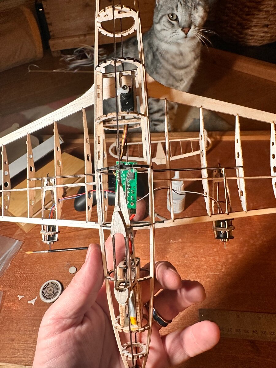

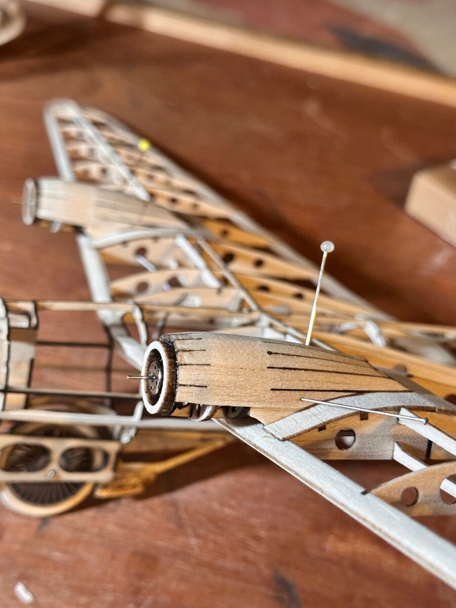

shepeiro Posted March 18 Author Share Posted March 18 Dry run with electronics. servo started working. No idea why not sure if I trust it. all the wires stretch just about but think I want to raise the rx up off the floor a little so it’s bang on the cg 3 Quote Link to comment Share on other sites More sharing options...

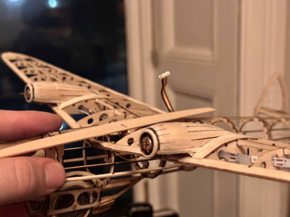

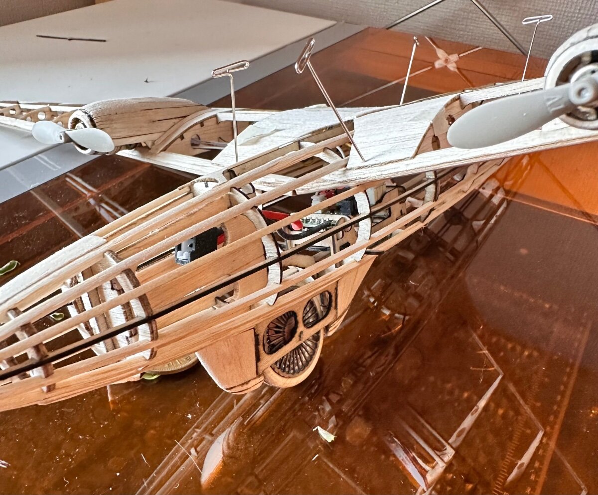

shepeiro Posted March 23 Author Share Posted March 23 Motor nacelles “planked” 1 Quote Link to comment Share on other sites More sharing options...
Simon Chaddock Posted March 23 Share Posted March 23 Well done! Those nacelles are very neat. I like the temporary(?) struts to hold the planking in place. 1 Quote Link to comment Share on other sites More sharing options...
shepeiro Posted March 24 Author Share Posted March 24 Cheated as I unfolded the form in 3d and laser cut the result. meant I could wrap the center section around the formers and then just tack the ends with Ca so was quite quick. May try this technique on larger models. temporary struts are my wife’s dress pins (need to get my own) Quote Link to comment Share on other sites More sharing options...
shepeiro Posted March 24 Author Share Posted March 24 Filleted, sanded and shaped might need a small amount of filler 3 Quote Link to comment Share on other sites More sharing options...

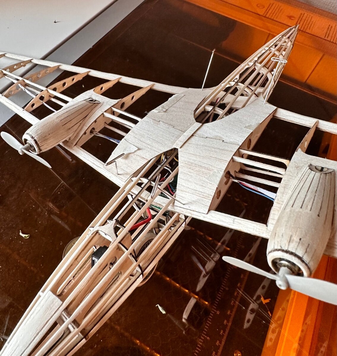

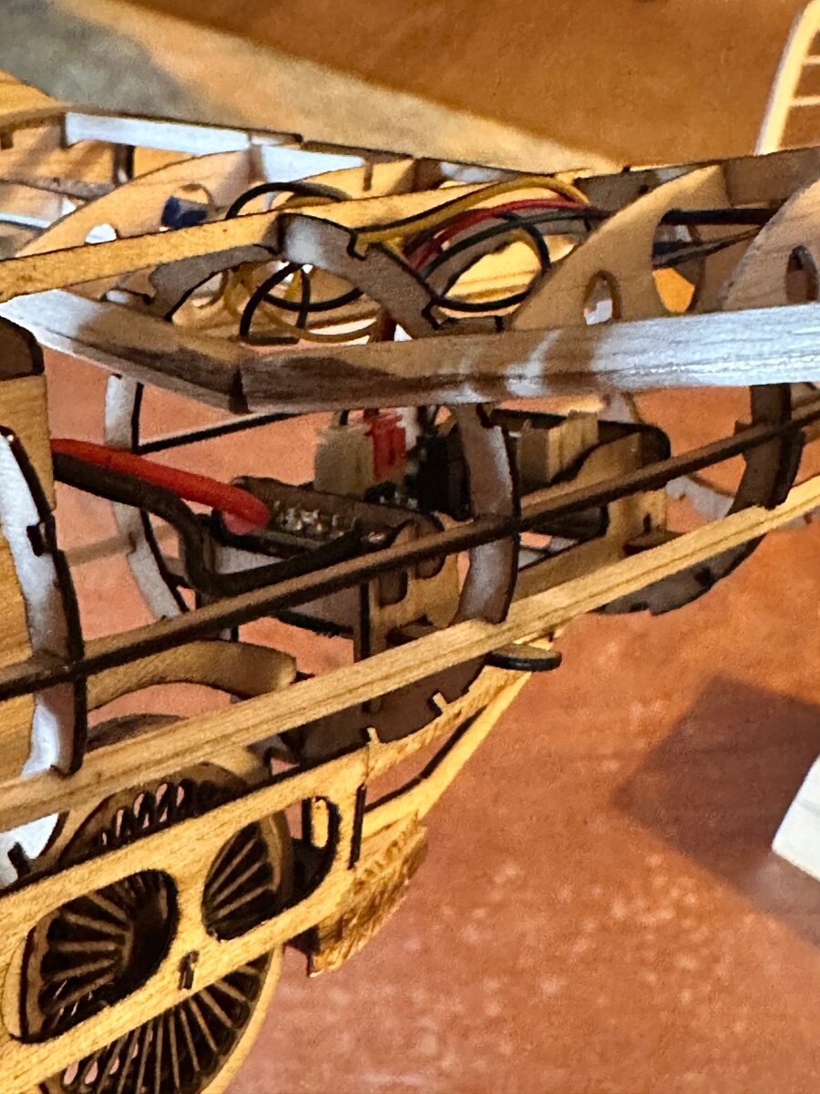

shepeiro Posted March 25 Author Share Posted March 25 Rx installed. due to the positioning of all the wires and the fact it has stabilisation meant I wanted it to be pretty sturdily suspended. I think it is but added an extra half gram add to that the light strips (1 more gram between them) I’m going to be coming in a little heavier than I had hoped. now the rx is installed I can finish off the fuselage. Quote Link to comment Share on other sites More sharing options...

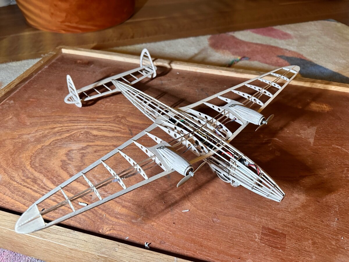

shepeiro Posted March 27 Author Share Posted March 27 Fixed servo with a rewrire. Everything installed. Broke all the stringers finishing the electronics so had to start again Quote Link to comment Share on other sites More sharing options...

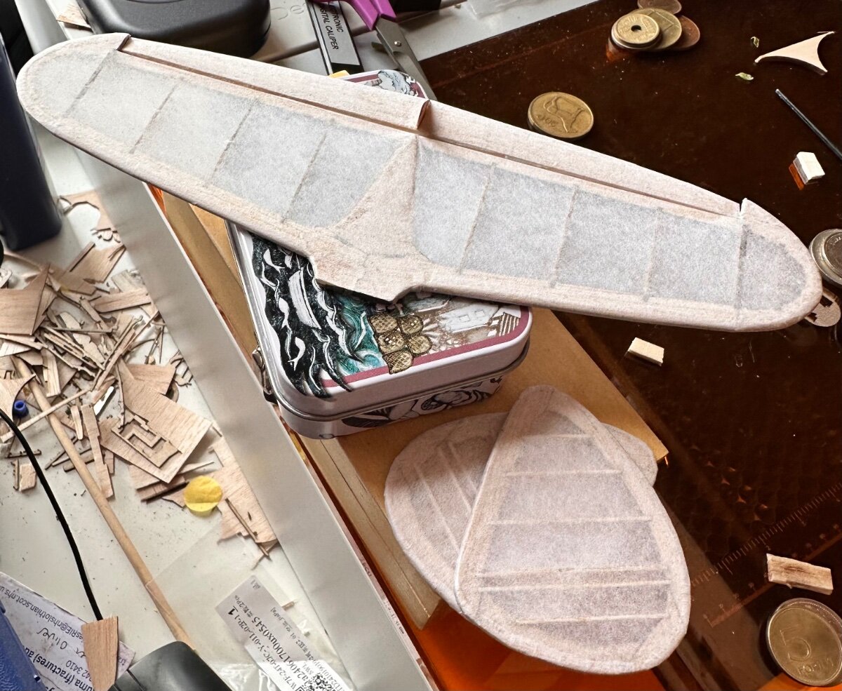

shepeiro Posted April 1 Author Share Posted April 1 Been figuring out decoration. Not 100% on it yet but right direction Quote Link to comment Share on other sites More sharing options...
shepeiro Posted April 1 Author Share Posted April 1 Better Quote Link to comment Share on other sites More sharing options...

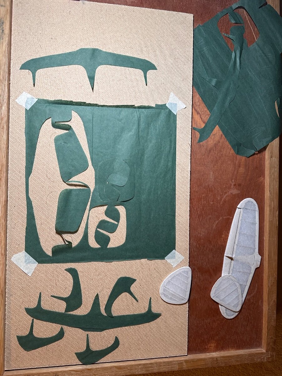

shepeiro Posted April 1 Author Share Posted April 1 Also going to try laser cutting tissue design. Anyone had success doing this or tried? not heard good things but am going to see if it’s possible to do it and get a clean cut and no material ignition. Wet tea towel at the ready 1 1 Quote Link to comment Share on other sites More sharing options...
shepeiro Posted April 1 Author Share Posted April 1 Ok after a bit of tweaking the answer is YES you can laser cutting tissue designs!!! Quote Link to comment Share on other sites More sharing options...
