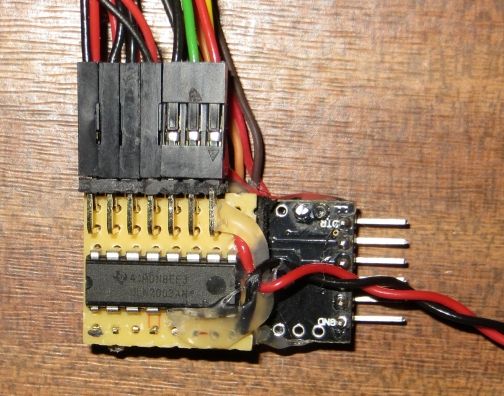

Barryorbik Posted February 21, 2016 Share Posted February 21, 2016 Touche John!, No pictures of my set up but I have the signal lead from Channel 5 of the Spektrum AR6100e going to D2 which switched between normal and landing modes when I operated the gear switch on the Tx. I have made my set up 'stand alone' as my Arduino board is now powered from the ESC output to the AR6100e by connecting the ground and positive connections from Channel 5 to the ground and + 5V inputs of the Arduino board, which is probably the set up I will use in the aircraft. The LED's (that are working) are connected through 150R current limiting resistors as follows: Green navigation light to TX1 on Arduino Nano Red Navigation light to RX0 " " White strobe 1 to D7 " " White strobe 2 to D8 " " Landing light to D4 " " My rotating beacon LED is currently disconnected from D3 as it does not work and looking through other Arduino sketches of similar LED drivers the 'boolean' statement has me truly bamboozled. Next project on my list is to make a servo move! Barry Quote Link to comment Share on other sites More sharing options...
Allan Bowker Posted February 21, 2016 Author Share Posted February 21, 2016 Here is the source thread of the code guys. Let me know how you progress. Quote Link to comment Share on other sites More sharing options...
Barryorbik Posted February 21, 2016 Share Posted February 21, 2016 Using that sketch has fixed it Allan, The only issue now is the landing light on D4 is not fully extinguishing but I have now gained a nice quick flashing strobe on D9 and a simulated revolving beacon on D3. If I get the time and enthusiasm I will compare the old and new codes and post the difference on here. In between time I have used my second Nano as a sound generator to reproduce the five note tune from "close encounters of the third kind" as it seems most appropriate at the moment!! Many thanks to Allan and John for their patience and help as we jointly enter this new world of discovery (or black magic) and I'm off now to make myself a very well deserved cup of tea, as STMBO is watching Midwife. Barry Quote Link to comment Share on other sites More sharing options...

Kevin Wilson Posted February 24, 2016 Share Posted February 24, 2016 There is a certain convenience with the Arduino having built in USB port, 5v reg and all the I/O s being brought out. So although being a tight so and so, I am prepared to stump up the extra for a £2.99 Arduino Nano clone (allowed under their common use license). Just to clarify. I have not loaded up this code for the Nav lights, that was just the teaser that made me follow Mr Bowkers links. I am working my way through various Arduino tutorials. Both from www.Arduino.cc and from www.adafruit.com To cover Mr Privett's observation regarding driving servos; there is an Arduino library (basically a function block) that can be called to do all the fancy servo pulsing. If I remember correctly the Nano can drive 5 or so servos (probably limited by the number of PWM pins). A revalation to me that almost all the IO are universal and can be defined in code. Even to the point of pullup resistors being internal & coded. Most entertaining. Quote Link to comment Share on other sites More sharing options...
Allan Bennett Posted February 24, 2016 Share Posted February 24, 2016 £2.99? I didn't realise they could be that cheap. Maybe I'll have to try one, for with my circuits I generally add a 5v regulator and some output transistors, or a darlington pair array, plus whatever resistors or current regulators are needed for the LEDs, and connector strips. Of course, building the devices is half the fun. Quote Link to comment Share on other sites More sharing options...

Allan Bowker Posted April 25, 2016 Author Share Posted April 25, 2016 Hello Ron I haven't had any time to progress this little project myself so far, I was hoping a few people might pick up the baton and run with it. We do need a circuit diagram for those of us who want to run higher power LED's and we need somebody to work on the original code I posted so that the lights can be controlled from the transmitter. I have seen some solution examples online when originally Googling around the web. Anyone else up for the challenge? Quote Link to comment Share on other sites More sharing options...
Kevin Wilson Posted April 25, 2016 Share Posted April 25, 2016 The running high power LED's shouldn't be a problem. Plenty of ideas from the Arduino community to add a transistor for higher loads than the 40mA that the Arduino can handle. Quote Link to comment Share on other sites More sharing options...
Alan Haines Posted April 25, 2016 Share Posted April 25, 2016 "We do need a circuit diagram for those of us who want to run higher power LED's" I know almost nothing about electronics so take my advice with a large pinch of salt.LED systems. For a neat ready made solution, look here: http://store.jdrones.com/jD_IOBoard_p/jdioboard11.htm I have used a few of these with no problems. For a home made solution, use a ULN2003A Darlington Array 7 NPN 500mA, for example: http://www.hobbytronics.co.uk/index.php?route=product/search&keyword=uln Hopefully, there's a picture nearby. AJH Quote Link to comment Share on other sites More sharing options...
