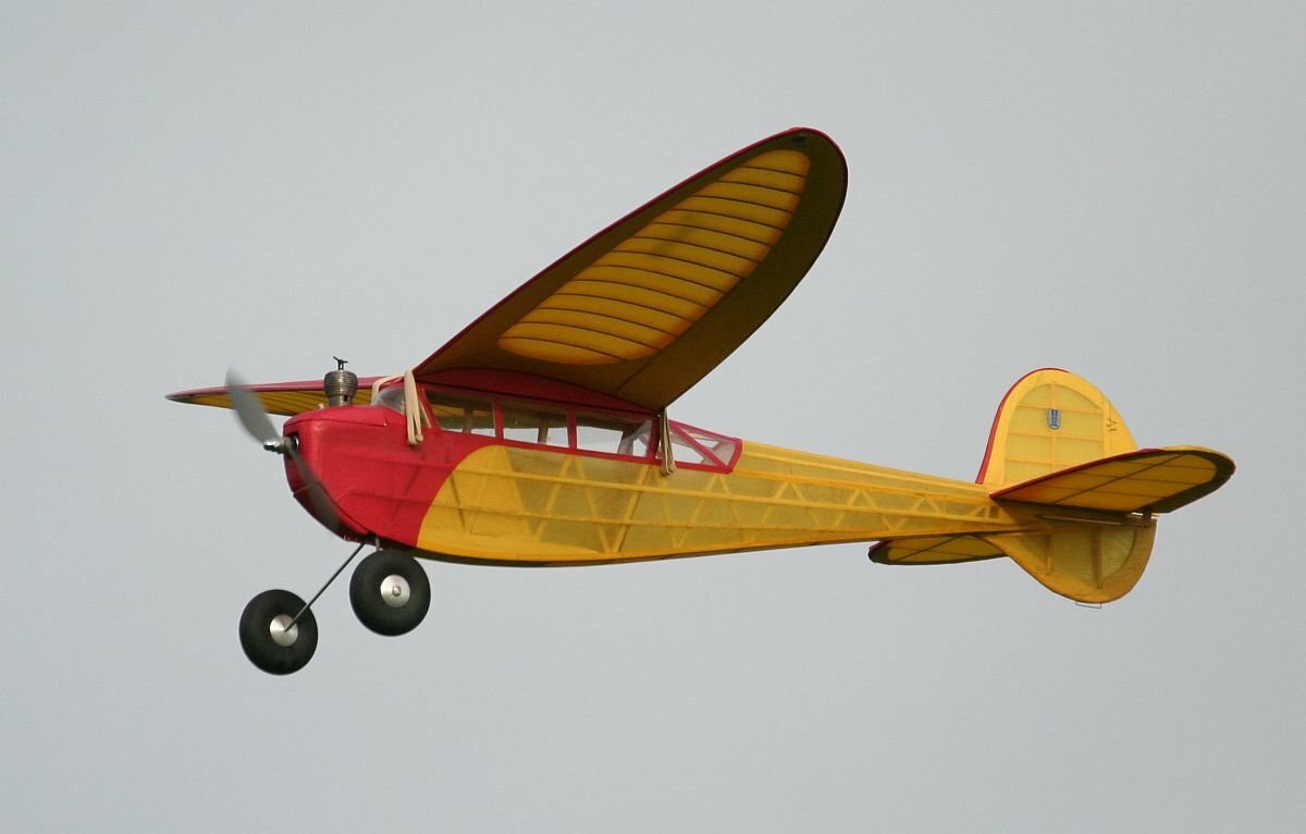

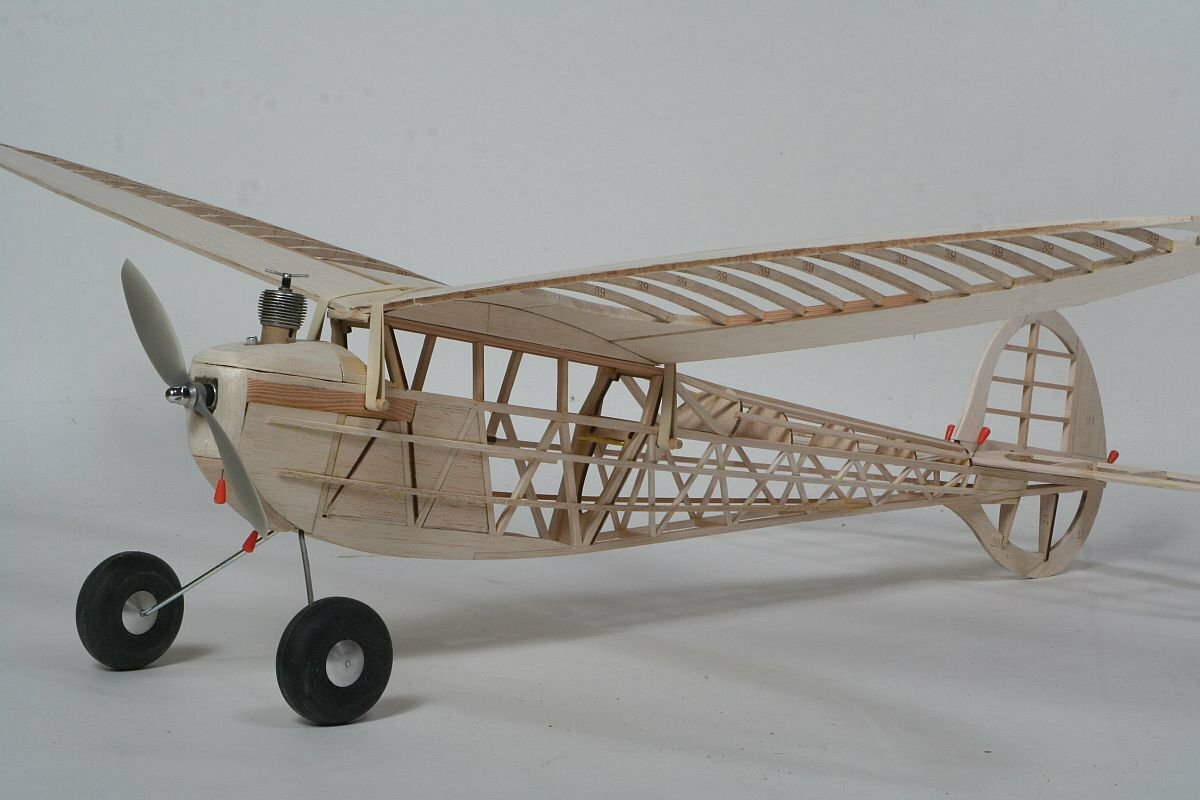

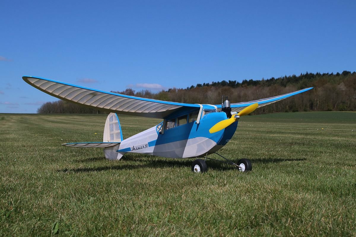

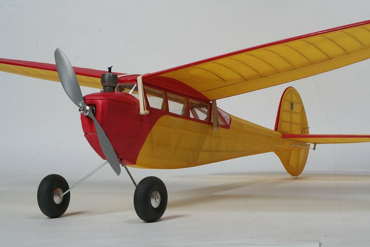

Tim Hooper Posted February 26 Share Posted February 26 (edited) Don't listen to the nay-sayers. I built my Cambrian Answer from the kit around a decade ago, and it still remains one of my favourite models, and is a regular flier for calm conditions! Your PAW 1.49 will probably be too much at full power for such a light airframe - although the noseweight might be useful. (Mine is electric, and uses a little outrunner on a 2S 1300 lipo, turning a 9x6 slo-fly prop). Yes, the Ritz wing design is unusual in its construction, but perfectly feasible to build and works well in flight. Mine is covered in tissue-over-Doculam. The bright yellow and red schem has faded considerably over the years, and is now a subtle lemon/pink combination. Tim Soaking the wing panels Joining the wing Planning the motor and battery as far forwards as possible. The naked airframe Red and yellow tissue over Doculam An old cylinder head has fooled quite a few! It's a lovely flier - honest! Edited February 26 by Tim Hooper 7 Quote Link to comment Share on other sites More sharing options...

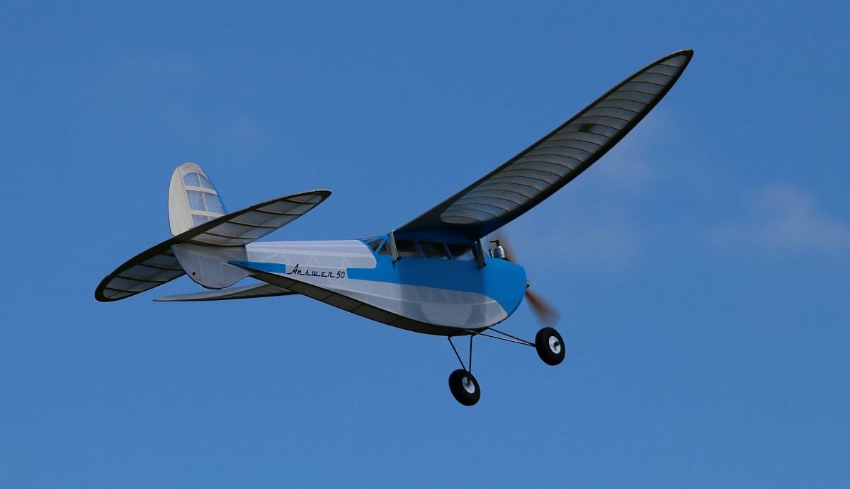

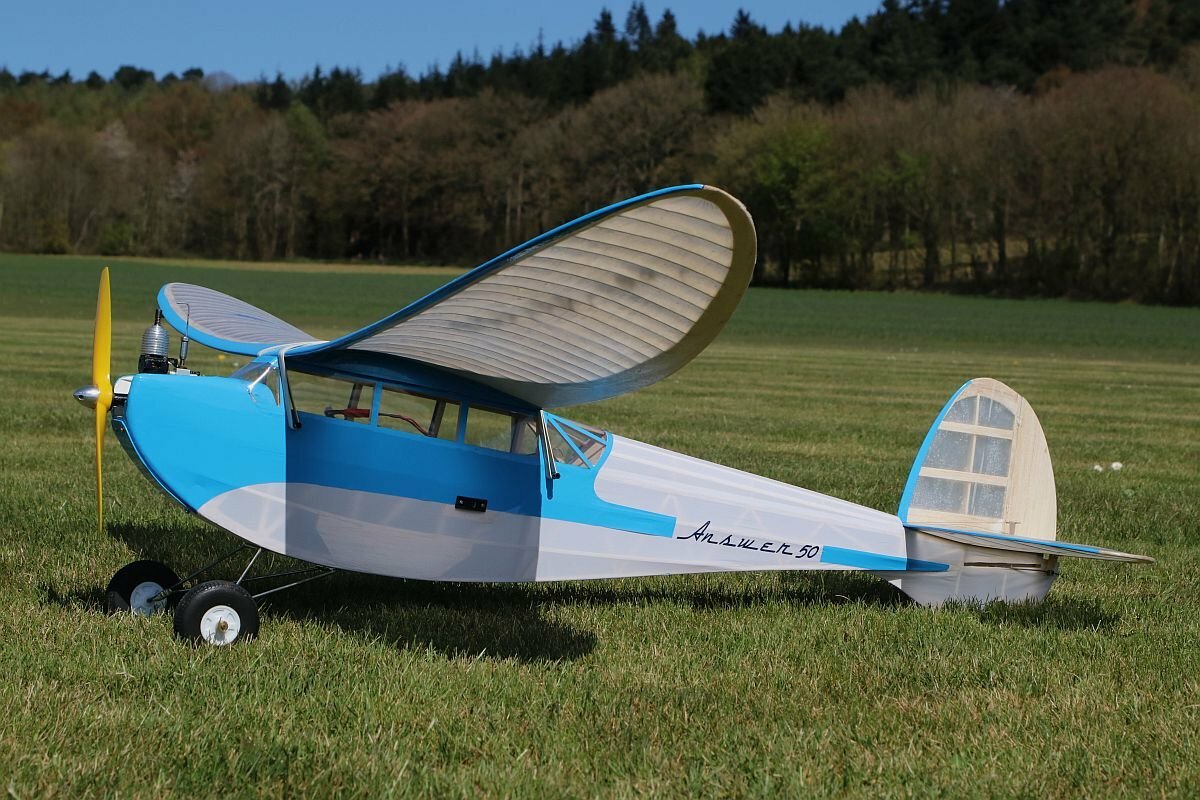

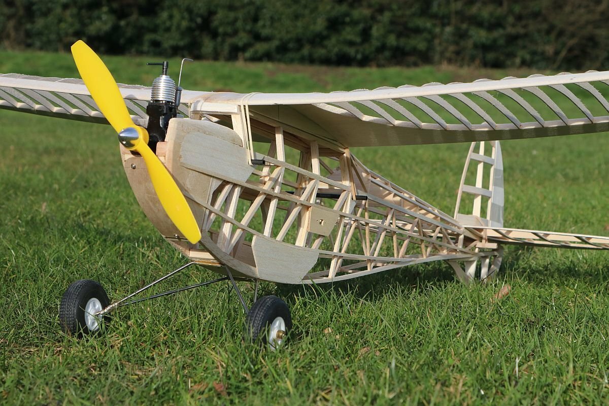

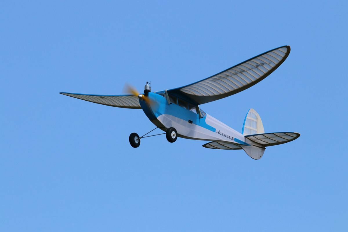

Tim Hooper Posted February 26 Share Posted February 26 (edited) Whilst I'm on the subject....... I was so impressed with the Cambrian Answer that when I stumbled on a 50" variant on the OuterZone plans site, it was a no=brainer to build another! 50" Answer plan Very similar to the smaller 44" original, but this one sports an Indian Mills 1.3 diesel - just perfect for relaxed pottering. Because there are no hardwood strips in the wing panels, they've pulled into a pleasing elliptical dihedral as the covering tightened. Tim Edited February 26 by Tim Hooper 6 Quote Link to comment Share on other sites More sharing options...

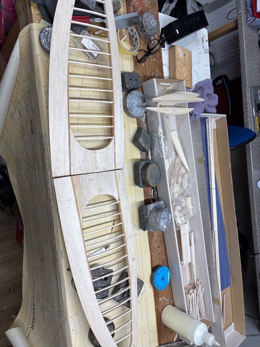

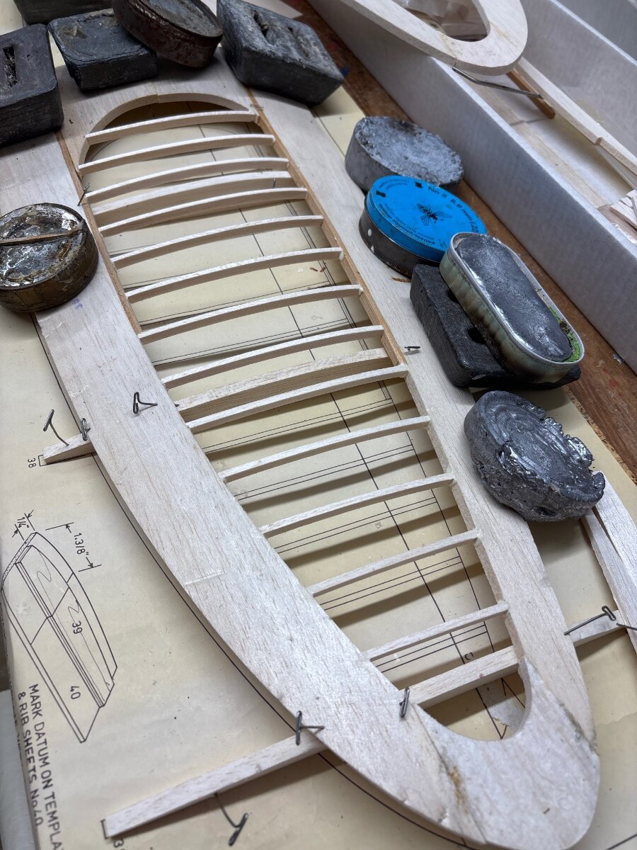

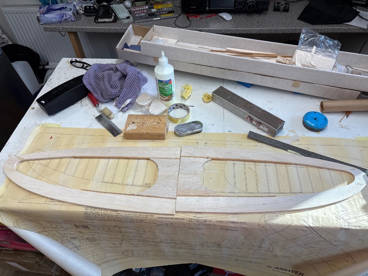

David perry 1 Posted March 3 Author Share Posted March 3 Wing outlines done. Glue tested for waterproofness so I’m happy to take the dive, so to speak! 2 Quote Link to comment Share on other sites More sharing options...
David perry 1 Posted March 3 Author Share Posted March 3 Right wing ribs in. Phew 2 Quote Link to comment Share on other sites More sharing options...
Tim Hooper Posted March 3 Share Posted March 3 Clever, eh? 😉 Quote Link to comment Share on other sites More sharing options...
David perry 1 Posted March 4 Author Share Posted March 4 Two panels done. Amazingly with the same curve ha ha. It works. 3 1 Quote Link to comment Share on other sites More sharing options...
David perry 1 Posted March 8 Author Share Posted March 8 Wings joined and shaped. Next to cover them. Options are doculam then tissue or nylon. Silk would be perfect but I don’t have it whereas I do have nylon. Shrinking dope to try to get the alleged curving effect. I must say it’s a beautiful wing when it’s made. 1 Quote Link to comment Share on other sites More sharing options...

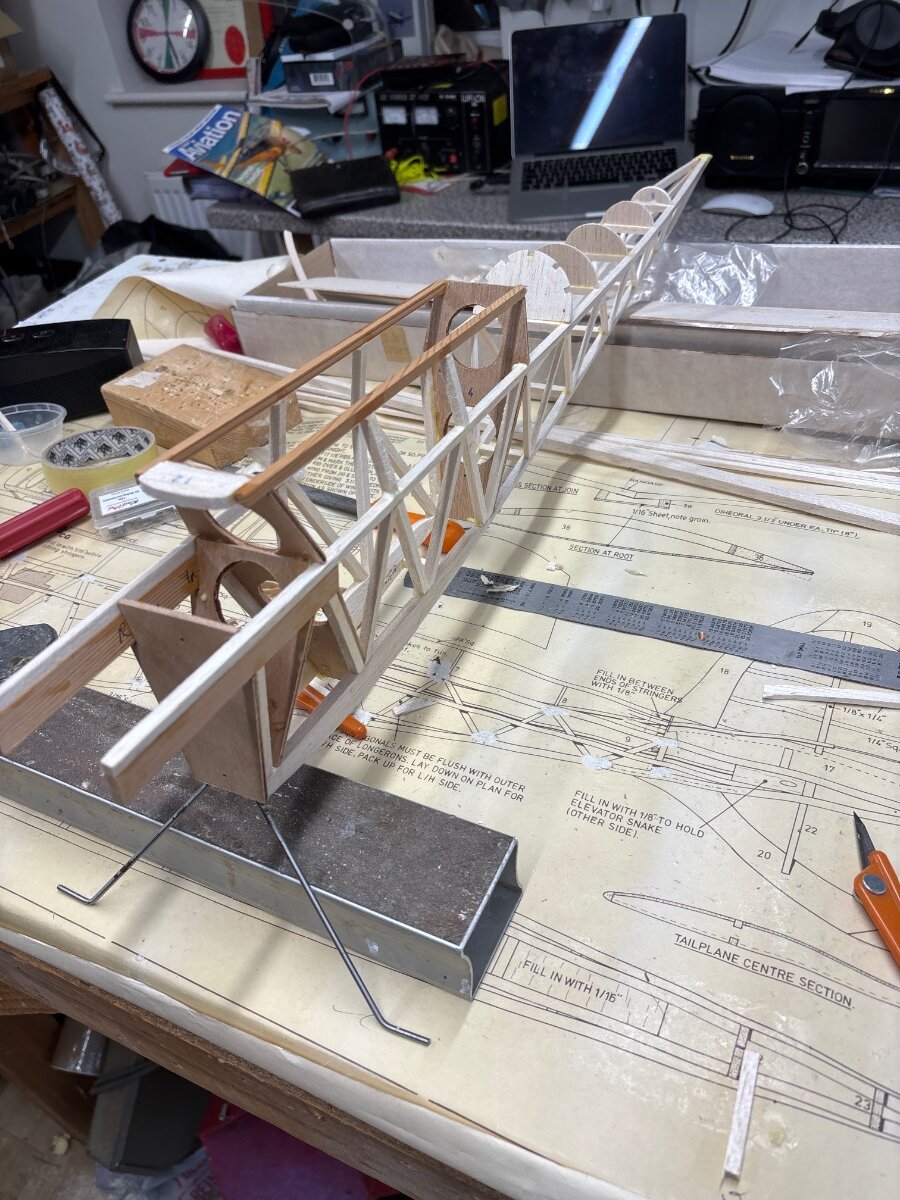

David perry 1 Posted March 11 Author Share Posted March 11 Basic fuselage sides built. I hadn’t appreciated the shape of the thing. Quite wonderful. 1 Quote Link to comment Share on other sites More sharing options...
David perry 1 Posted March 13 Author Share Posted March 13 Fuselage coming along nicely. 2 Quote Link to comment Share on other sites More sharing options...
Tim Hooper Posted March 14 Share Posted March 14 Looking good! To save weight at the rear end I binned the supplied snakes, and went for a lighter weight pull-pull set up for the rudder and a skinny carbon fibre pushrod for the elevator. I think the Answer was the forerunner to the Scorpion and Super Scorpion - although they both had a 'conventional' aerofoil section and structure. Tim Quote Link to comment Share on other sites More sharing options...
David perry 1 Posted March 14 Author Share Posted March 14 Thanks Tim ive ordered snakes and some smaller-than-standard servos. It’s a bit tight in there for my fingers. Quote Link to comment Share on other sites More sharing options...

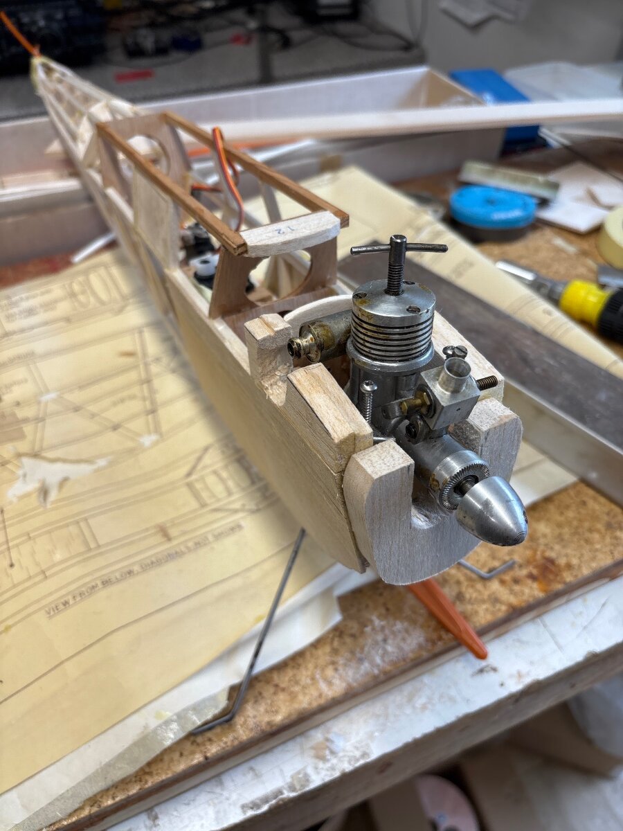

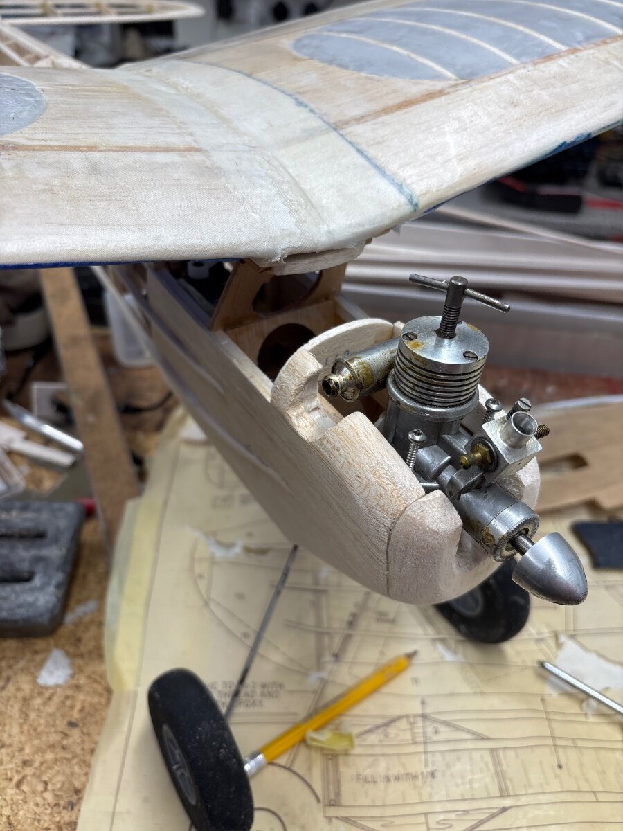

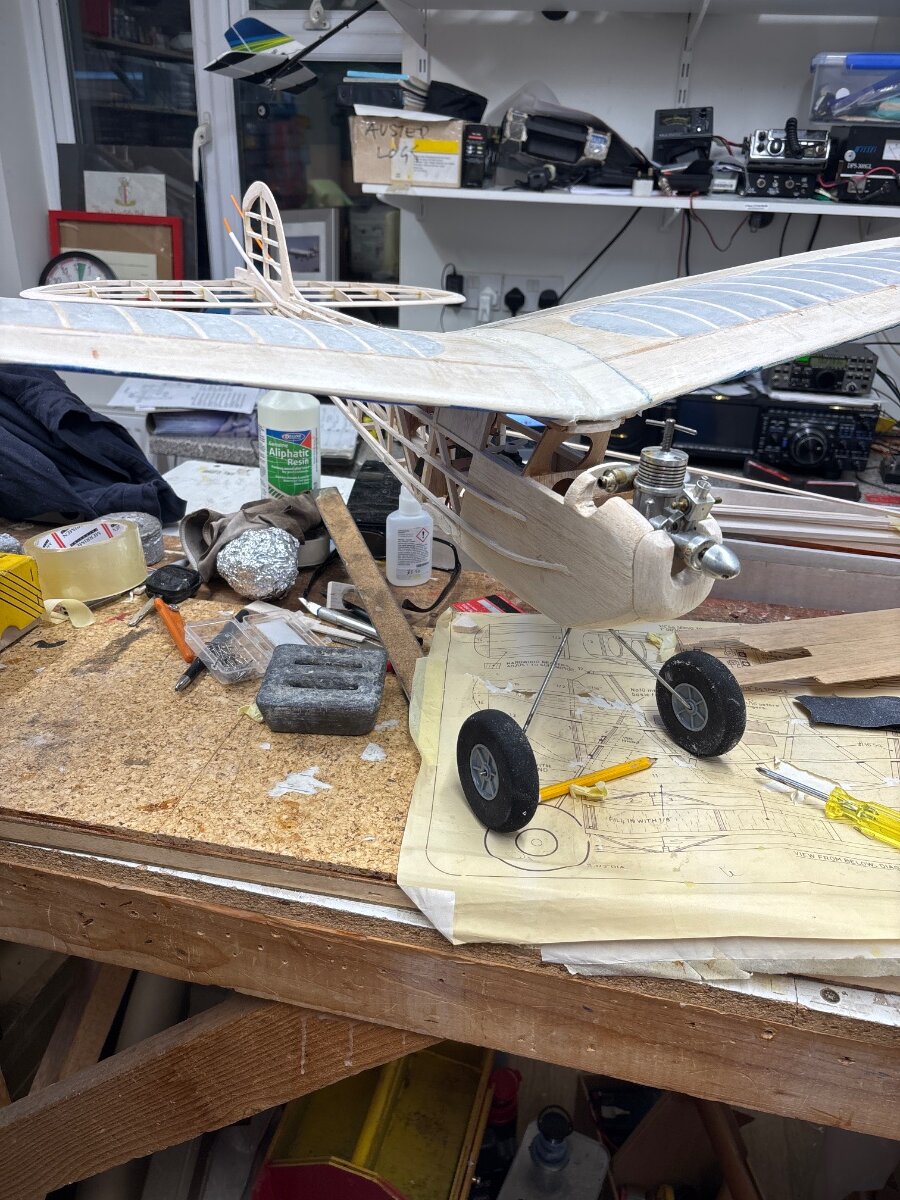

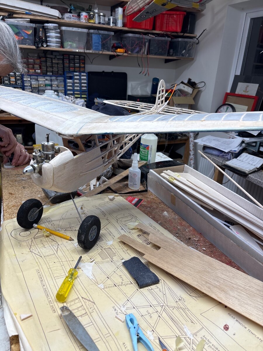

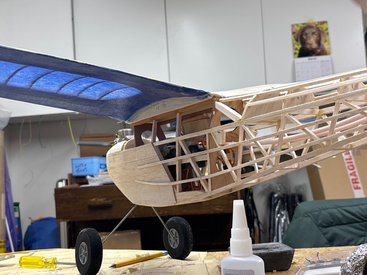

David perry 1 Posted March 22 Author Share Posted March 22 (edited) Radio fitted (etronix 17g) cowl blocks added pre carving and PAW149 fitted to check spaces. It’s coming along now I have no idea where to fit the fuel tank yet. Edited March 22 by David perry 1 3 Quote Link to comment Share on other sites More sharing options...
David perry 1 Posted March 23 Author Share Posted March 23 Here we go. pretty much ready to cover. Still perplexed about the tank ha ha. I need a 1 oz or a metal home made one. Anyway the airframe is done. The PAW looks ok in fact. Just need fuel! 4 Quote Link to comment Share on other sites More sharing options...
