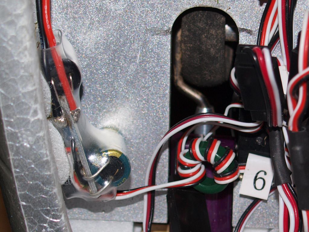

Goose10 Posted December 22, 2012 Share Posted December 22, 2012 Some help plse. Repairing my vampire at the moment after an unfortunate experience resulting in serious repair work; several wires snapped, all of which bar one I have been able to sort. The offender is marked 3 and I suspect it's the one that powers the receiver, but does anyone have a pic of what and whe it connects to? Down to what color wire is soldered to where? Just for info, when I switch on t DX6i and attached battery, there is a regular beep but no power to the receiver. Quote Link to comment Share on other sites More sharing options...
Ian Jones Posted December 22, 2012 Share Posted December 22, 2012 The wire labelled three is for channel three - throttle which would explain the beeping (as it also powers the Rx). So, being the throttle wire, one end goes to the Rx channel 3 port which I expect you knew and the other end goes to the ESC which I presume is the end you have a problem with. I'll nip and have a look at mine and see if I can get an answer to that for you. Back again.. before the edit timer ran out too! Hopefully these answer your questions: Edited By Ian Jones on 22/12/2012 14:31:09 Edited By Ian Jones on 22/12/2012 14:33:02 Quote Link to comment Share on other sites More sharing options...
Goose10 Posted December 22, 2012 Share Posted December 22, 2012 Seems like the circuit board is damaged as one of the cable seats has been ripped out; question therefore is what is the like-for-like replacement ESC , preferably available in UK. I note that its also connected to a UBEC that also connects to the ESC and receiver. 45A I think? Quote Link to comment Share on other sites More sharing options...
Ian Jones Posted December 22, 2012 Share Posted December 22, 2012 In that case I think you are after: Yep the spec says 45amp ESC Edited By Ian Jones on 22/12/2012 16:44:28 Quote Link to comment Share on other sites More sharing options...

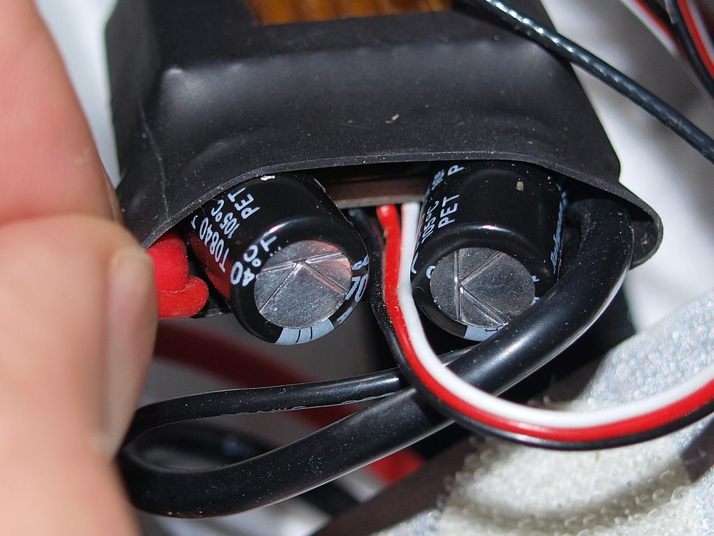

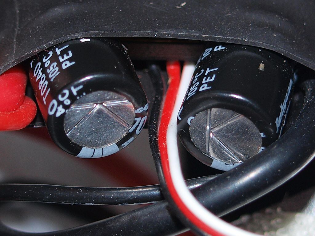

Mark Jones Posted January 26, 2013 Share Posted January 26, 2013 Got mine,built it (pnf version) no problems with the build. going to install the flat cf strip in the booms today, different story with the electronics, nothing happened when i plugged my lipo in-well i say nothing there was a brief twitch a flash of the light in my rx....and thats it. so i had another esc from another plane connected it up to all including fan- hey presto it all works (including the retracts). off to hobbyking goes an email to customer support, to which i got an almost instant reply asking for a pic and order no ect, which i promptly sorted. well that was on Monday the 21st Jan- not a peep since..(i know its only been 5 days ) even after me contacting them three more times,Not that impressed!!! on another note ive heard somewhere about making the nose leg retract either longer or raising the mount to aid the take off??? can anyone confirm or point me in the right direction of this being done no flying today.... five inches of crusty snow on the runway Quote Link to comment Share on other sites More sharing options...
J BENNETT Posted June 27, 2013 Share Posted June 27, 2013 Hi Guys, maidened mine this morning. First run wouldn't lift off after about 80m on grass. Had a second go with high rates on elevator and away she went. Flew nicely on half to three quater throttle. Then, after about 2 minutes I had no power above half throttle, followed shortly after by no power at all, although all flying surfaces were working. Turned into wind, but to far out and landed in corn field on top of corn, absolutely no damage. When recovered it was making 5 beeps, all surfaces working and no lock outs. Battery showed 60% remaining. Reconnected the battery with battery monitor on balance lead and everything worked fine, ran motor at full power until down to 3.7v under load and no repeat of the problem. My first thought was the the ESC low voltage cut-off had activated but surprissed it did not go after further running on the ground. Has anybody else had similar problems. Also, does anyone know the make off the ESC, and are there any instructions for setting the cut-off voltage. Battery was a Zippy 4S 2650mAH. First impressions are this is a great model and easy to fly. Club mate has one and gets long flights on similar battery. Quote Link to comment Share on other sites More sharing options...
