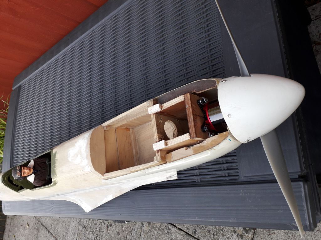

Clive Jones 4 Posted June 23, 2020 Author Share Posted June 23, 2020 Hi Guys, I am just sbout to install the motor "box" to the firewall. Do I give the "x" shaped motor mount some down and right thrust or straight ahead and level? Quote Link to comment Share on other sites More sharing options...

Martin McIntosh Posted June 23, 2020 Share Posted June 23, 2020 No down or side thrust is generally used on a model Spit. for some reason; there is none of any of my 44", 62" or 72" TN ones. My 62" TN Hurricane is very lively on a Propdrive 50/50 and 5s 5000 packs. 6s was too much. I think that it is on a 14x7 APC electric prop. but could check on that. Quote Link to comment Share on other sites More sharing options...
Clive Jones 4 Posted June 24, 2020 Author Share Posted June 24, 2020 Hi Martin, thanks for your input. I will try dead ahead and if I find it ballooning under power or diving for the LH hedge on takeoff I will adjust the thrust angle with washers. Can you give me the weight of the Hurri, please. That would give me some idea of how my similar Spit might fly. I have stuck mine together with tape/wingbolts and sacrificial balsa to estimate the C of G. I used 2x2200 3S LiPos to mimic 6S but after looking up weights on the internet I find that the 2x3S was about 250g under the weight of one 6S 3300. Good job too - the CofG indicated was 130mm rear of LE whilst the similar sized Freewing Spitfire quotes 90mm. As you can see on the photo, I could cut away the centre part of the original IC firewall and extend the battery compartment (Old IC tank bay) to possibly move the batteries forward if they are not too wide. Clive. Quote Link to comment Share on other sites More sharing options...

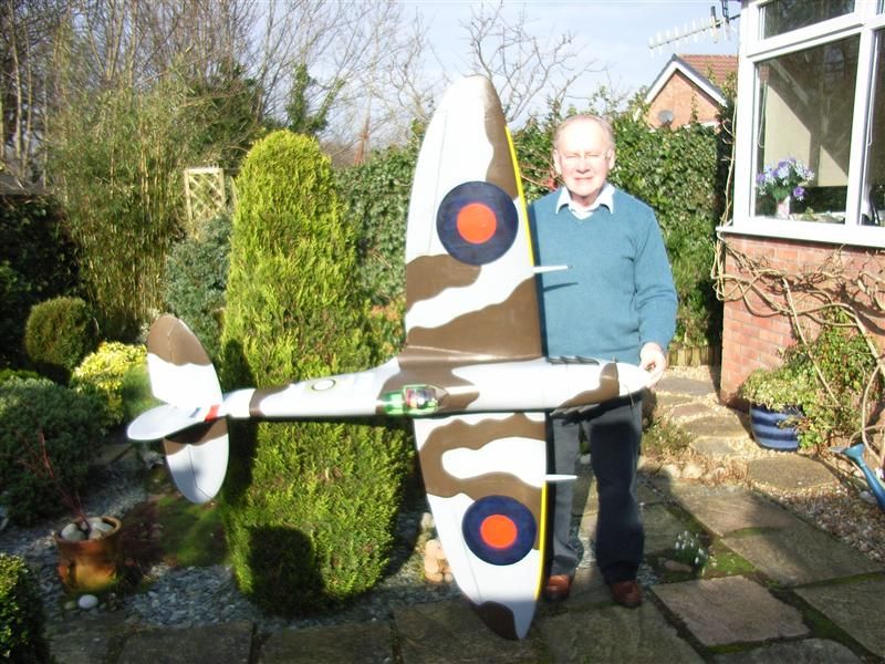

JAMES KEMBLE Posted June 28, 2020 Share Posted June 28, 2020 I'm building #6 (of 6). I started #1 and flew it that year. I'm not a fan of foam and I designed a built-up structure to copy the foam shape. On number 3 I re-designed the wing to follow a scale section and adjusted it to be at the same scale as the fuse. It flew well. However it was heavy, 9lbs 6 ozs.. I bought a lot of 4-6 lbs balsa and lightened as much as possible everything on the model. around the nose area it's easy to lose an oz by using a foam tailwheel and# 4 tipped the scales at 7 lbs 3 ozs and it flew like a bird and like a bird it ended in a tree top Finis. All this doesn't help you too much. To finishing. I used heavy weight tissue and no shrink dope on all the solid surfaces and Humbral model paints to finish, followed by a thin coat of satin polyurethane, The up front power is a K&B 60 from 1992, and it's going strong. Hope it is of interest. Quote Link to comment Share on other sites More sharing options...
