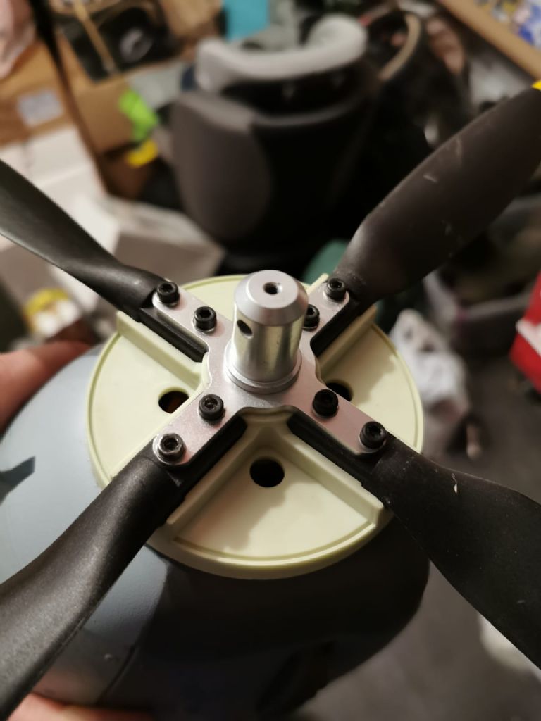

Trevor Crook Posted June 30, 2020 Share Posted June 30, 2020 Clive First of all, apologies for my assumption that your Spitfire was the TN one, I think it's about the same size! My son has sent over a couple of photos of the Flightline Spitfire prop arrangement, which I have inserted below. The threaded part of the adaptor which passes through the prop hub assembly is 8mm in diameter. Hope this helps. Quote Link to comment Share on other sites More sharing options...
Clive Jones 4 Posted July 1, 2020 Author Share Posted July 1, 2020 Hi Eric, thanks for the information, the fact that your hurri flies at that weight with less volts on the same prop I have has given me hope! lol. Trevor Crook, that is great. I managed to download the FL Spit manual and as well as the bolt holding the prop backplate and the prop cross-holder on the threaded adaptor, this has a keyed, square drive into the backplate. (I know the above sounds gibberish but one look at the manual will clear it up) Now that I have found out it is 8mm, which is the same size as the adaptor I have on My motor, I might consider using the FL spinner as the spinner comes as a kit and seperately you can buy the blades/backplate unit as well for not a great deal of money. The TN one is the same size and I have the builders log, which helps with some details. I think the TN one was designed with one eye on electifying it, whilst this one is an earlier plan which has all the (heavy) bells and whistles strengthening you would expect a vibration prone IC engine would need. Clive. Quote Link to comment Share on other sites More sharing options...
