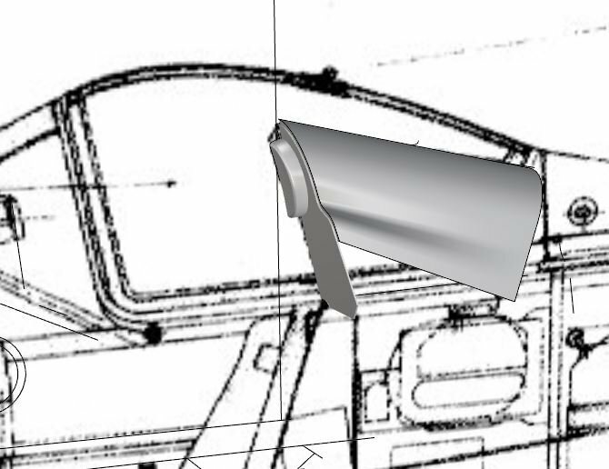

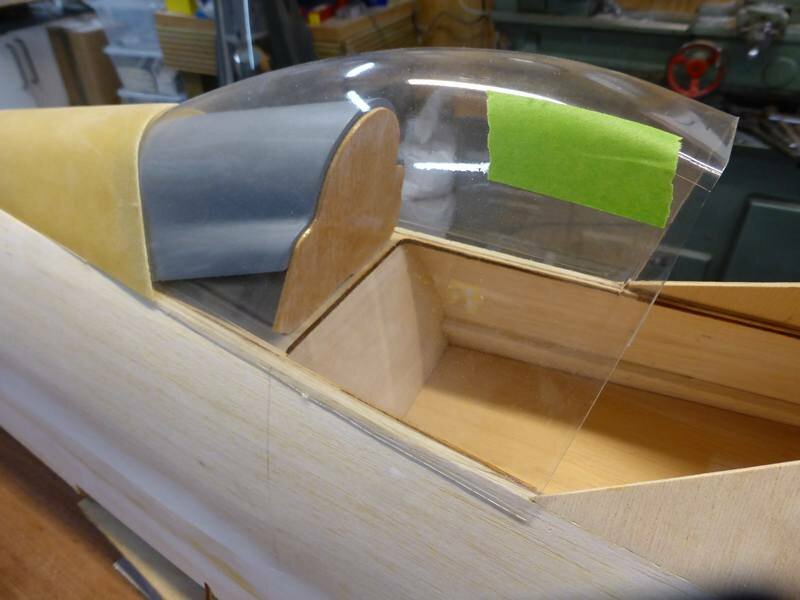

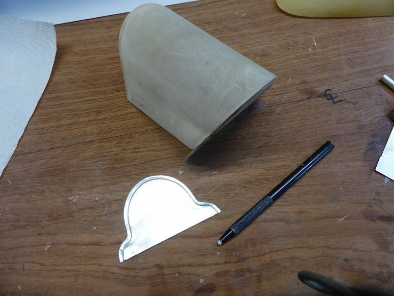

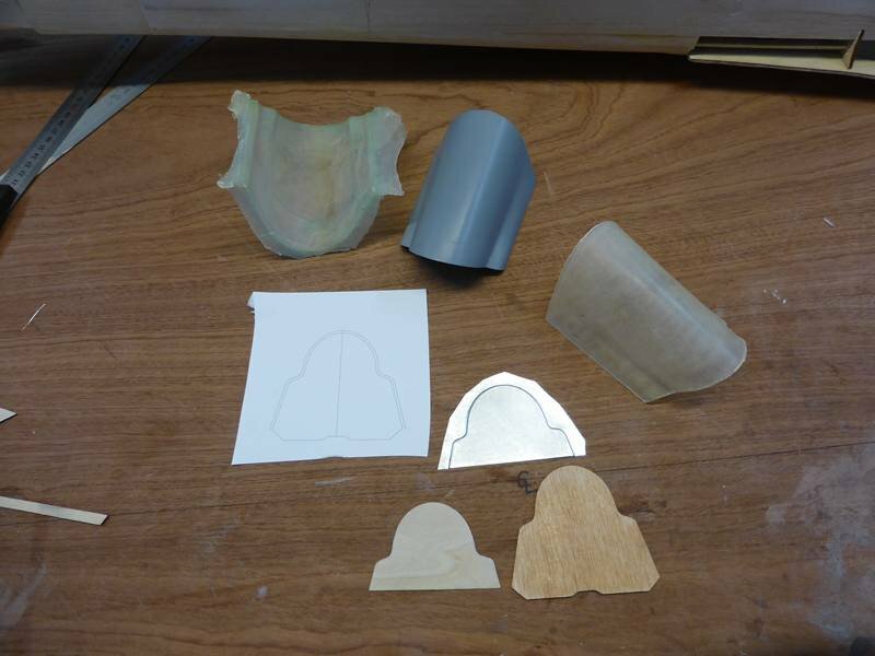

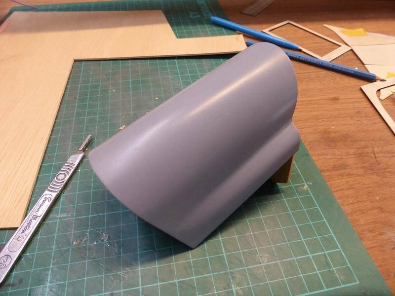

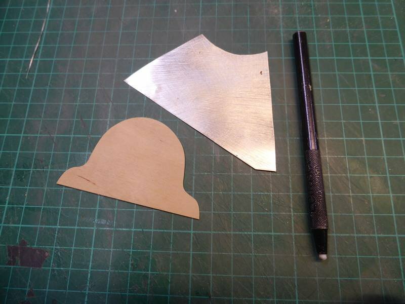

david tilbury Posted May 26 Author Share Posted May 26 Armour plate and rear plate support......pattern 3D printed.....ply armour plate with lithoplate cover as per full size 3 Quote Link to comment Share on other sites More sharing options...
