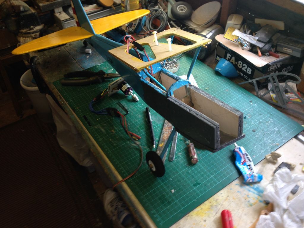

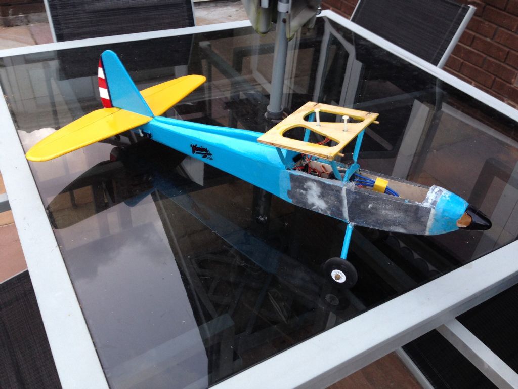

Colin Leighfield Posted July 26, 2014 Author Share Posted July 26, 2014 After feeling ashamed at my failure to get something hardly more ambitious than the rubber powered Frog Minx that I built when I was 10 to fly decently, I got over the initial temptation to jump on this and decided to have one more try. At least I might give those who've had the patience to watch this thread a giggle, even though the original purpose of the project has disappeared! So I cut off the damaged nose and made a new one that is a better shape than the original one was after I had inserted a 1" plug to lengthen it, this is the intended new length from scratch. I've built in 3 degrees of side and down-thrust. Because it needed weight to balance before, I've re-inforced the new side-pieces with 1/64" ply and replaced the Liteply motor mount with one from 1/8" ply. I am going to cut the wing at the points co-inciding with the mounting plate and build in dihedral, 3 or 4 degrees. Finally I will abandon the 30% of chord cg position taken from the Baby Barnstormer and fix it at my usual 25%. Surely this must work? I realise that the parasol wing lay-out is very prone to adverse aileron yaw and that Boddo originally designed this for rudder. However, with differential built in to the ailerons and rudder co-ordination, the yaw tendency should be minimised and flying characteristics should be tame and "waffly" like the umpteen Barnstormers I used to see flying decades ago. Getting this to work is now a matter of honour and an attempt to avoid being branded as the "clot of the year"! After finally sorting out the spinner on the Seafang I ran that up on Thursday evening. As it came up to full revs, the prop and spinner flew off and hit the side of the shed. The shaft of the XYH 3536 1250kv had sheared flush with the bearing housing. This motor has never flown and is identical to the one in my "Seacano" which has been perfect, so I know that someone is out to get me. Paranoia? What's that then? Quote Link to comment Share on other sites More sharing options...

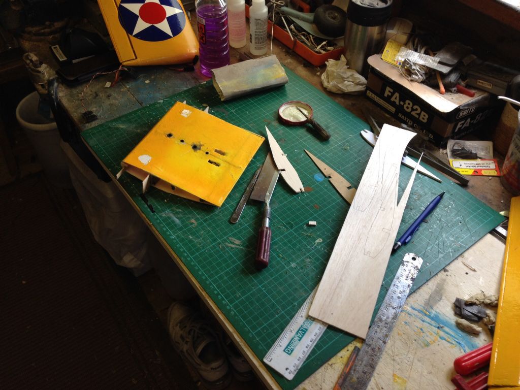

Colin Leighfield Posted July 26, 2014 Author Share Posted July 26, 2014 I noticed that the fuselage had tried to bend in front of the tailplane and the glue line between the tailplane and fuselage was cracked down one side. I opened the fuselage, straightened it and epoxied in a piece of 1/4" square balsa to brace it, then re-glued the tailplane. The next painful bit was to cut the wing in three pieces in preparation for putting in the dihedral. This is a bit tricky because I'd built it flat in one piece for strength. I'll be in the shed at 06-00 tomorrow because that's when I'll get my head around the best way to do it. The rest of the work on the fuselage is done, all it needs is some more Ezekote, glass and paint. My mind is made up, it's going to work this time. Quote Link to comment Share on other sites More sharing options...

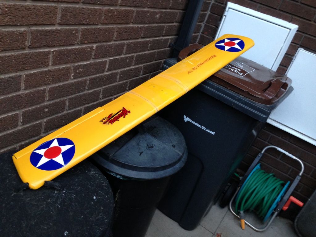

Colin Leighfield Posted July 29, 2014 Author Share Posted July 29, 2014 I've cut and re-joined the wing panels, but decided to limit the dihedral to 2 degrees. You will see that the millimetre ply dihedral braces are very short, this is dictated by the position of existing wing ribs and I don't want to cut the wing any more. However I'm not worried because the strength of the wing depends on the connection between the top and bottom wing skins. I've checked the re-assembled wing and it's very stiff, I don't see a problem with it. Tonight I've finished the Ezekote and glassing in the repaired areas, so it's ready for re-painting. When it's done I'll re-set the cg at 25% mean chord instead of the 30% shown on the Baby Barnstormer plan that I scaled this up from. I'm thinking of coupling rudder and aileron for the next flight attempt, does anyone have an opinion or experience on doing this with a parasol wing model? The position of the wing on the dust-bins was not meant to be prophetic by the way, just convenient for a photograph! Quote Link to comment Share on other sites More sharing options...

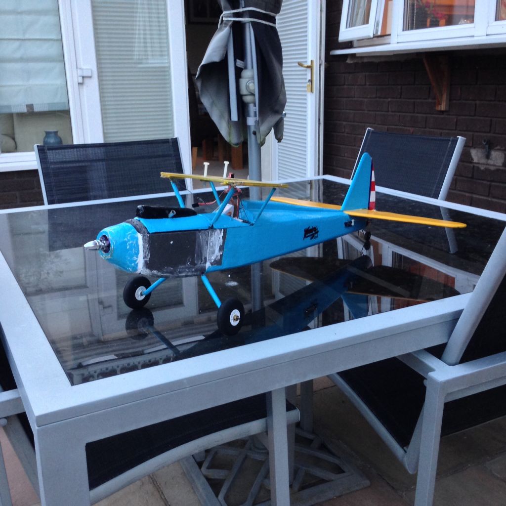

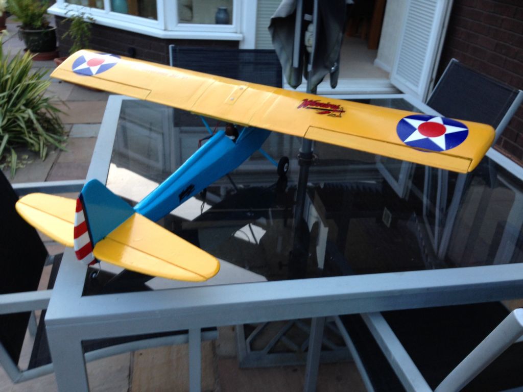

Colin Leighfield Posted July 30, 2014 Author Share Posted July 30, 2014 Getting close to the end of this now, whether it works or not, I will close the thread after the next attempted flight. I've done a better job of the nose this time, deepened it slightly to make it more comfortable for the battery, got the side and down thrust back to where they should be, I'd lost them when I lengthened the nose previously. The ESC is in a better ventilated position. There is now a little dihedral, 2degrees each side, that ought to help a little without fighting the ailerons too much. As mentioned earlier, I now think that using the 30% mean chord position for cg shown on the Baby Barnstormer plan for this 1/3 enlargement was a mistake, I will nose ballast it to 25% this time. Remaining jobs include one more coat of blue paint on the repaired areas and setting the cg in this further forward position. In the same way as "it's the economy stupid", here "it's the cg idiot". How many times do I need to re-learn the same old lesson? Also I'll knock off a couple more " Barnstormer 50 D" decals to fit on the fuselage. Finally I've convinced myself that I will mix in some rudder with aileron, although I'll keep the travels reasonably small to start off with. Next very cautious flight attempt will be later this week, then regardless I will move on to finish off other frustrated projects. Quote Link to comment Share on other sites More sharing options...
