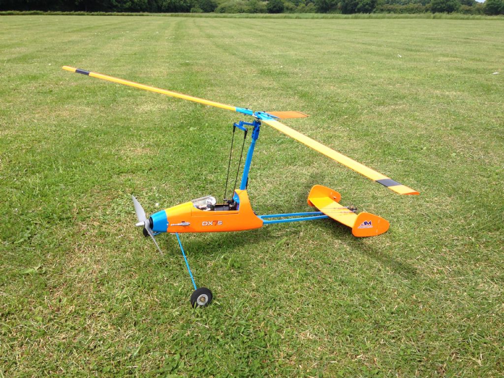

Hi Everyone,
Mine is an IC Atom with an ASP12 on an 8x4 prop. (I like engines) I built it in 2014/15 but until today, I have never flown it nor any other autogyro!! I was waiting for a steady breeze - blowing nicely this morning. My first takeoff, with the rotor spinning well showed that it was way over elevated. To maintain S&L I had the stick almost as far as it would go forward. Quick untidy landing - broken prop but ok otherwise.
The next take-off - after trimming was better and I managed about six circuits of the field.....getting the hang of it. A fast flyer with this set-up... G of G a bit forward?? However - I then did a downwind turn with a bit too much bank on.....it came down like a man-hole cover and I could not pull it out in time. I have just read Richard Harris's post about shallow turns - I learned that the hard way.
Quite a lot of repair to do now - A lesson learned!!!
But - the bug has bitten. I will repair this and am thinking of building another...

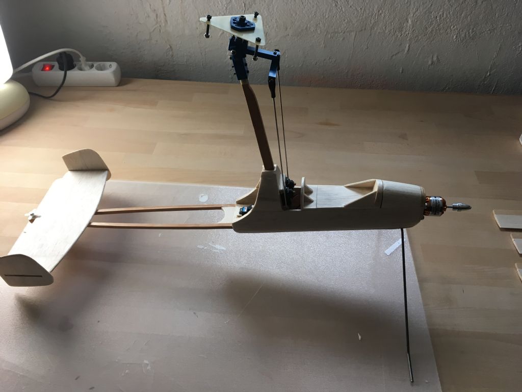

Here is my stage of the process. So far it is covered in two coats of wood surface primer...(it fills the little holes to allow for painting. What is that called?). Now just waiting for some parts to be delivered to finish the job.
Today I wanted to try the blades in the wind. Nice sound and spin up. Then the pushrods slipped out of my hands and the blades struck the stabilizers in the back. Within an instant they were gone...That is also the moment where I realized, I am such an idiot surprise , just like a little, impatient boy yes. But all is fixed already.
