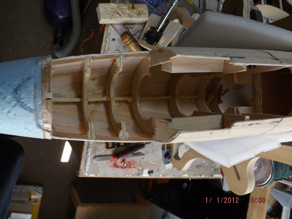

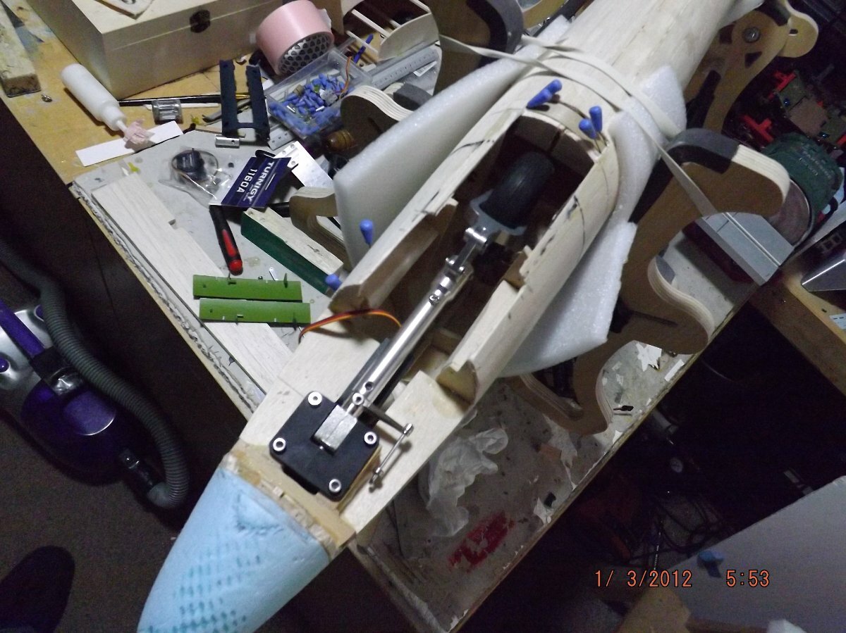

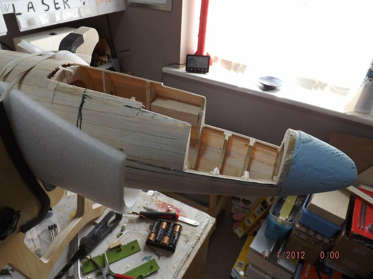

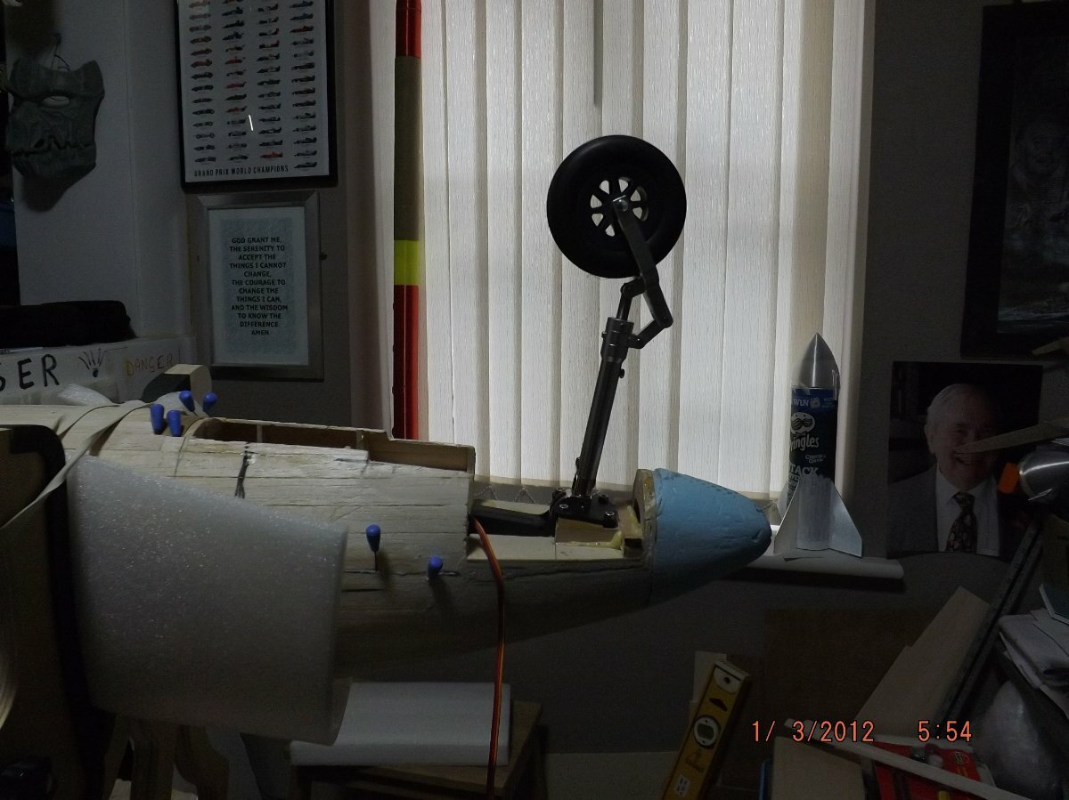

Martian Posted March 7, 2022 Author Share Posted March 7, 2022 (edited) I am making progress albeit slow . The main retract leg goes up and down with good clearance and ample oleo height for prop clearance from ground. I have also used blue foam for the rear of nacelle all sanded and blended to balsa more fine work will be needed. Gear door aperture is about done just need to fit doors. I have started one cowl the method I am using is first find a suitable jar then laser cut round formers to slip over jar separated by notched balsa spacers first ring is held in place on the lid with blue tack then the other 3 rings slipped into the notches and glued using aliphatic then 4 lengths of balsa and when dry I removed from jar. I inset another ring into the flightline cowl front then this will be glued onto the other section (I think ) Edited March 7, 2022 by Martian 5 Quote Link to comment Share on other sites More sharing options...

Martian Posted June 2, 2022 Author Share Posted June 2, 2022 Well 1 nacelle is sort of done its been a real pain to get the main retract to sit right then carefully measured for gear doors it took numerous times to get them to sit right and hinge open so fitted gear back in only to find the the door over the wheel would not close so take doors off cut away part of the nacelle sides trim and refit doors its now as near as its going to get. No wonder there are so few builds for the cat having checked the only build log surviving on RCSB by Wingspar and reading the comments without exception they all have same problem. Lets hope nacelle 2 goes better . I've been struggling with this one for over a month obviously not non stop . Still plenty to do .I WILL NOT GIVE UP ! 2 Quote Link to comment Share on other sites More sharing options...
