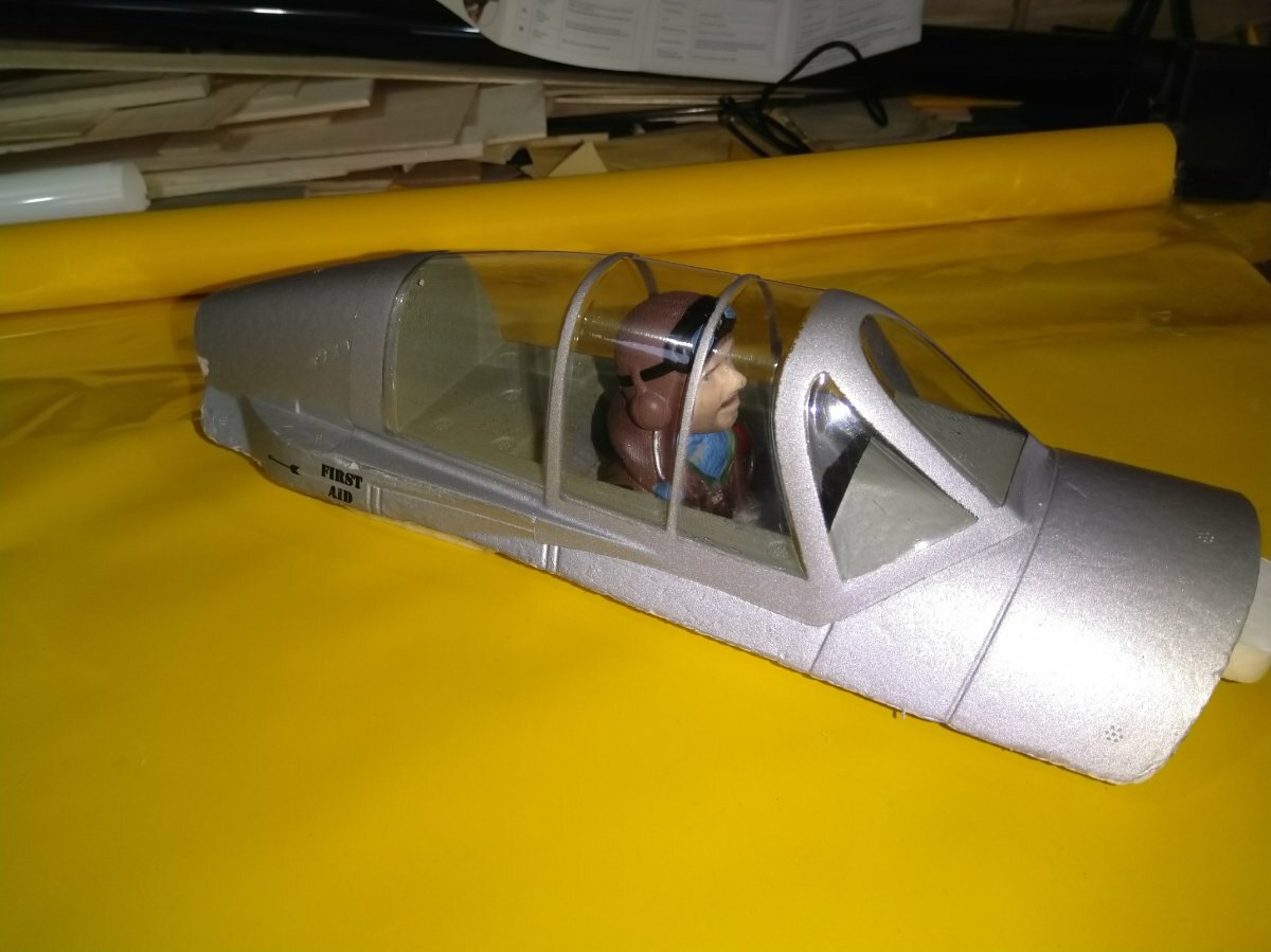

Geoff S Posted November 27, 2023 Author Share Posted November 27, 2023 After a suggestion by a club member at the field on Sunday, I bit the bullet and cut out the cockpit floor with a sharp scalpel and replaced it with a piece of 3mm softish balsa. Then it was a simple matter to disarm a former Dynam Hurricane pilot (I lost the canopy and pilot of my Hurricane and bought a replacement but the canopy was found by a club-mate so I had a spare that suits the Gladiator) and he fits nicely (in every meaning of the word). He does weigh a porky 18 grams and he sits behind the CoG but it's probably OK (I checked). Anyway I have a 'harmless' pilot in the seat which improves the looks a bit 🙂 I also gave him a pencil 'tache to make him appear a bit more mature. 2 Quote Link to comment Share on other sites More sharing options...
