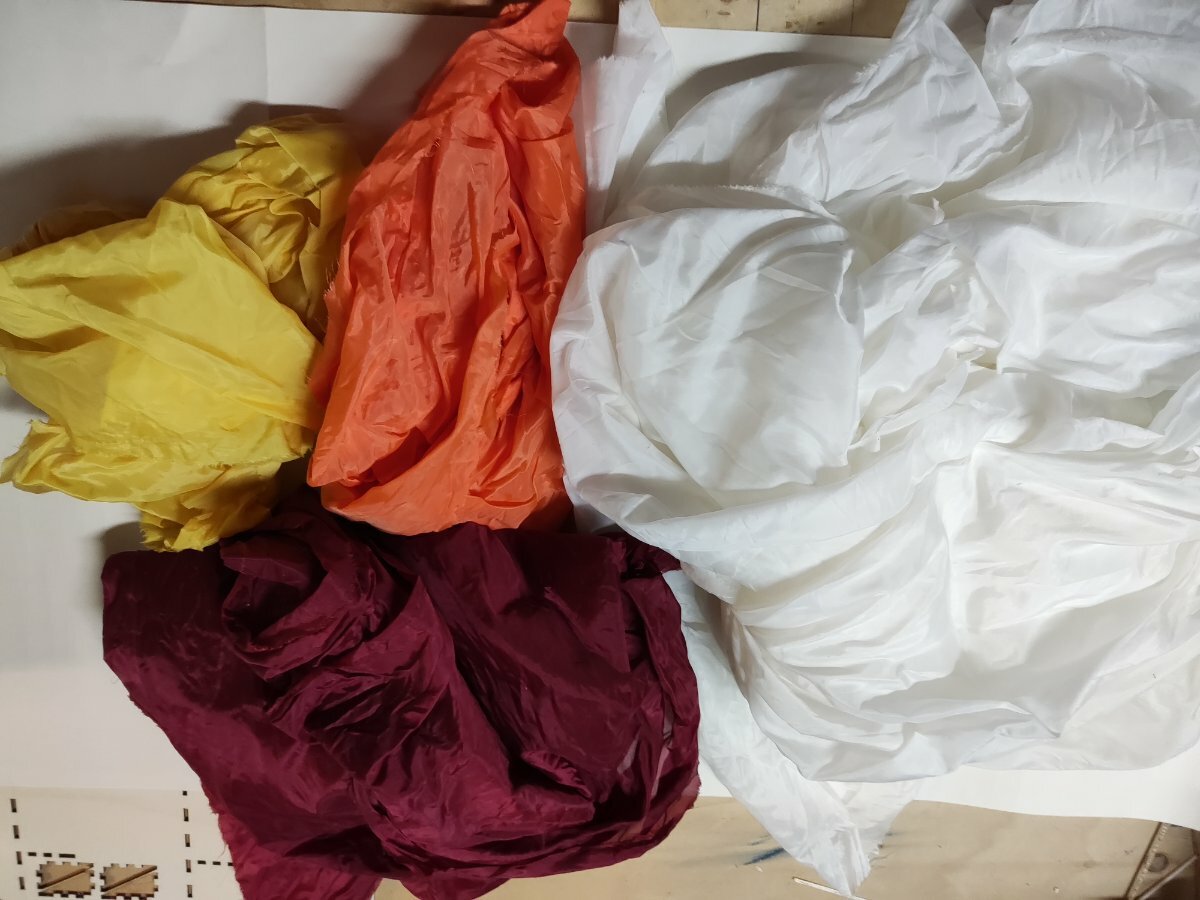

Edgeflyer Posted October 14, 2024 Share Posted October 14, 2024 I dye my own using fablon . Easy if you have an old slow cooker. Colours can be mixed. For trim I predope a piece onto a glass sheet. Comes off beautifully shiny and sticks to the under layer using a little thinners. I got 2 60's parachutes which are huge! I have bought dress polyester but find it too heavy. Dress lining fabric is lighter. I think freeflightsupplies.co.uk may still sell super lightweight silk! Quote Link to comment Share on other sites More sharing options...

Edgeflyer Posted October 14, 2024 Share Posted October 14, 2024 My own died nylon! Quote Link to comment Share on other sites More sharing options...
Andy Stephenson Posted October 14, 2024 Author Share Posted October 14, 2024 I looked at silk but it's quite expensive so artificial fibre it has to be. I didn't want to bother with the mess of dying the fabric so I found the colours I needed after an extensive search. I've dyed nylon before but I'm not sure how polyester takes dye, some plastics simply won't take dye at all. Quote Link to comment Share on other sites More sharing options...
