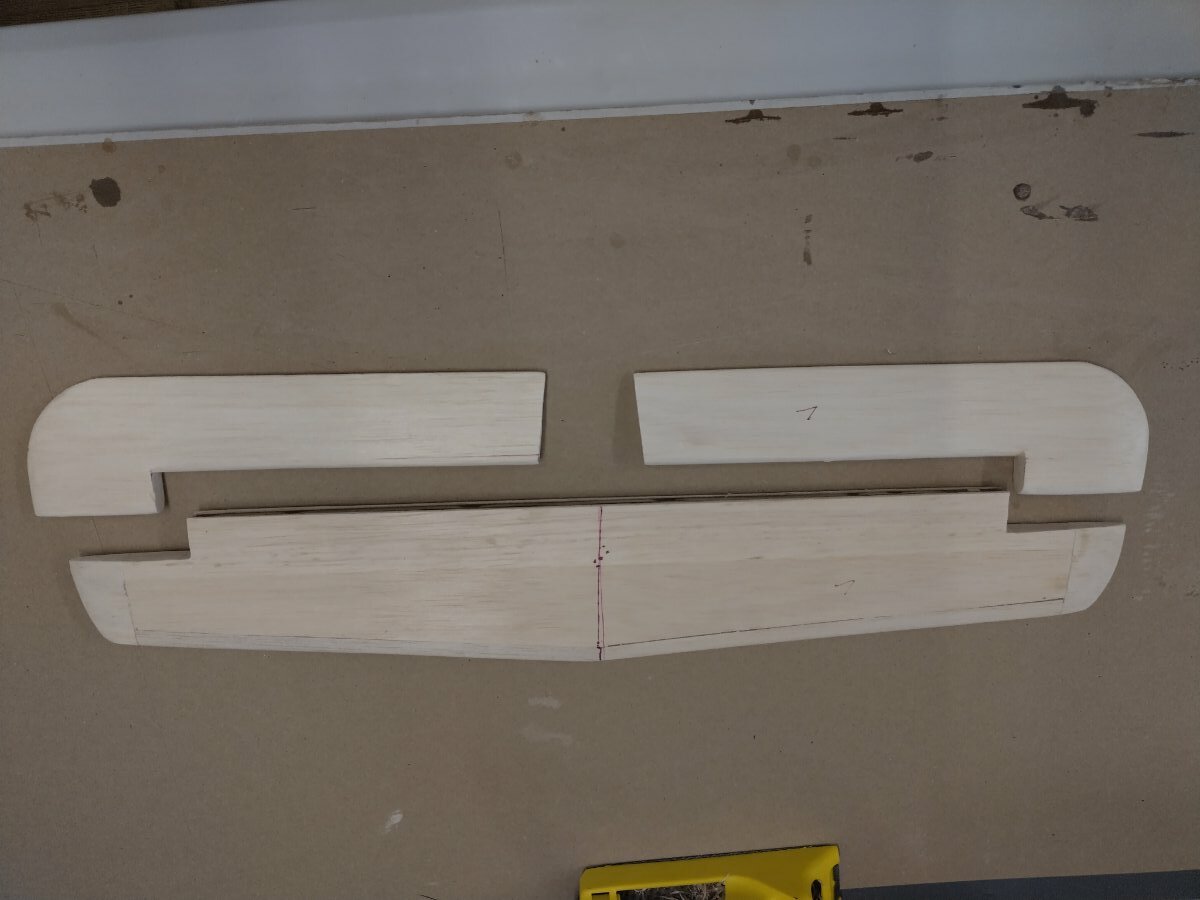

Declan Posted November 12, 2024 Author Share Posted November 12, 2024 So I treated myself and ordered the OS FS-95V from Just Engines. I've always liked the look and feel of OS engines and they do seem to be well engineered. The running in instructions seemed quite straightforward compared to the Saito and the SC. Only thing I'm not sure of is the need for an electric starter. I've not got one at the moment and tbh I preferred doing it manually with a chicken stick. Will this be an issue with this engine cowled and will I ultimately need an electric starter? And on that subject I've seen starters connected to lipo batteries as opposed to my memories of heavy leisure batteries? Finished the horizontal stabiliser and elevators. 1 Quote Link to comment Share on other sites More sharing options...

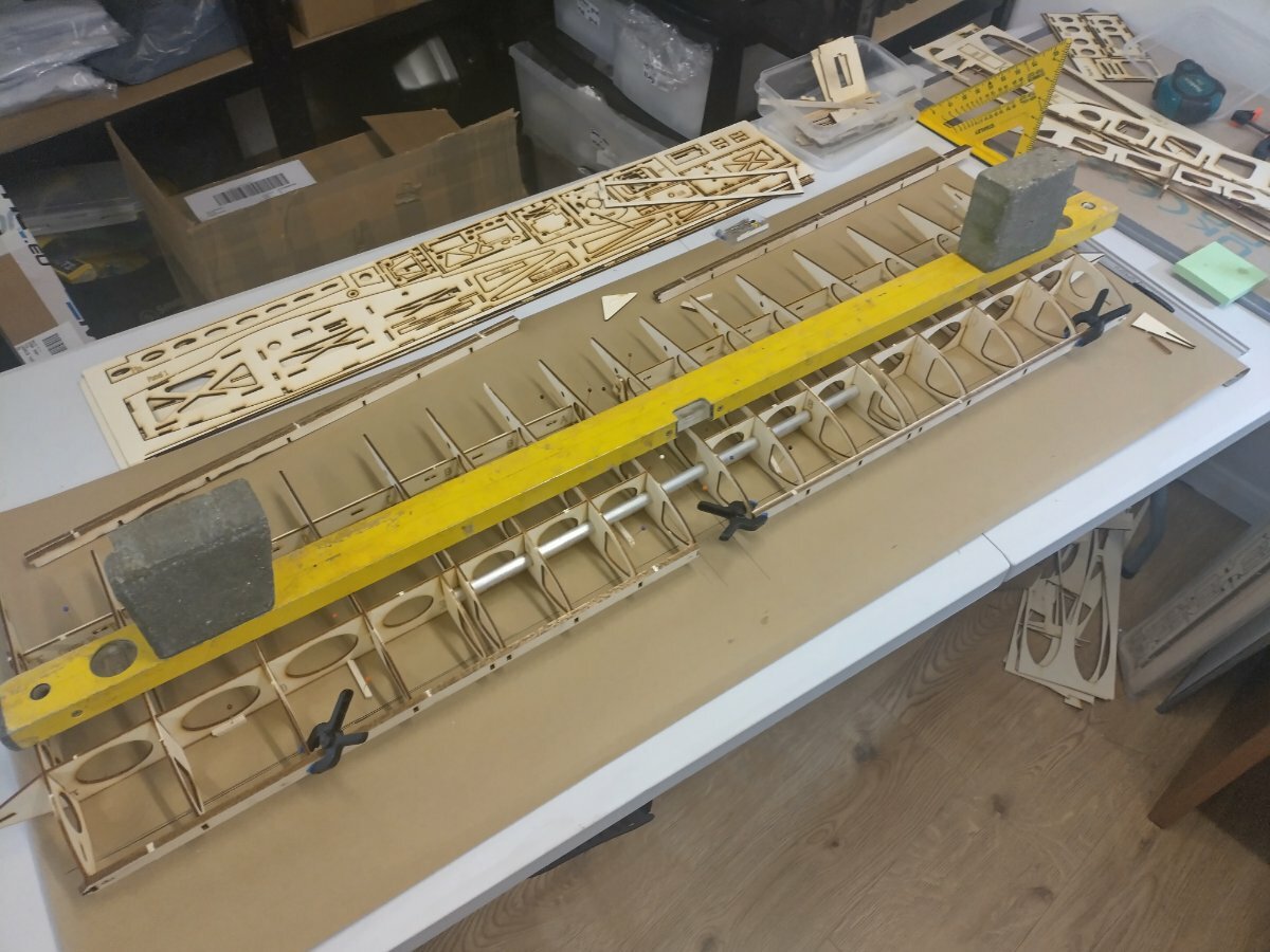

Declan Posted November 29, 2024 Author Share Posted November 29, 2024 Not posted anything for a couple of weeks and I've started a new build alongside this one. Weston Cougar for electric power kit. I've completed the main basic wing structure today. Maybe I'll start a new thread for this one. 1 Quote Link to comment Share on other sites More sharing options...

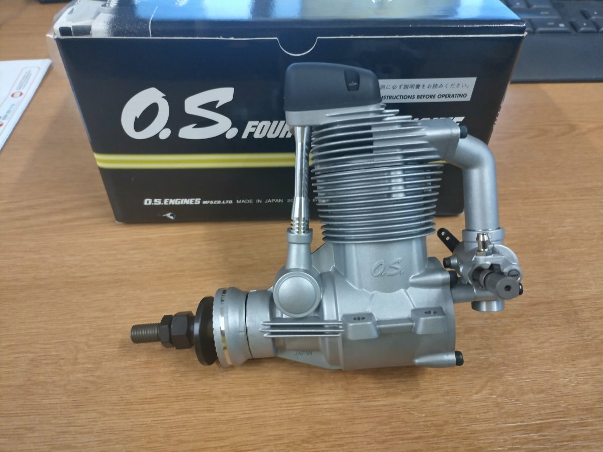

Declan Posted December 1, 2024 Author Share Posted December 1, 2024 Recent purchase of an OS FS95V for the build. A really lovely bit of Japanese engineering. Seems a shame to run it and get it dirty. I'll need to set up a test bench to run it in and set the mixture. 1 Quote Link to comment Share on other sites More sharing options...
Jon H Posted December 1, 2024 Share Posted December 1, 2024 Dont loose too much sleep worrying about running in and hold fire until you are ready to put it in the model. To be honest, i would just put it in the model and not really bother with the bench. In either case, when you do come to run it, make sure you get the thing hot as its no good if its stone cold. Running it slobbering rich at 4000rpm will do the engine no good at all and it will simply go rusty once you are done as it will be full of methanol. Just fire it up on a 14x7apc on 5 nitro 15 synth oil fuel. Leave it at 5000rpm for a few minutes to warm up, then full power and tune it for about 95% of maximum performance (this tuning should take less than 10 second) i would expect to see 8800-9200rpm which is fine, just check the revs after you tune it. Dont use a tach to tune. Set the slow run needle, double check top end...done. Should take about 5 minutes from first start to get all that done. Once set just play with the engine up and down the rev range with a few blasts (5 seconds or so) at full power, some hard accelerations from idle etc. When another 5 or so minutes of this exercise have gone by give it a good 10 second blast at full power and pinch the fuel to stop it. With that done let it cool, refuel, check tune, fly using full power only in short bursts as before. After 2 or 3 flights go for peak tune....extend the full throttle allowance a bit...and you are done. There is so much hysteria about running in engines. Its a non event, just tune it up and get on with it, just dont try and run it flat out all day and it will be fine. A maiden flight is stressful enough without also having to worry about an engine that is coughing a wheezing as its miles rich so just tune it up and go for gold using slightly less throttle. If you feel so inclined you could shoot some 2 stroke oil into the crankcase and rockers before you start, but OS are normally pretty good at this. If it were an ASP then it would need some lube for sure. Quote Link to comment Share on other sites More sharing options...
