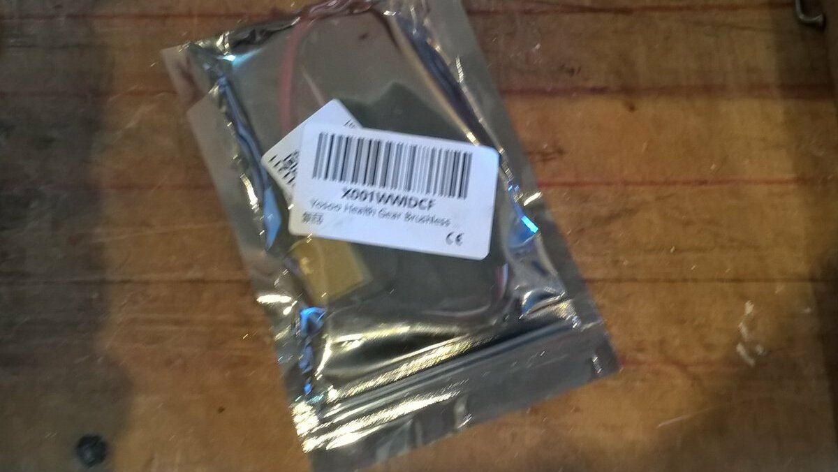

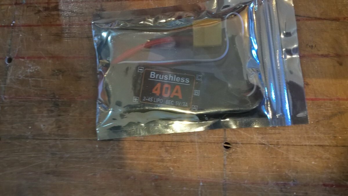

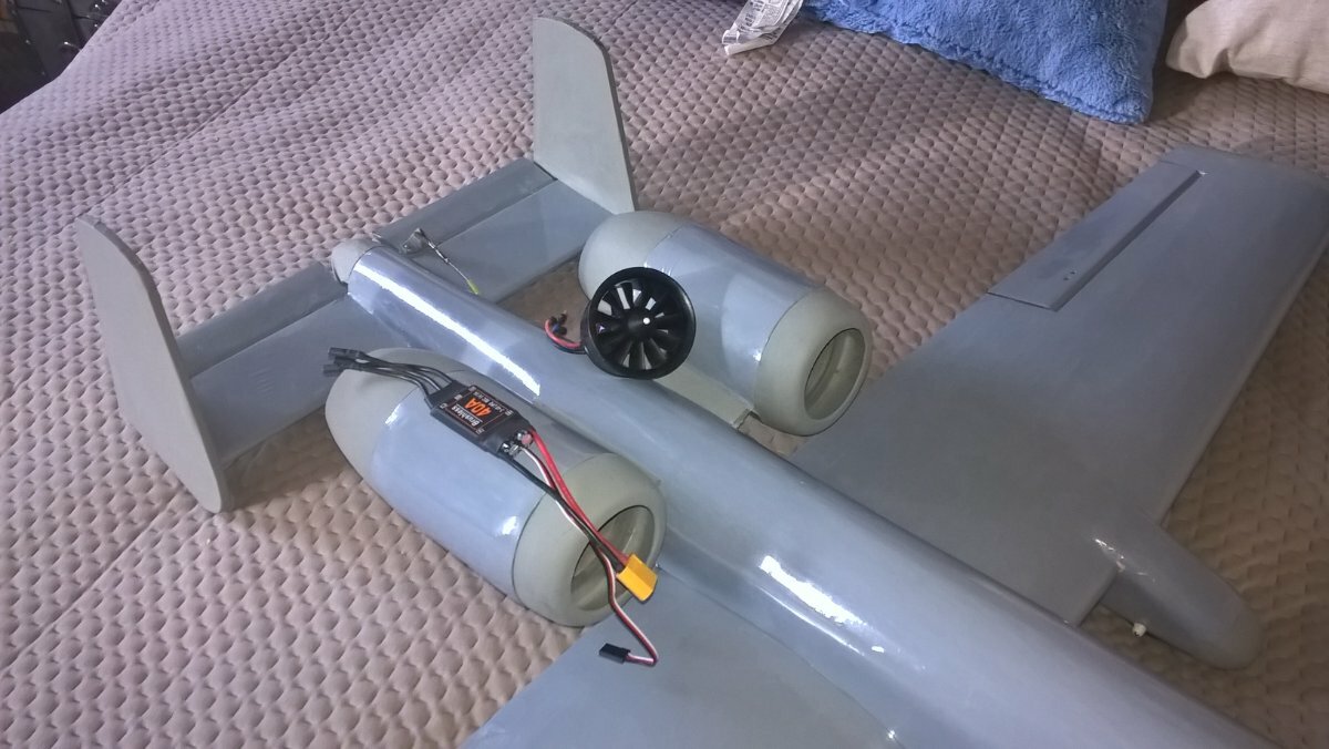

Erfolg Posted April 8 Share Posted April 8 I am having problems with these ESCs, marketed as "Yosoo 40 amp Health Gear". At first I thought the ESCs were faulty, then I thought both fan units were doof. I first thought that the ESC, BEC was faulty. I determined that it was driving the RX and servos. I then thought that the fan units were faulty, although one turned about 1/3 rd rev, then just sat there. I use a Futaba, therefore reversed the the throttle prior to starting the set up. I set the throttle to max before putting power onto the Rx. On hearing the beeps, I moved the throttle to no power. It has then continued to various beeps, the motors not doing anything. I have tried other combinations getting nothing but beeps, the servos continued to work. Any ideas what I am doing wrong? Quote Link to comment Share on other sites More sharing options...
Erfolg Posted April 8 Author Share Posted April 8 I should have mentioned that they drive a outrunner motor. Have been using a 3s Lipo. I do intended running on a 4000 4s lipo, which arrived yesterday. Quote Link to comment Share on other sites More sharing options...

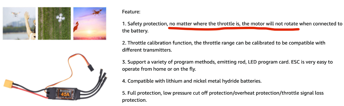

John Lee Posted April 8 Share Posted April 8 Never heard of the brand but when I looked it up I noticed this: so it's doing what it says! Presumably there is something that over-rides this 'feature' Is there a manual? Quote Link to comment Share on other sites More sharing options...
RottenRow Posted April 8 Share Posted April 8 Have you made sure that the range of your throttle channel covers -100% to +100%? Can you monitor that on your transmitter? Most, if not all, ESCs require the throttle output to be at minimum on power-up for them to initialise. Anything else will prevent the motor from running, which I think is what is being alluded to in the red underlined sentence in John’s post above. Make sure that you have the ESC plugged into the correct channel output on the receiver (channel 3 on Futaba). If still no-go, plug a servo into channel 3 to verify that the output is varying as expected with the operation of the throttle stick. To do this you’ll either need to connect the ESC into an unused channel (to supply power to the RX) or use a 4.8V battery. Brian. Quote Link to comment Share on other sites More sharing options...
