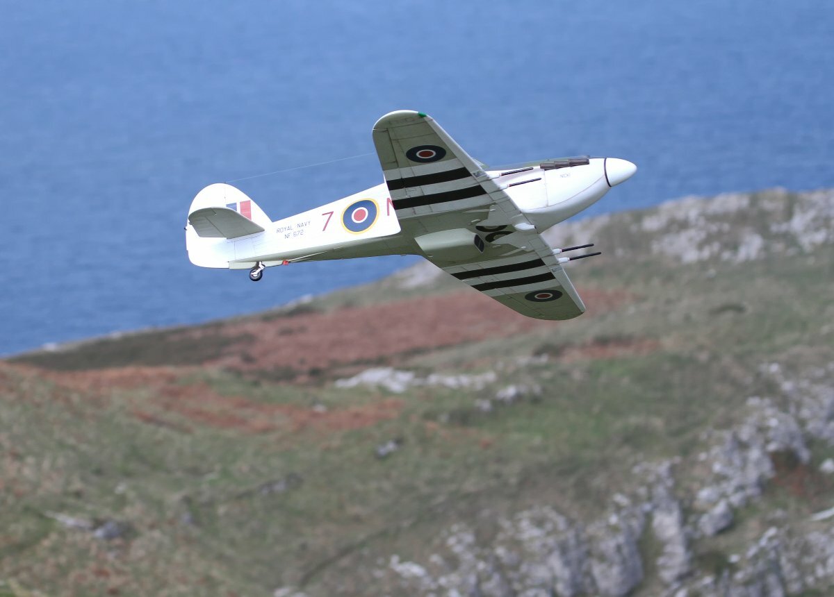

Phil Cooke Posted May 12 Author Share Posted May 12 A few Hurricane flying shots, I still enjoy flying this MB model a lot, it has plenty of energy and a slick performance! Quote Link to comment Share on other sites More sharing options...

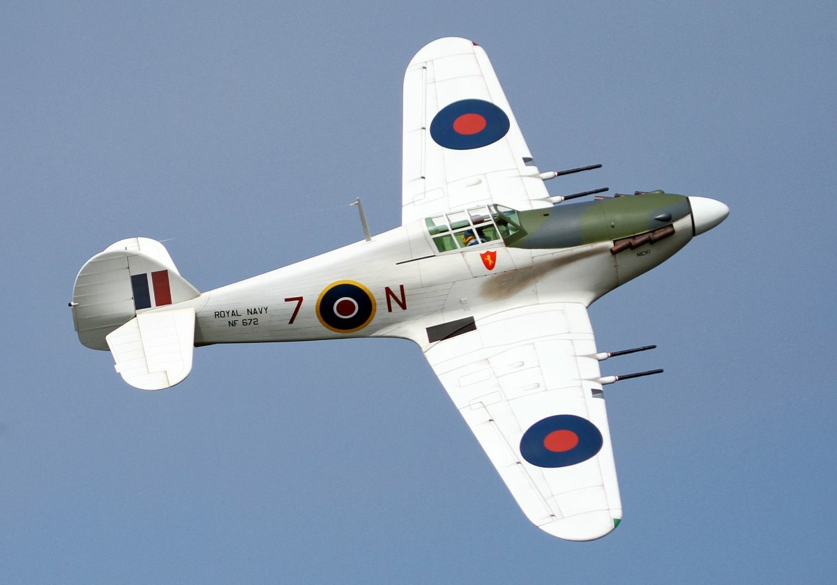

Phil Cooke Posted May 12 Author Share Posted May 12 2 Quote Link to comment Share on other sites More sharing options...

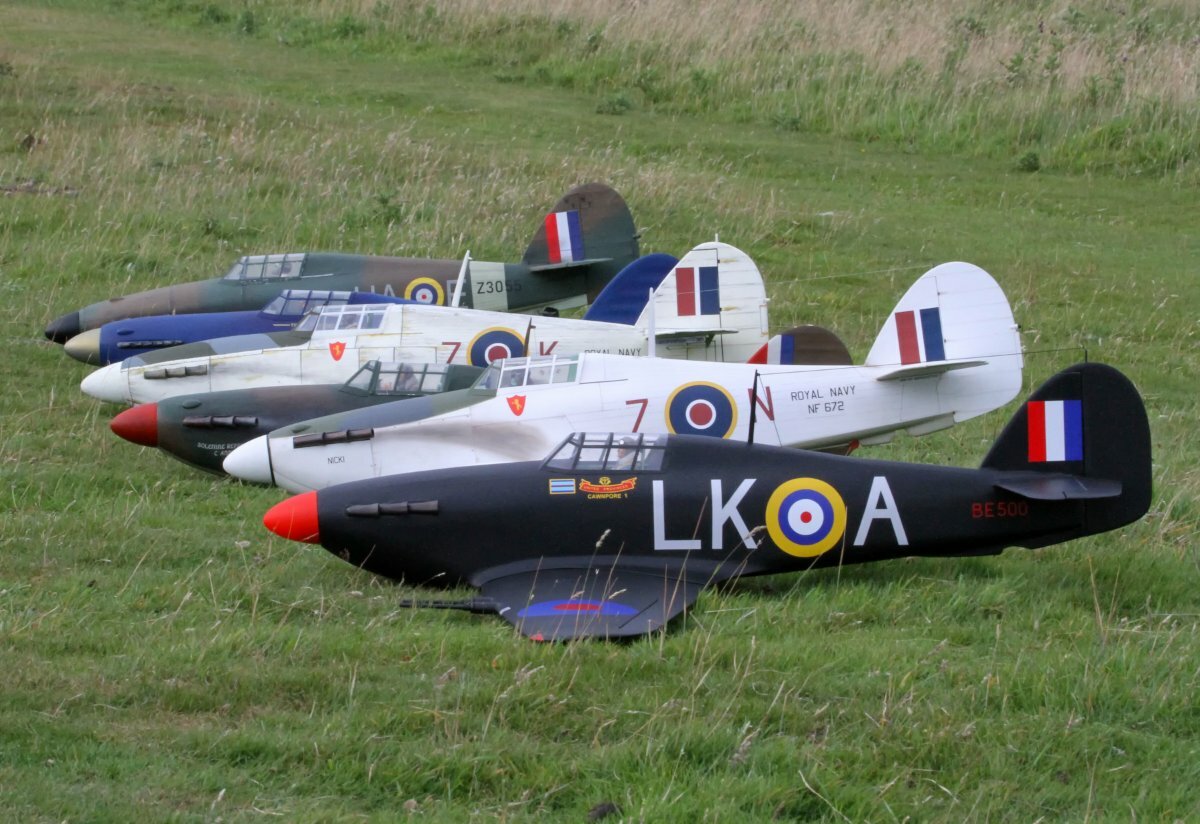

Phil Cooke Posted May 12 Author Share Posted May 12 6 Quote Link to comment Share on other sites More sharing options...
stu knowles Posted May 12 Share Posted May 12 A very nice line up of models. Amazing how a bit of weathering brings them to life 3 Quote Link to comment Share on other sites More sharing options...
