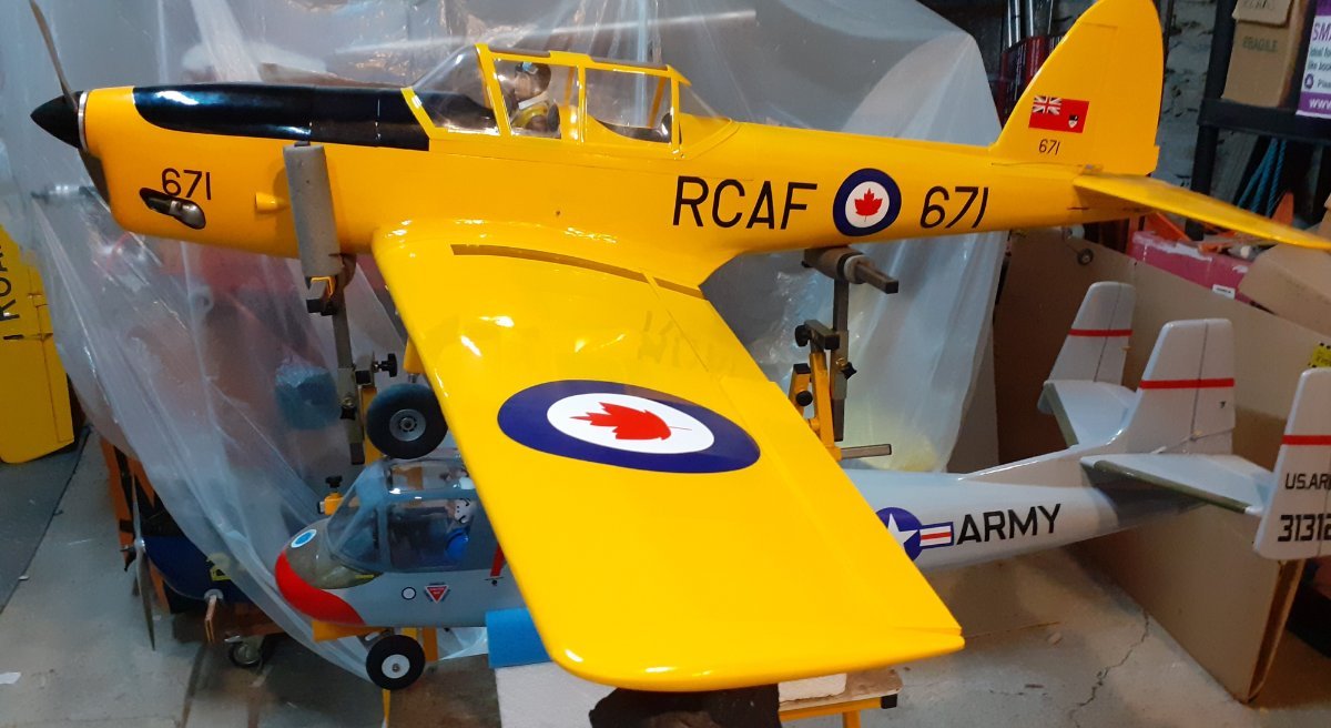

Making a few assumptions and informed estimates, the model is 1:5.15 scale and the full size tyres (600 x 6.5) around 19” diameter so the model’s wheels should be 3.7” diameter (and 1.25” wide).
Therefore 3.5” wheels would be a bit undersize and 3.75” a little oversize but not by much. However, I can’t find any tyre profile information so the actual size could be an inch or two smaller.
The one thing I can say with confidence is 4” are right out!
P.S. My 1/6 scale Airsail Chipmunk has 2.75” wheels which I assume were what was specified on the fairly accurate design for the scale kit (my plans are somewhere in the loft) which only equates to 16.5” diameter so the profile may be something like 85% as per traditional car tyres. Perhaps if you’re already using 3.5” wheels, stick with them for the time being?

The wheels in the kit are 3.25" which is why they look "too small" to my eye I guess. I do have some 3.75" Robart wheels but they are too narrow in cross-section to look "right". I'll have to look around for something.

Yes the wheels in that walk around do "look" bigger. It's surprising how small the wheel hubs actually are and how "chunky" the tyres look.
