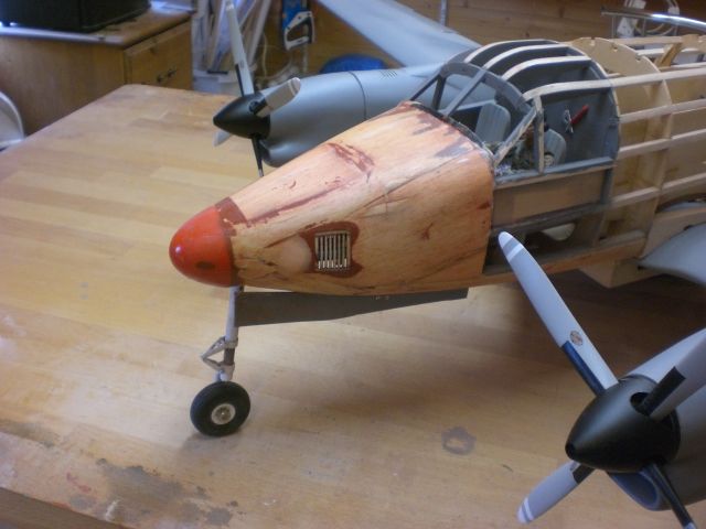

I've also spent some time installing the Grilles I made earlier into the nose.
It looks a bit rough at the moment but a coat of paint will work wonders.

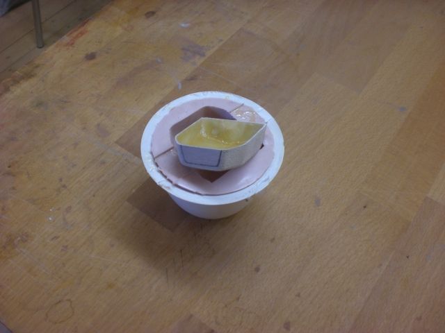

I've also been making the Engine Oil Cooler pods for under the nacelles.
They were made in the same way as earlier moldings. Balsa male mold > silicon female mold > fibre glass part.
Once the front and backs have been cut out they will be secured under the nacelles over a hole that will provide an additional exit for cooling air entering through the front scoop.
