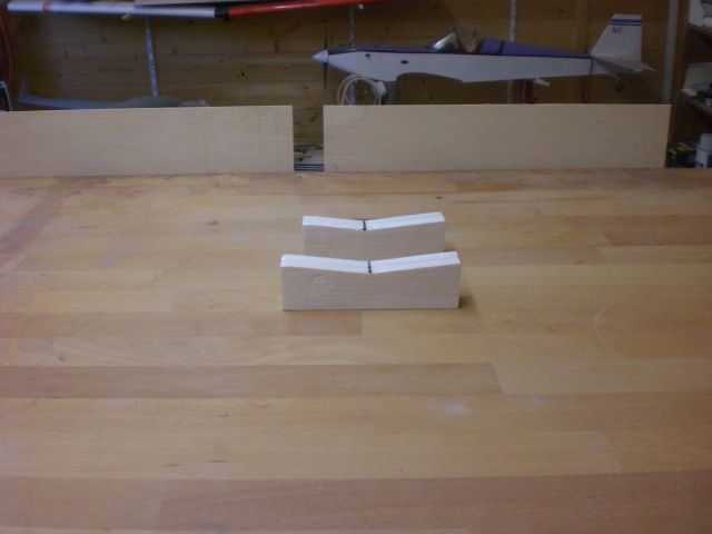

This is the first twin I've ever built, so I was worried about getting everything perfectly aligned, particularly the engines. To aid me I built a simple jig on my workbench. The two balsa blocks are held in place with double sided tape and are angled for the correct wing dihedral. The two liteply panels allow me to check that the x, y and z axis of the motors are identical.
Using the jig, the wing halves went together pretty easily - huge sigh of relief!

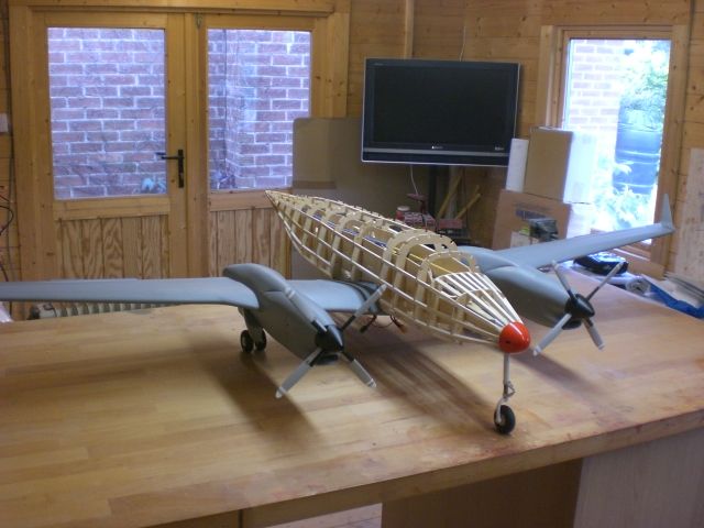

The wing has a 13.2 deg Dihedral so getting the main undercarriage at the correct angle was another concern. Having partially built the fuselage I was able to temporarily assemble the model and check the angles.
The retracts are all at the correct angle and at the correct height - another sigh of relief!
Note, the Red Nose has nothing to do with Comic Relief (although some might think my efforts are a joke!). I learnt a long time ago that I am incapable of sanding a dome shape, it always ends up lopsided and/or with unsightly flats. So, a few years ago, at the Nationals, I spied a box full of large spinners behind a vendor's counter. Most had bits missing or were too large for most customers. Long story short, I bought the entire box for £1 and now use them as aircraft noses, simply selecting the spinner with the correct profile and cutting off the portion I need.

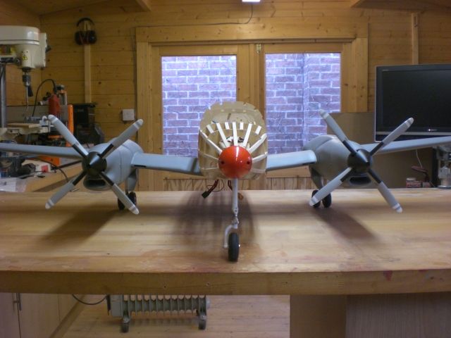

Now it's starting to look a bit more like an aircraft.

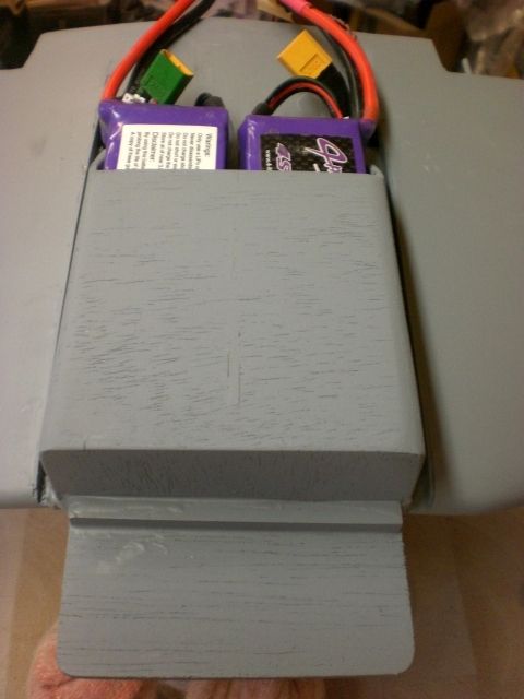

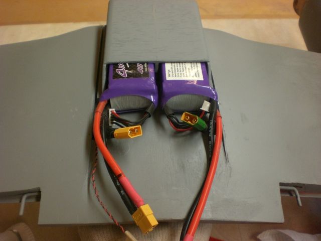

Having joined the wing halves, and verified all the relevant angles were correct, I have spent the last couple of days carefully modifying the underside of the wing to accept the battery box. It would have been easier to plan this in from the start, but as I said in an earlier post, I hadn't really got my head around battery placement when I started the build.
Anyway, I made a jig from scrap balsa block that maintained the correct dihedral and carefully cut away sections before replacing them with liteply. Once I had a plywood base, I was able to attach the battery box.
The small gap between the wing and the side of the box is for the 'Pod' cover. It slots in very neatly.
I have painted one of the ESC/UBEC connectors Green to remind me which one to connect first. The Green one powers the RX. The other black/red wire is for the lower anti-col located on the 'pod'.
The batteries slot in easily and will eventually be restrained by Velcro straps. I will install the straps after the final paint.
The 'ledge' at the front sits flush on the lower fuselage and will eventually house two wing securing bolts, the other two will be at the rear of the wing.

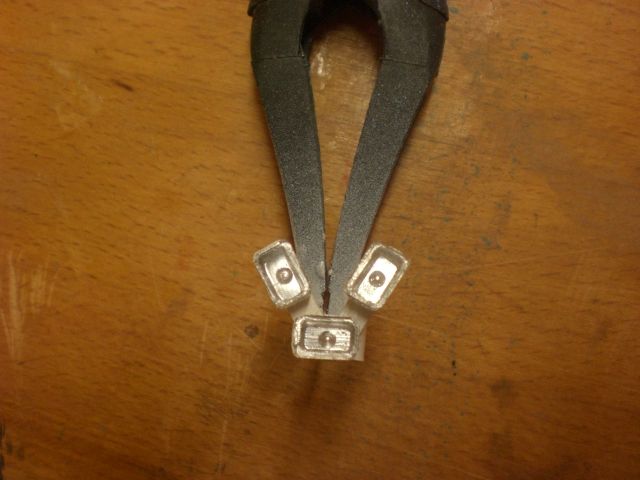

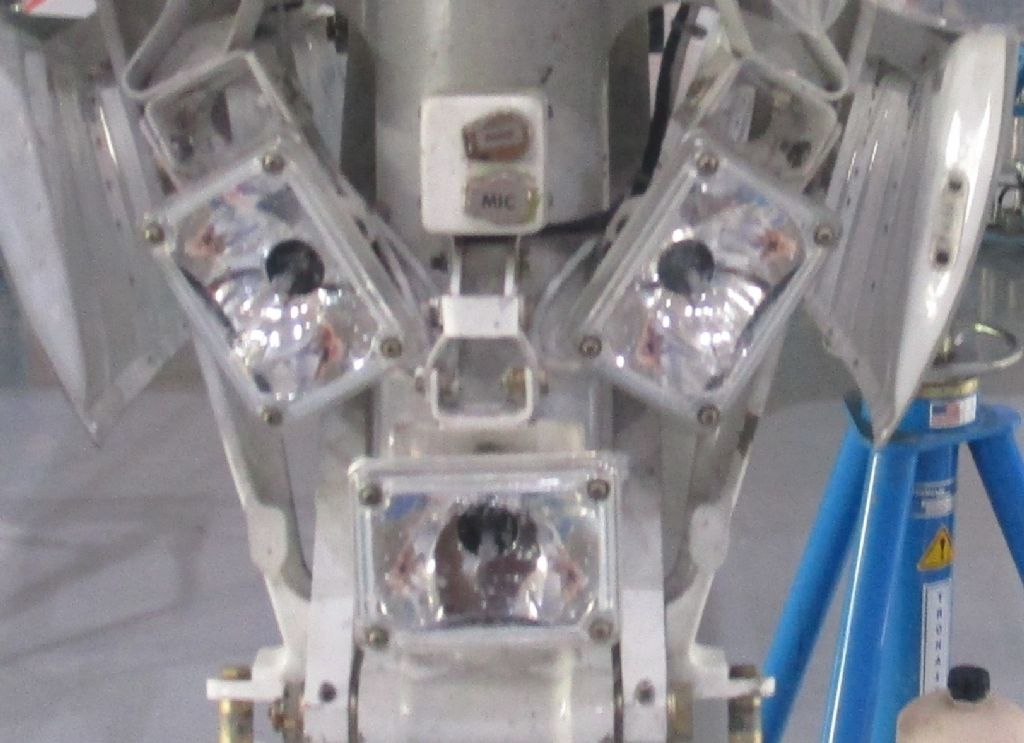

The real aircraft has lights mounted on the Nose Wheel.
The lighting kit I'm installing doesn't have enough outputs to install real lights, so I have made some dummy lights for effect.

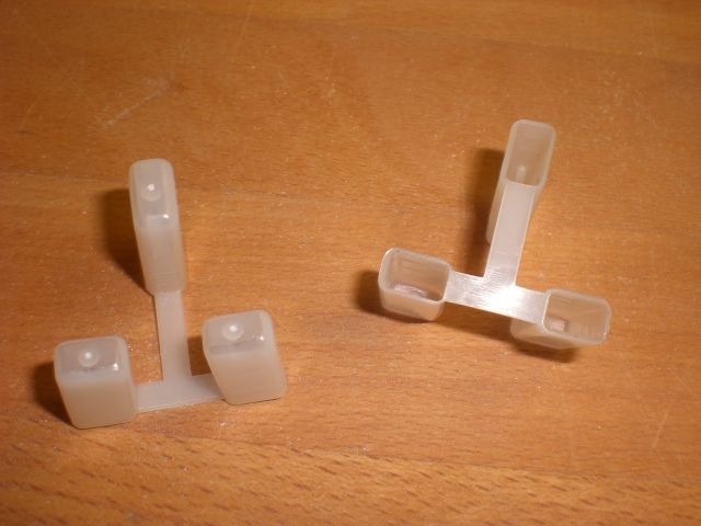

I habitually keep anything that might be of use for modelling and realised the tips of plug protectors were the perfect size for the lamp housings.
I cut the tips off the power pin protectors, sprayed the inside with chrome paint, the outside with white paint and glued some acetate to the front face. I made the support from some Litho Plate and glued the lamps to it. The assembly will eventually wrap around the Nose Leg and be clamped in place by a M2 bolt/nut.
Not perfect but the overall effect should be OK from a distance.

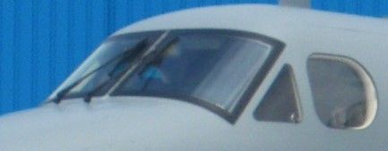

The real Cockpit has a split windscreen to the front and two small windows to each side.
Consequently the cockpit internals are not as visible as they would be on an aircraft with a bubble canopy. Even so, I have expended a little time and effort to give the impression of a King Air cockpit, although I haven't gone to the lengths of making 3D instruments.
The pilot is a 1/10th scale combat figure with the majority of the internal plastic removed. The only changes I had to make were to overpaint the US flag on his shoulder and manufacture a headset for him.
