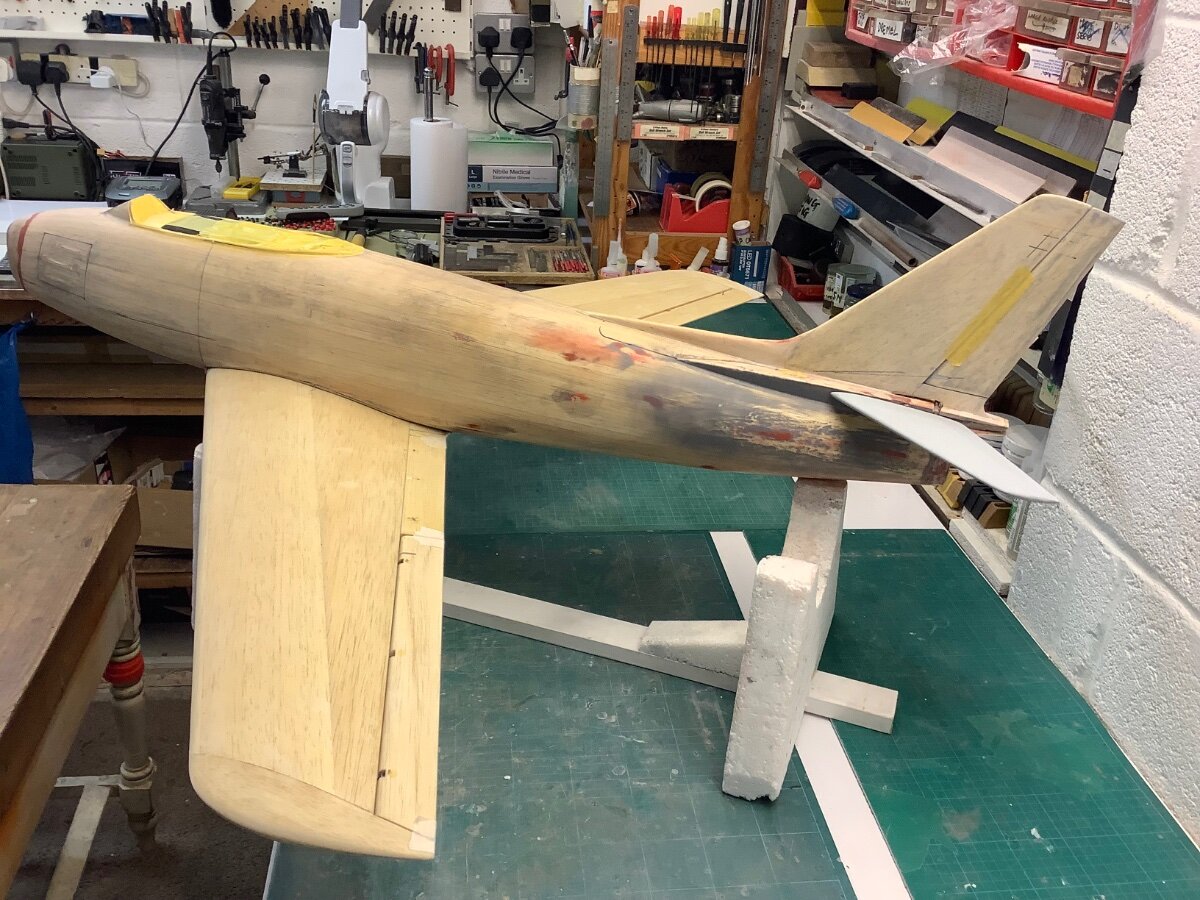

MikeQ Posted January 28, 2024 Author Share Posted January 28, 2024 (edited) Hi Wings glassed and fuse just about finished. Drop tanks glassed and given first prime and rub back. Just have to do the part I’m not looking forward to. Tail feathers and fairing. mike Edited January 28, 2024 by MikeQ 1 Quote Link to comment Share on other sites More sharing options...
MikeQ Posted March 3, 2024 Author Share Posted March 3, 2024 (edited) Hi Bit more work on Sabre. Just need to sort bending of the tail wires and complete and refine the fairing shapes etc. Shouldn’t be long before move on to glassing fuselage. mike PS Also need to sort tail pioe 😂 Edited March 3, 2024 by MikeQ 1 Quote Link to comment Share on other sites More sharing options...

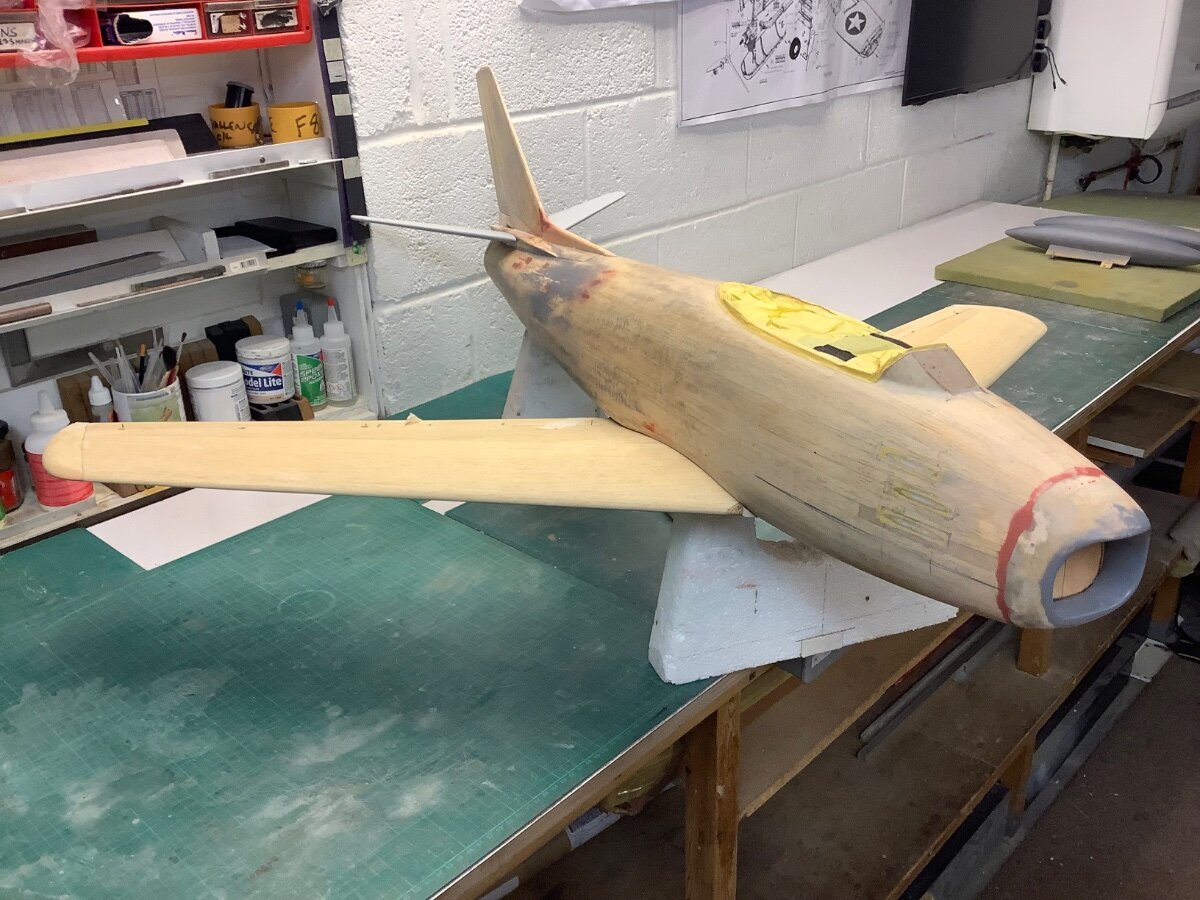

MikeQ Posted April 15, 2024 Author Share Posted April 15, 2024 Hi Lol, how come you can put a good bit of effort in and apparently make very little visible progress 😂. Anyway, servos all mounted and AMT working. Going with pull pull on rudder. Fuselage all closed up and wing belly pan finished and model sanded down. Just the tail pipe, gun ports and tail, wing fairings to sort. Will probably glass fuselage and fun/rudder separately before assembling and finishing up fairings all round. mike 4 Quote Link to comment Share on other sites More sharing options...

MikeQ Posted April 25, 2024 Author Share Posted April 25, 2024 Hi next up, glassing fuselage. Drew up and 3D printed a couple of jigs to allow me to ‘spit roast’ it. Will keep a track of the weights from here on in case anyone finds it useful, including me 😀 Gave it a coat of NonShrinkingDope mixed with microballons and sanded down to take the ‘fuzz’ off. Mike 1 Quote Link to comment Share on other sites More sharing options...
MikeQ Posted April 27, 2024 Author Share Posted April 27, 2024 (edited) Hi started fuselage. 1 side at a time. Peel Ply, 0,5oz glass and West Systems laminating resin. lol, £1.80 Resin and about £1.20 glass per side. Peel Ply takes more resin than finally needed as i like to totally wet out the PeelPly. Heat Gun helps the resin flow. Mike Edited April 27, 2024 by MikeQ 2 Quote Link to comment Share on other sites More sharing options...

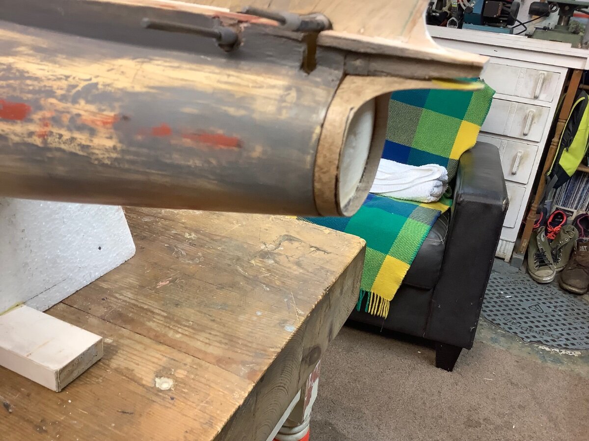

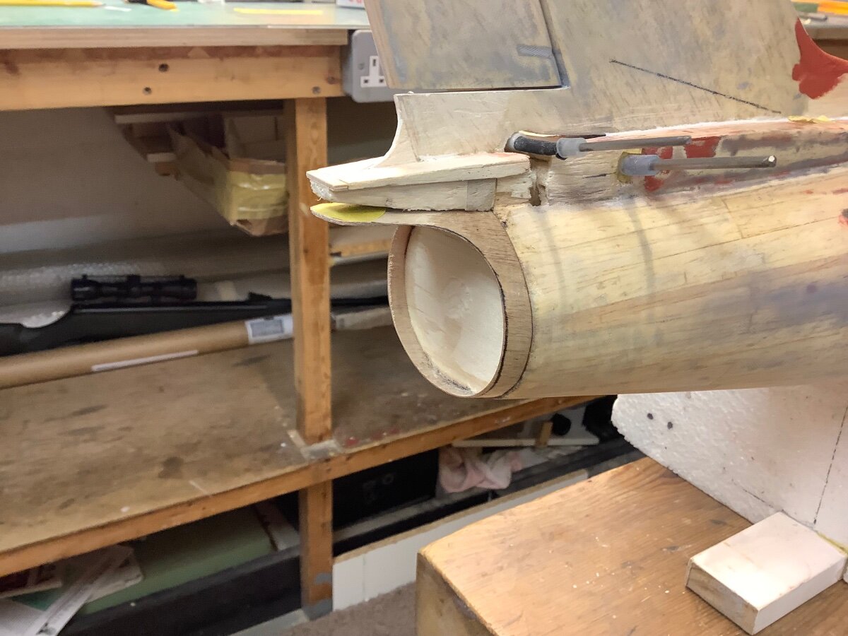

MikeQ Posted August 6, 2024 Author Share Posted August 6, 2024 (edited) Hello bit more progress on the Sabre, just a bit. All glassed up and priming. Sanded through in a spot or two but easy to fix with thick zap and some primer sanded back. Tail pipe was a bit of a faff but made it out of 1/64 ply. Not exactly scale but close enough. looks a bit rough in pics but ‘faired it in’ with laminating epoxy and micro balloons mix. Edited August 6, 2024 by MikeQ 3 Quote Link to comment Share on other sites More sharing options...

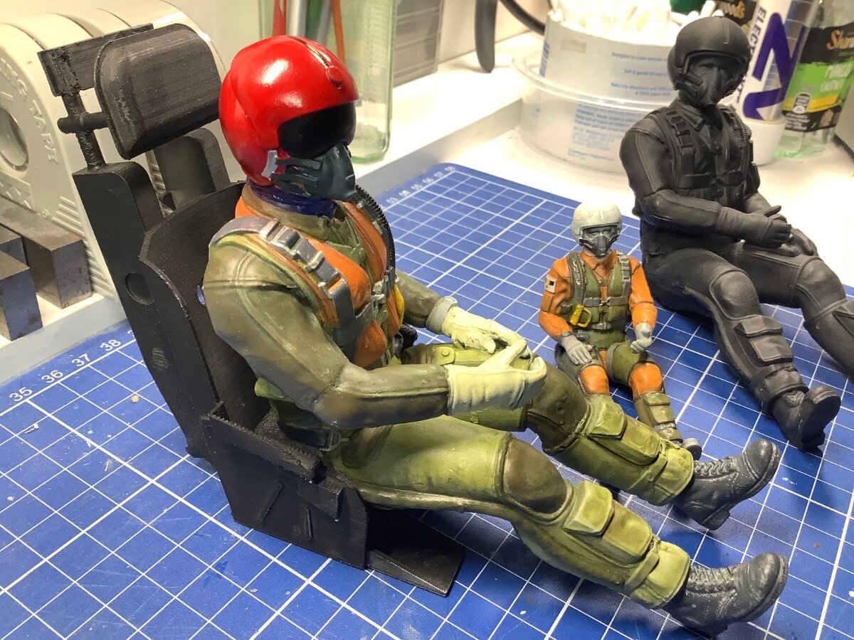

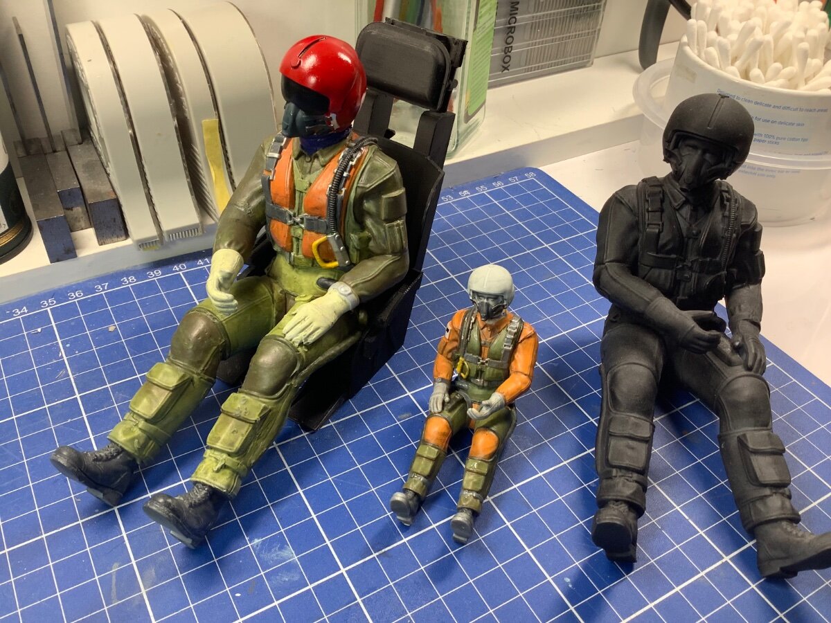

MikeQ Posted January 23 Author Share Posted January 23 Hello edging further forward a little bit. Been practicing painting pilots. Happy with this fella so far. Need a bit of glaze medium on visor and some decor on helmet and a bit of panel wash to finish off. This is just a test run. I’ll actually go for the colour scheme of the little orange chap. Better contrast in dark cockpits. Vallejo Youtube tutorials particularly useful. 5 Quote Link to comment Share on other sites More sharing options...

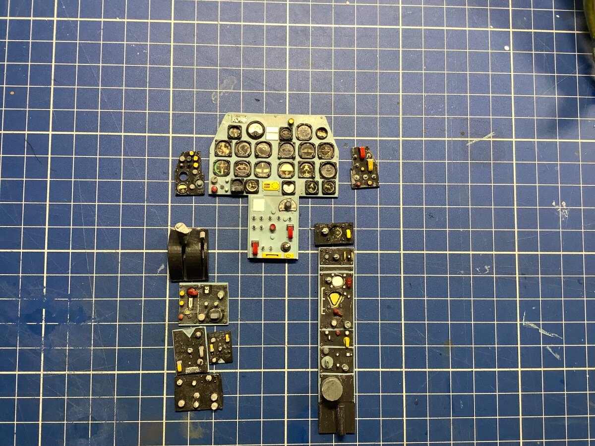

MikeQ Posted January 23 Author Share Posted January 23 Cockpit instruments mostly finished too. 6 Quote Link to comment Share on other sites More sharing options...
