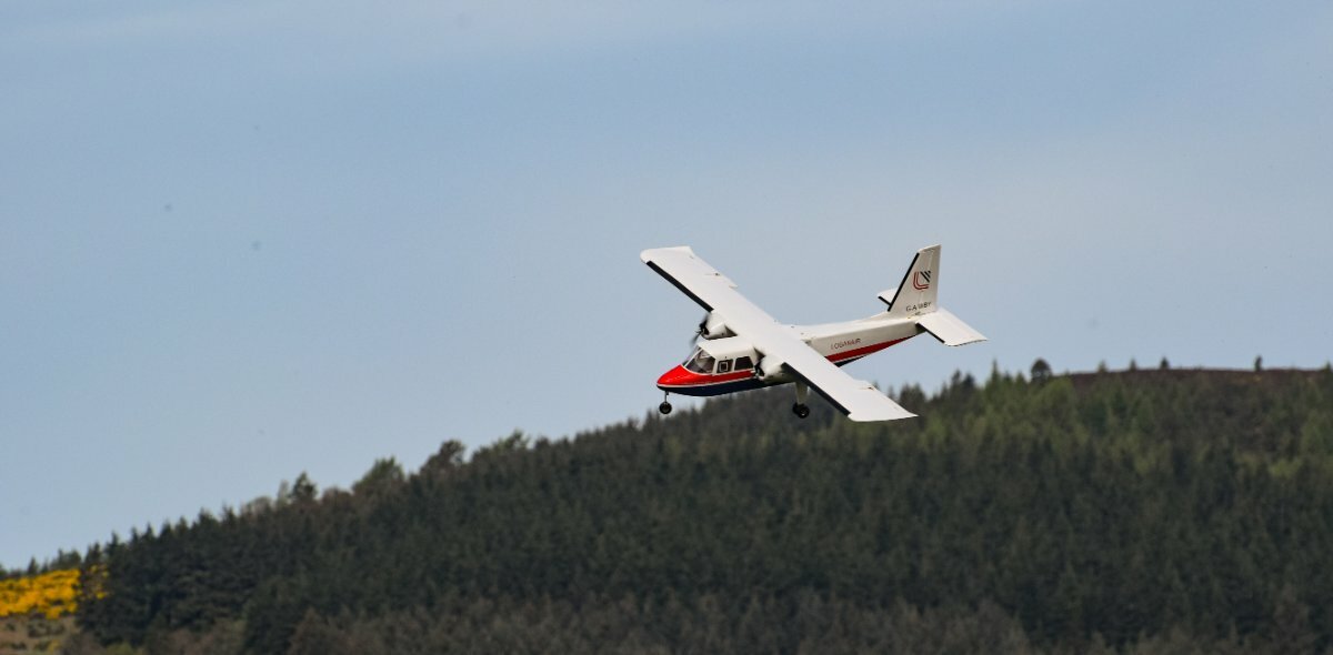

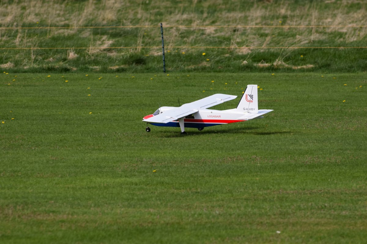

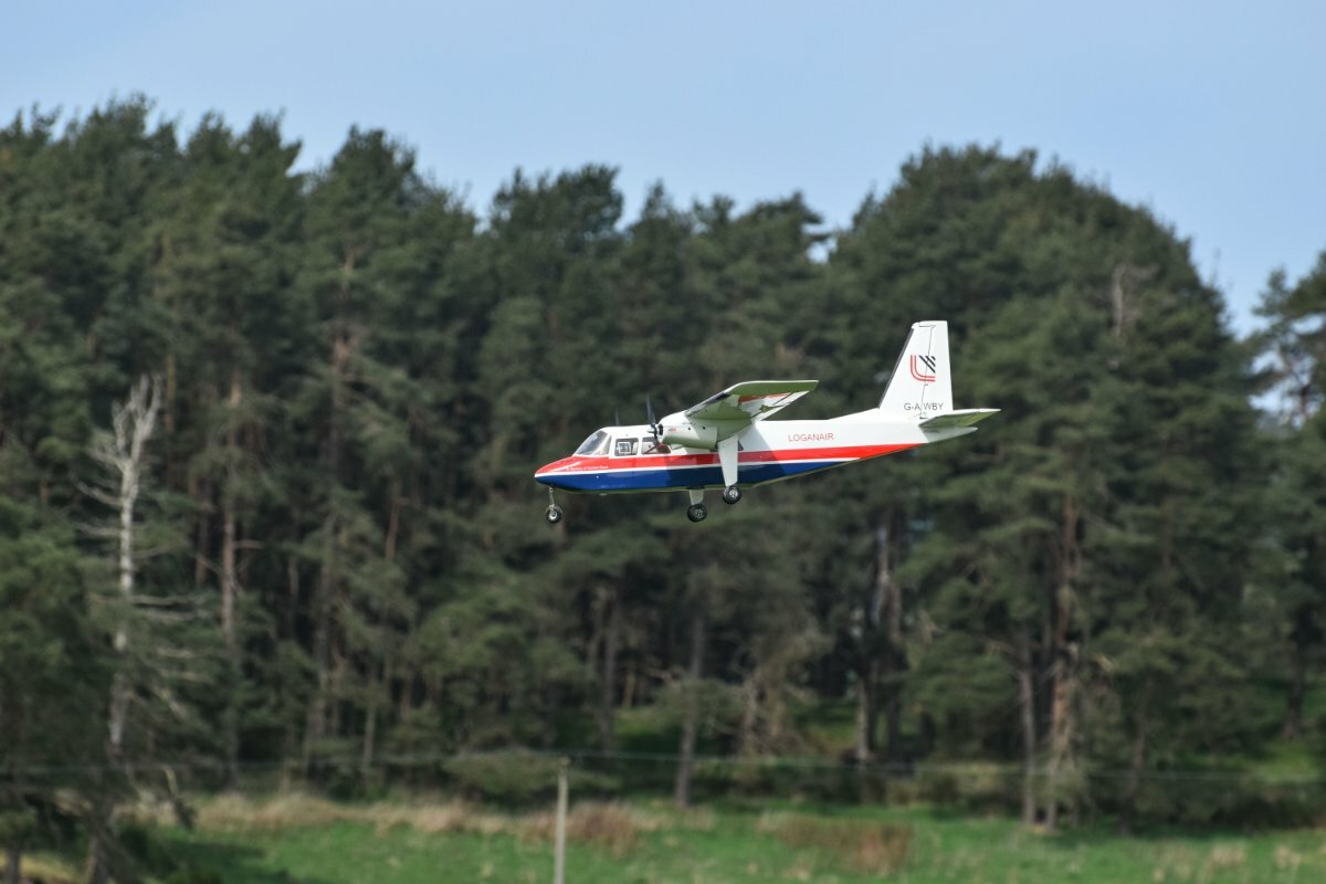

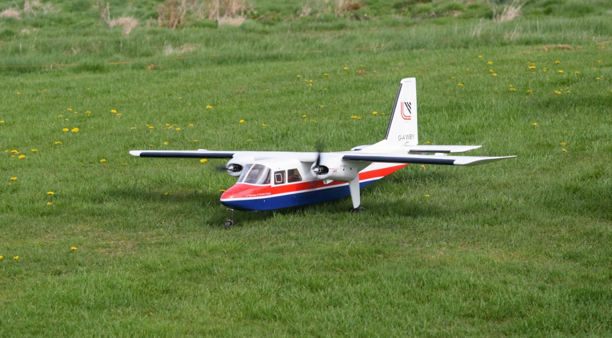

Murat Kece 1 Posted April 29 Author Share Posted April 29 Well finally, I had the maiden of My Islander. Here are some photos (Courtesy of Leccyflyer): 7 Quote Link to comment Share on other sites More sharing options...

Murat Kece 1 Posted April 29 Author Share Posted April 29 On 17/08/2024 at 06:53, James GB said: Mine flew! 😅 It actually flew very well indeed! The only issue I had was the angle of the horizontal stabilisor causes a lot of nose up pitch, it needed full downtrim to fly level. DSC09199.ARWUnavailable I had to give full down trim too as it kept pitching up. I will also move the CG slightly forward too. 1 Quote Link to comment Share on other sites More sharing options...

James GB Posted May 2 Share Posted May 2 On 29/04/2025 at 22:32, Murat Kece 1 said: I had to give full down trim too as it kept pitching up. I will also move the CG slightly forward too. I had the same issue, I think the angle of incidence of the stabalizer is quite negative. Looks like a great flight, well done! Quote Link to comment Share on other sites More sharing options...
