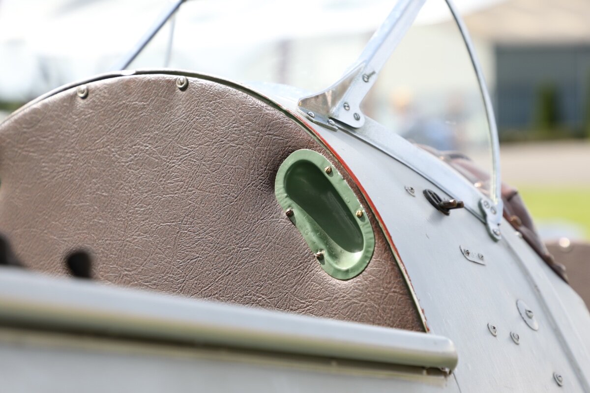

Richard Thornton 2 Posted June 10, 2024 Author Share Posted June 10, 2024 51 minutes ago, Ron Gray said: Can’t see the folds / creases in yours Richard 😉 A detail just too far, 😏 1 Quote Link to comment Share on other sites More sharing options...

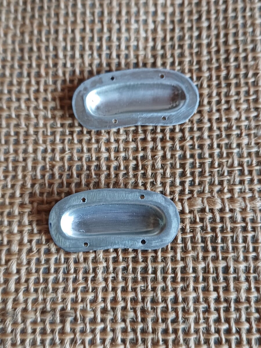

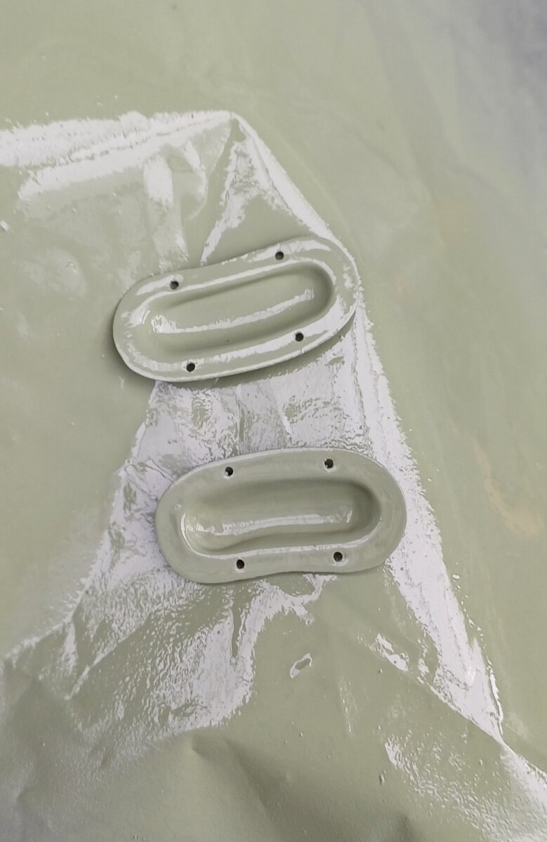

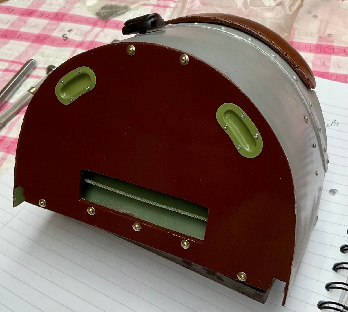

Richard Thornton 2 Posted June 13, 2024 Author Share Posted June 13, 2024 More distractions, why is it I can always find something else to fiddle with other than attach an issue that is giving me brain ache. They needed to be done and I guess that’s the answer to that but, I don’t know how to make the magneto switches….. Fwd cockpit hand holds, done. 1 Quote Link to comment Share on other sites More sharing options...
Manish Chandrayan Posted June 13, 2024 Share Posted June 13, 2024 Moulded/Cast? Quote Link to comment Share on other sites More sharing options...

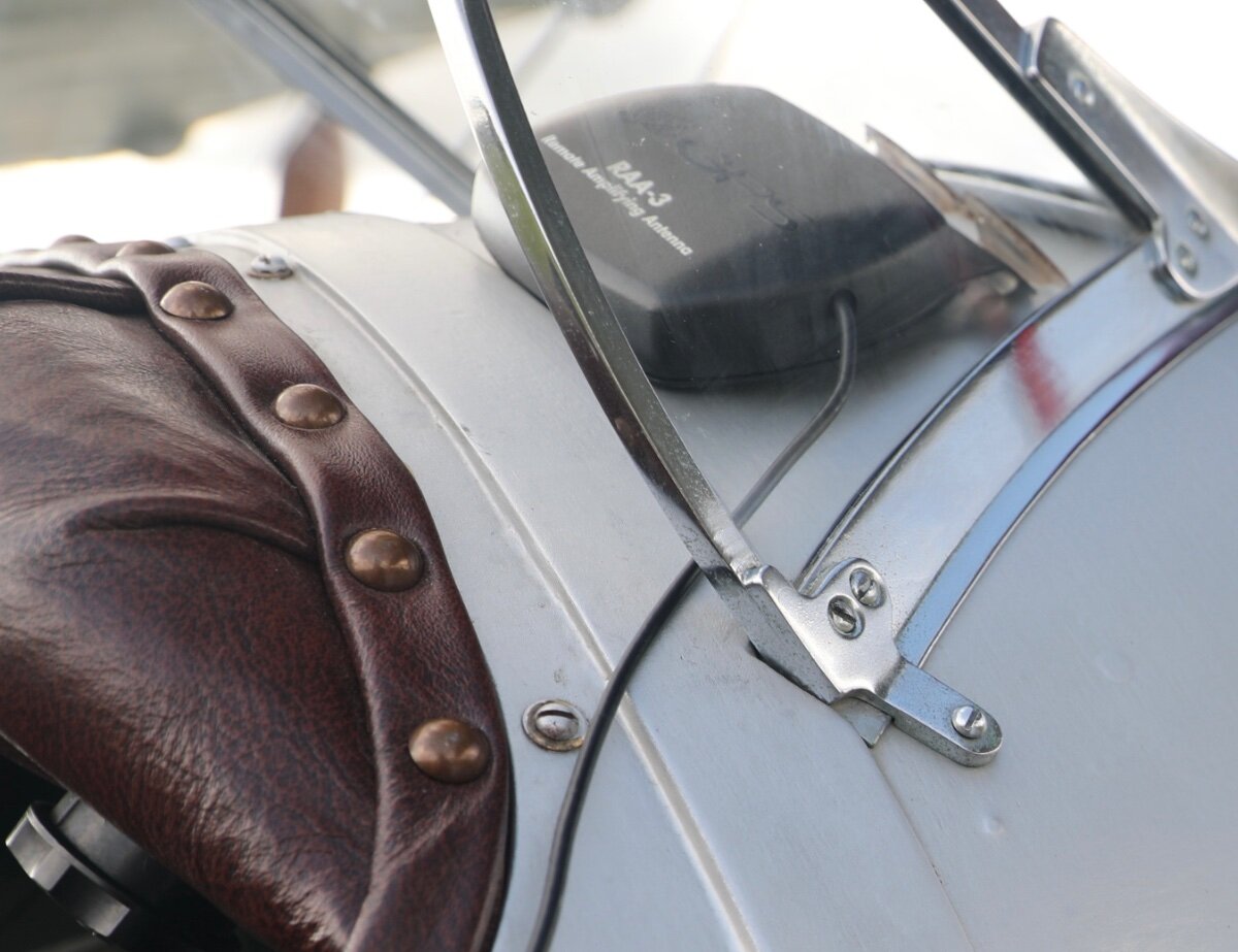

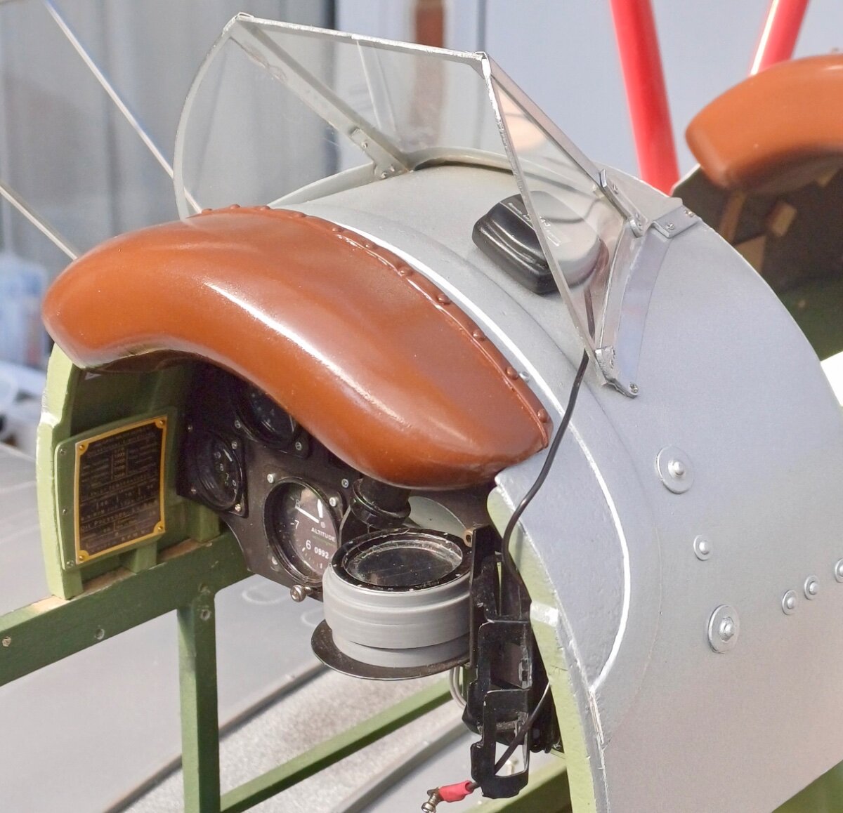

Richard Thornton 2 Posted June 13, 2024 Author Share Posted June 13, 2024 Also making an RAA-3 Remote Amplifying Antenna. I mention the model number as a photo online of an RAA-4 is easier to make…..typical 😩 Thats the little black box on the turtle deck. More white writing decals required. With regards the decal, I might try printing a black box with ‘white’ writing onto white decal paper. Hopefully this way the black prints the outline of the writing and leaves the white to show through as my printer doesn’t print white. Any thoughts? 1 Quote Link to comment Share on other sites More sharing options...
Richard Thornton 2 Posted June 13, 2024 Author Share Posted June 13, 2024 4 hours ago, Manish Chandrayan said: Moulded/Cast? I guess moulded. I cut out the holes in the firewall and after annealing some really thin litho plate, rubbed the area with the handle of a paintbrush until I couldn’t get it any further into the cutout. Easier than I thought. Cutting the excess off proved to be the difficult bit as the plate was so soft. Quote Link to comment Share on other sites More sharing options...

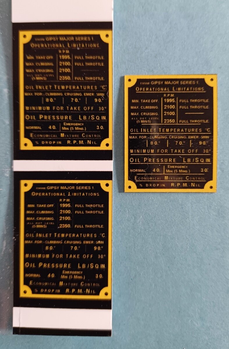

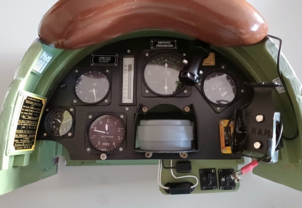

Richard Thornton 2 Posted June 16, 2024 Author Share Posted June 16, 2024 More distractions but this needed to be done. 1/4 scale Gipsy Engine signage for the rear cockpit. Once I have bought the decal paper I am going to have many hours of ‘fun’ getting all these to look just right. Quote Link to comment Share on other sites More sharing options...

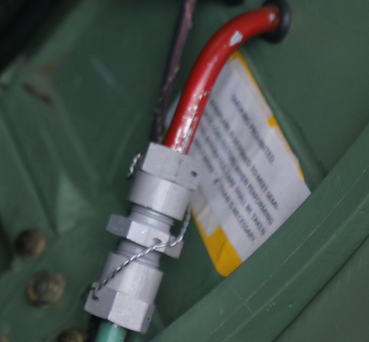

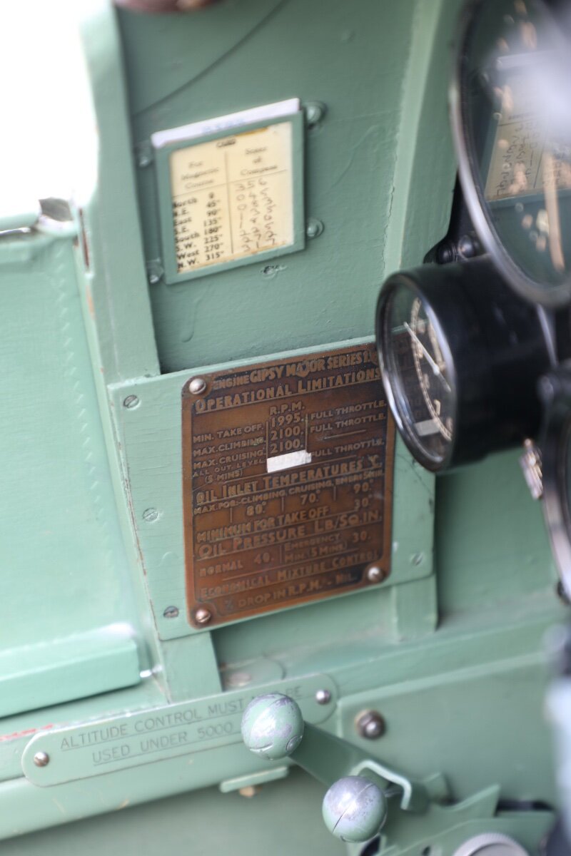

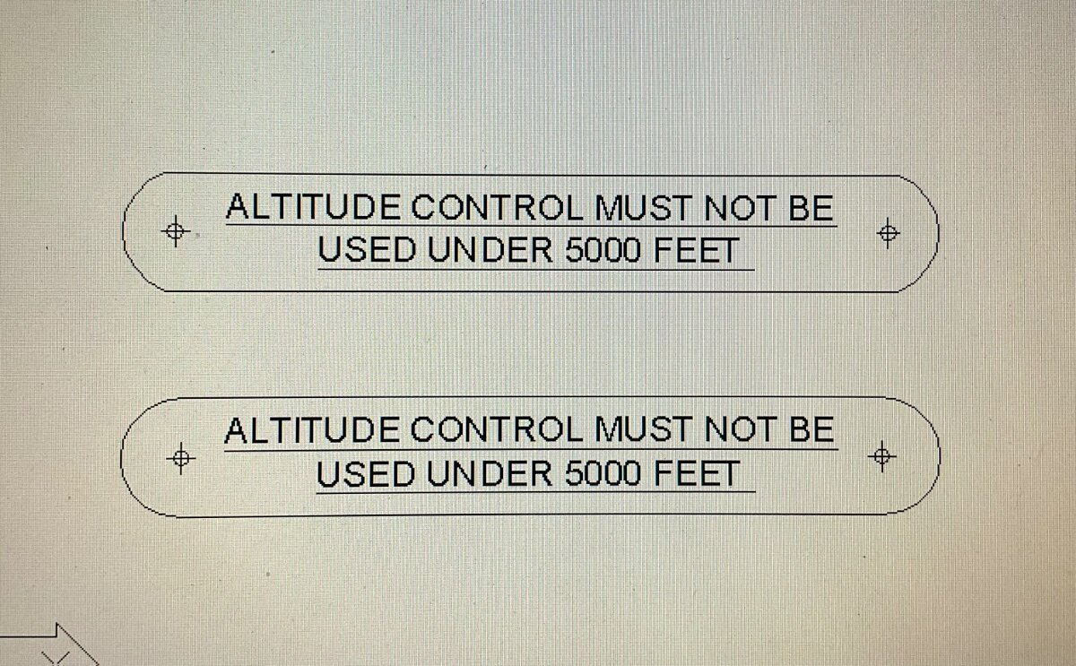

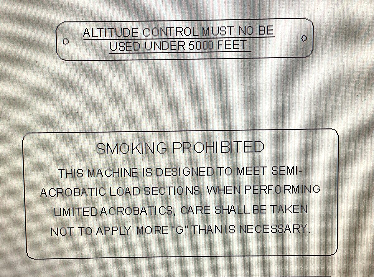

Richard Thornton 2 Posted June 16, 2024 Author Share Posted June 16, 2024 More cockpit signage. I am not convinced the wording is correct on the lower label, any thoughts? Quote Link to comment Share on other sites More sharing options...

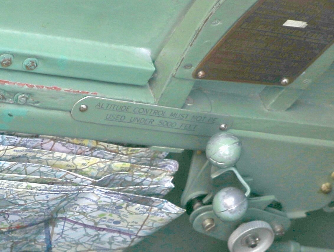

RottenRow Posted June 16, 2024 Share Posted June 16, 2024 Richard, The signage varies between different aircraft, so to be accurate you would have to look at the particular one that you are modelling. From the couple of pictures I have of these signs, the top one is almost right (NO should read NOT, and the ends are more rounded). It is bare aluminium coloured. The bottom one is similar; the word SECTIONS reads FACTORS, and LIMITED reads PERMITTED. Also ACROBATICS reads AEROBATICS. The SMOKING PROHIBITED wording isn't on the same sign, and all of the wording is in three lines, not four, with the breaks after LOAD and CARE. This sign is mounted directly above the compass, and is white with a thin black border around the wording. Brian. 1 Quote Link to comment Share on other sites More sharing options...
Richard Thornton 2 Posted June 17, 2024 Author Share Posted June 17, 2024 12 hours ago, RottenRow said: Richard, The signage varies between different aircraft, so to be accurate you would have to look at the particular one that you are modelling. From the couple of pictures I have of these signs, the top one is almost right (NO should read NOT, and the ends are more rounded). It is bare aluminium coloured. The bottom one is similar; the word SECTIONS reads FACTORS, and LIMITED reads PERMITTED. Also ACROBATICS reads AEROBATICS. The SMOKING PROHIBITED wording isn't on the same sign, and all of the wording is in three lines, not four, with the breaks after LOAD and CARE. This sign is mounted directly above the compass, and is white with a thin black border around the wording. Brian. Very many thank Brian. I have been amazed just how different every aircraft is. Each one is fitted with various adaptations and customisations dependant on the airframe, owner and country where flown. But that wording in paragraph 3 makes far more sense than what I have interpreted from the photos I have. Really appreciate your help. Quote Link to comment Share on other sites More sharing options...
Richard Thornton 2 Posted June 17, 2024 Author Share Posted June 17, 2024 25 minutes ago, Richard Thornton 2 said: Very many thank Brian. I have been amazed just how different every aircraft is. Each one is fitted with various adaptations and customisations dependant on the airframe, owner and country where flown. But that wording in paragraph 3 makes far more sense than what I have interpreted from the photos I have. Really appreciate your help. Much better and now I can see my typo too. Quote Link to comment Share on other sites More sharing options...
Richard Thornton 2 Posted June 17, 2024 Author Share Posted June 17, 2024 Thanks Brian. This now reads better and makes far more sense. This label is printed on an Avery type label and stuck to the fuselage side in both the fwd and aft cockpits on this particular aircraft. I have taken loads of photos but as always, the aircraft is in full sun and the cockpits are not. This airframe has an extra fuel tank located snuggly in the fwd cockpit! 😳 Quote Link to comment Share on other sites More sharing options...
RottenRow Posted June 17, 2024 Share Posted June 17, 2024 Hi Richard, Yes clearly a fairly recent addition. and stuck on where a space could be found. That label can only be a couple of inches high, so at quarter scale half an inch or so. I don't think anyone will be reading it! That's assuming that it can be printed at that size. Even the youngest Tiger Moths are now in their eighties, and will have seen a lot of changes over those years; probably numerous owners, several rebuilds and modifications. Some have likely been rebuilt from the remains of several others. There probably aren't two that are alike now. There would have been differences from new as well, with them being built at different locations and even in different countries. Brian. Quote Link to comment Share on other sites More sharing options...
leccyflyer Posted June 17, 2024 Share Posted June 17, 2024 15 hours ago, Richard Thornton 2 said: More distractions but this needed to be done. 1/4 scale Gipsy Engine signage for the rear cockpit. Once I have bought the decal paper I am going to have many hours of ‘fun’ getting all these to look just right. For those sort of printed aluminium type data plates I've found the most effective way to reproduce them at small scale is to print the black onto transparent acetate overhead projector sheet with a laser print - mono is fine - and then paint the rear of the label with aluminium, brass or gold coloured paint. Quote Link to comment Share on other sites More sharing options...
leccyflyer Posted June 17, 2024 Share Posted June 17, 2024 (edited) On 13/06/2024 at 13:00, Richard Thornton 2 said: Also making an RAA-3 Remote Amplifying Antenna. I mention the model number as a photo online of an RAA-4 is easier to make…..typical 😩 Thats the little black box on the turtle deck. More white writing decals required. With regards the decal, I might try printing a black box with ‘white’ writing onto white decal paper. Hopefully this way the black prints the outline of the writing and leaves the white to show through as my printer doesn’t print white. Any thoughts? For home produced white writing you can't beat the Alps thermal wax transfer printers, which will print in white or metallic colours as well as normal print. Waterslide decals printed on an Alps printer using clear paper will give a nice result. The printers have been discontinued for some years, but there is an active self-help group and a small number of enthusiasts using the technology, especially with regards to small scale railway modelling, where the ability to print tiny 6pt white lettering is perfect for their small rolling stock. There is also a very old technique using Letraset dry transfer rub-on lettering, where it is possible, using Letraset solvent, to generate coloured letters, or if you have lettering of a suitable font and style in manufacturer- supplied white letters that can be used with care. https://alps.groups.io/g/ALPS/topics That's the ALPS printer goup. Edited June 17, 2024 by leccyflyer Added URL Quote Link to comment Share on other sites More sharing options...
Richard Thornton 2 Posted June 17, 2024 Author Share Posted June 17, 2024 5 hours ago, RottenRow said: Hi Richard, Yes clearly a fairly recent addition. and stuck on where a space could be found. That label can only be a couple of inches high, so at quarter scale half an inch or so. I don't think anyone will be reading it! That's assuming that it can be printed at that size. Even the youngest Tiger Moths are now in their eighties, and will have seen a lot of changes over those years; probably numerous owners, several rebuilds and modifications. Some have likely been rebuilt from the remains of several others. There probably aren't two that are alike now. There would have been differences from new as well, with them being built at different locations and even in different countries. Brian. I think that everything you have said is actually what I have got out of actually modelling a specific airframe. There is the history and stories of where this aircraft flew and where it’s been on its travel. The owner told me he purchased the airframe from a gliding club in Cape Town, being used as spares to keep another Moth in the air. Quote Link to comment Share on other sites More sharing options...
Richard Thornton 2 Posted June 17, 2024 Author Share Posted June 17, 2024 5 hours ago, leccyflyer said: For home produced white writing you can't beat the Alps thermal wax transfer printers, which will print in white or metallic colours as well as normal print. Waterslide decals printed on an Alps printer using clear paper will give a nice result. The printers have been discontinued for some years, but there is an active self-help group and a small number of enthusiasts using the technology, especially with regards to small scale railway modelling, where the ability to print tiny 6pt white lettering is perfect for their small rolling stock. There is also a very old technique using Letraset dry transfer rub-on lettering, where it is possible, using Letraset solvent, to generate coloured letters, or if you have lettering of a suitable font and style in manufacturer- supplied white letters that can be used with care. https://alps.groups.io/g/ALPS/topics That's the ALPS printer goup. Thanks for the info there LF. More homework to do 😩 Quote Link to comment Share on other sites More sharing options...

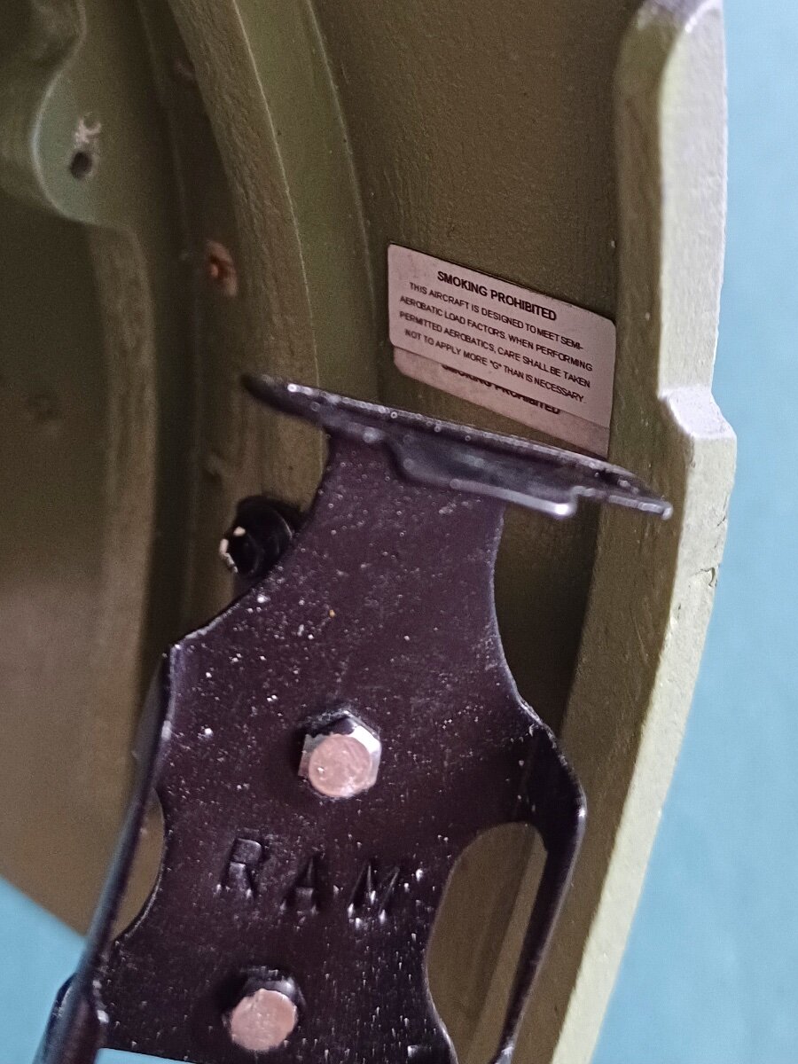

Richard Thornton 2 Posted June 21, 2024 Author Share Posted June 21, 2024 No Smoking sign sorted and is correct as confirmed by the Owner of the full size. Printed off 3 just in case, I now have 2 spare Gipsy Major signs … 3 1 Quote Link to comment Share on other sites More sharing options...

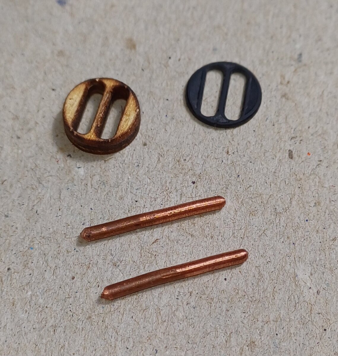

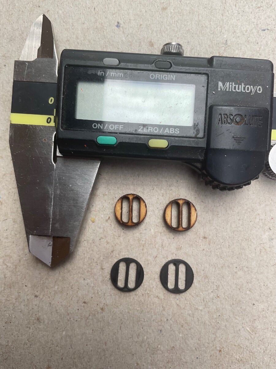

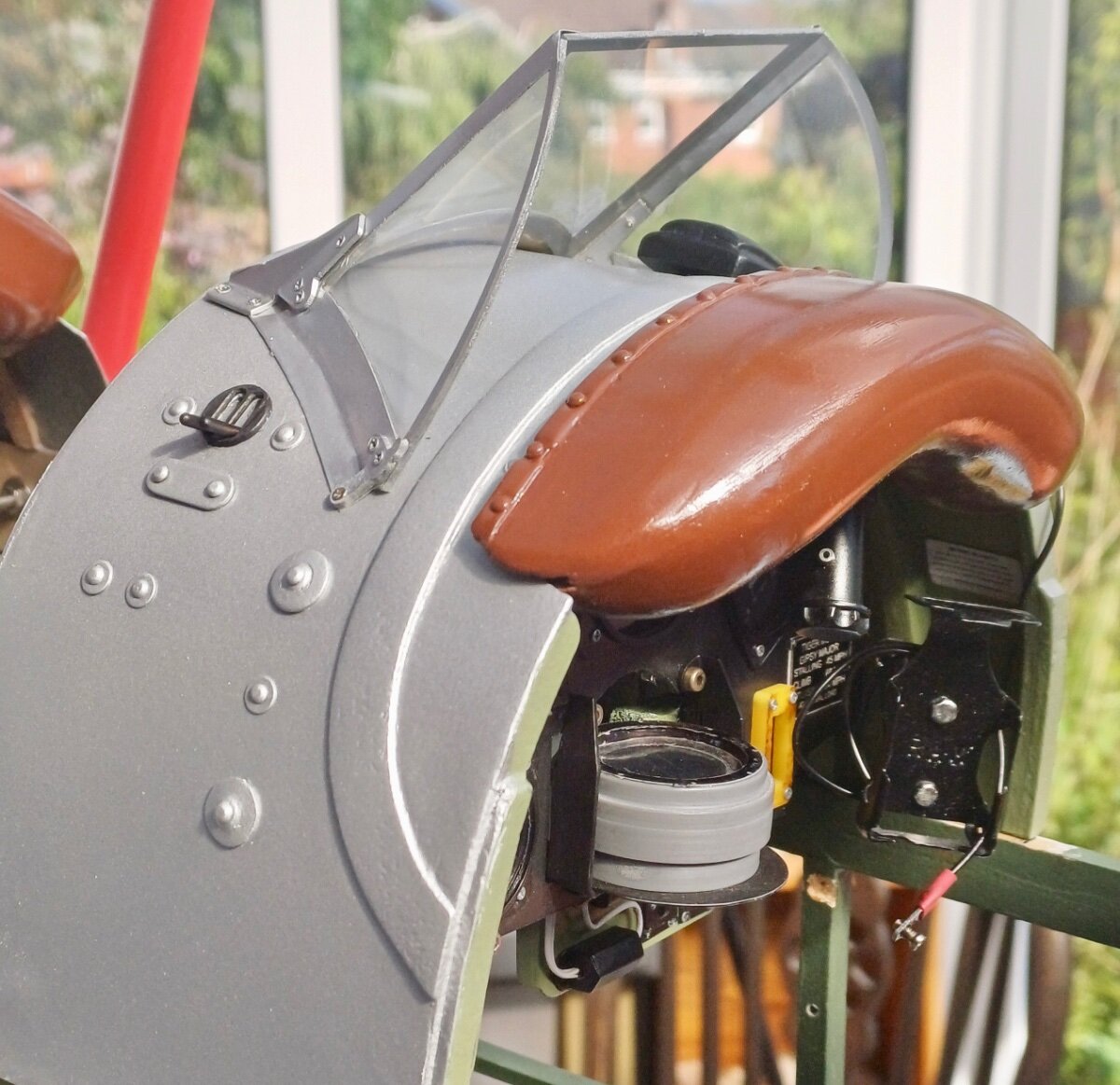

Richard Thornton 2 Posted June 26, 2024 Author Share Posted June 26, 2024 Look what arrived from Jim Reeves.! Fantastic service as I was really struggling with cutting the 2 x parallel 2mm holes. Jim cut a black 0.7mm front plate and a 3mm ply backing plate. He also cut a 1mm clear plate but I didn’t use that. The levers are 2mm copper wire from standard household 240v electrical wire with the outer covers removed. Jim has advised that he wants to add this ‘kit’ to his website. Hope my installation does his work justice. Quote Link to comment Share on other sites More sharing options...

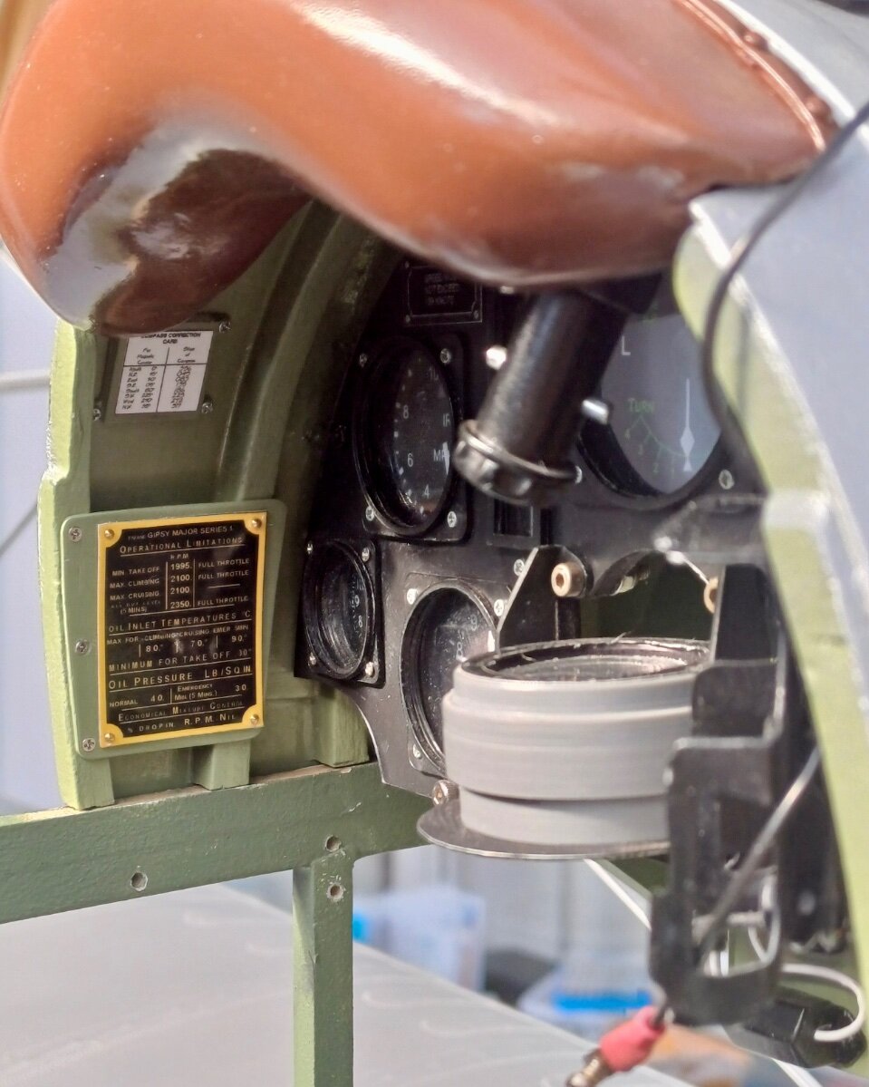

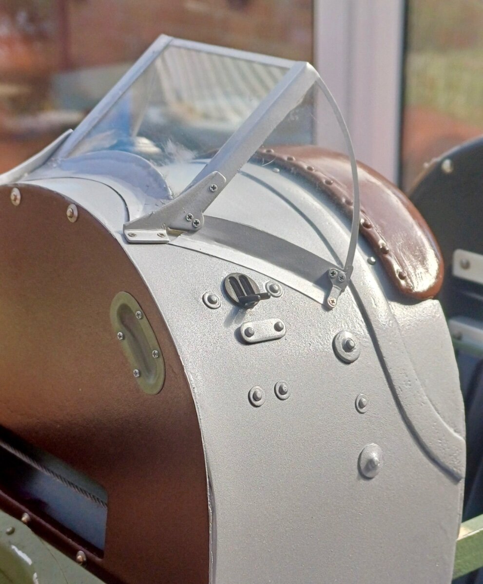

Richard Thornton 2 Posted June 26, 2024 Author Share Posted June 26, 2024 Well that’s finally the rear cockpit turtle deck, dashboard and bits done. 2 Quote Link to comment Share on other sites More sharing options...
Richard Thornton 2 Posted June 26, 2024 Author Share Posted June 26, 2024 This Tigermoth has some unusual fittings, an RAF WW2 cockpit light, switches for wingtip flares and navigation lights and then a satnav ! 4 Quote Link to comment Share on other sites More sharing options...
jim reeves Posted June 26, 2024 Share Posted June 26, 2024 Marvelous work and attention to detail, happy to help with the laser cutting. jim. 1 Quote Link to comment Share on other sites More sharing options...
