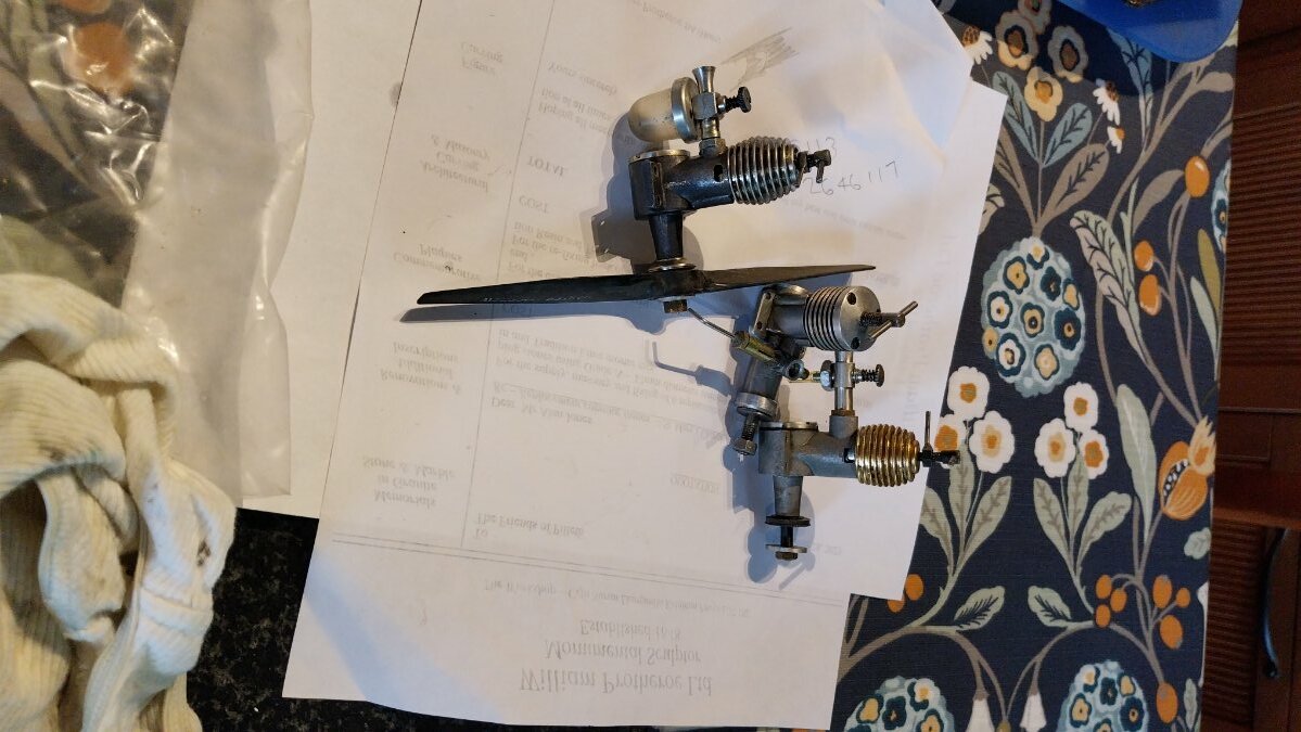

Jonathan Posted June 13, 2024 Share Posted June 13, 2024 On the home straight with my latest build diamond demon, first time electric. Sorting out my old engines for my next build, The Answer by cumbrian models. Last used the 25 years ago, I put them away cleaned and oiled, just ordered some fuel, quite a bit more expensive than last time haha. Looking forward to starting them up. Will probably use the original Mills .75 , it was a sweet little engine I remember. 6 Quote Link to comment Share on other sites More sharing options...
Rich Griff Posted June 13, 2024 Share Posted June 13, 2024 May I ask please, what oil did you use and are they still free turning, other than compression of course ? Quote Link to comment Share on other sites More sharing options...
Jonathan Posted June 13, 2024 Author Share Posted June 13, 2024 Yep I used Model Technics After Run Oil, they all turn over nicely, still going to give them a clean before starting Quote Link to comment Share on other sites More sharing options...

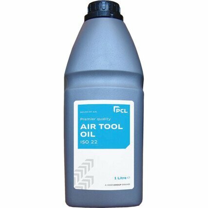

Nigel R Posted June 13, 2024 Share Posted June 13, 2024 I used to use ATF but it can contain a fair amount of sulfur which isn't a great thing. Air tool oil is a better option and is pretty cheap. Quote Link to comment Share on other sites More sharing options...
GaryW Posted June 13, 2024 Share Posted June 13, 2024 I use this air tool oil in all my engines Glow & Diesel https://www.screwfix.com/p/pcl-iso22-air-tool-oil-1ltr/568hy 1 Quote Link to comment Share on other sites More sharing options...
Jonathan Posted June 13, 2024 Author Share Posted June 13, 2024 The 2 Mills engine's in my photo show my original one my dad bought me in the late 60s the other one I purchased in 1992 a India replica, after a couple of fights and a bit of a crash landing the prop shaft got bent, the shaft was slightly smaller in diameter than the original and possible not as good quality metal, monkey metal springs to mind haha, fortunately my dad turned me a new shaft for it , overhauling the complete engine even though it was new. I will be using the original engine in my next build. Quote Link to comment Share on other sites More sharing options...
