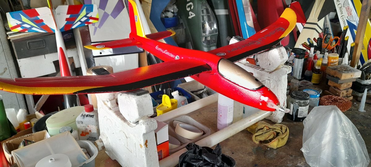

Engine Doctor Posted January 18 Share Posted January 18 (edited) A 2012 2000 kv with a 6x3 running on a 3s will easily match / out perform a Cox. I use a 2750 KV with a 6x3 on a 1m span glider wnd vertical performsnce is outstandind. Pow is from a 1200 mah 3s . I get 15 to 20 min flight times easily as max power is only used for climout. Lms sell motors for around £15 but can be found on the net for around £4 If you can wait for delivery. Pic below model is light as it all foamwith carbon reinforning your glider will tame it some but thrust is far greater than a cox. Edited January 18 by Engine Doctor Quote Link to comment Share on other sites More sharing options...
