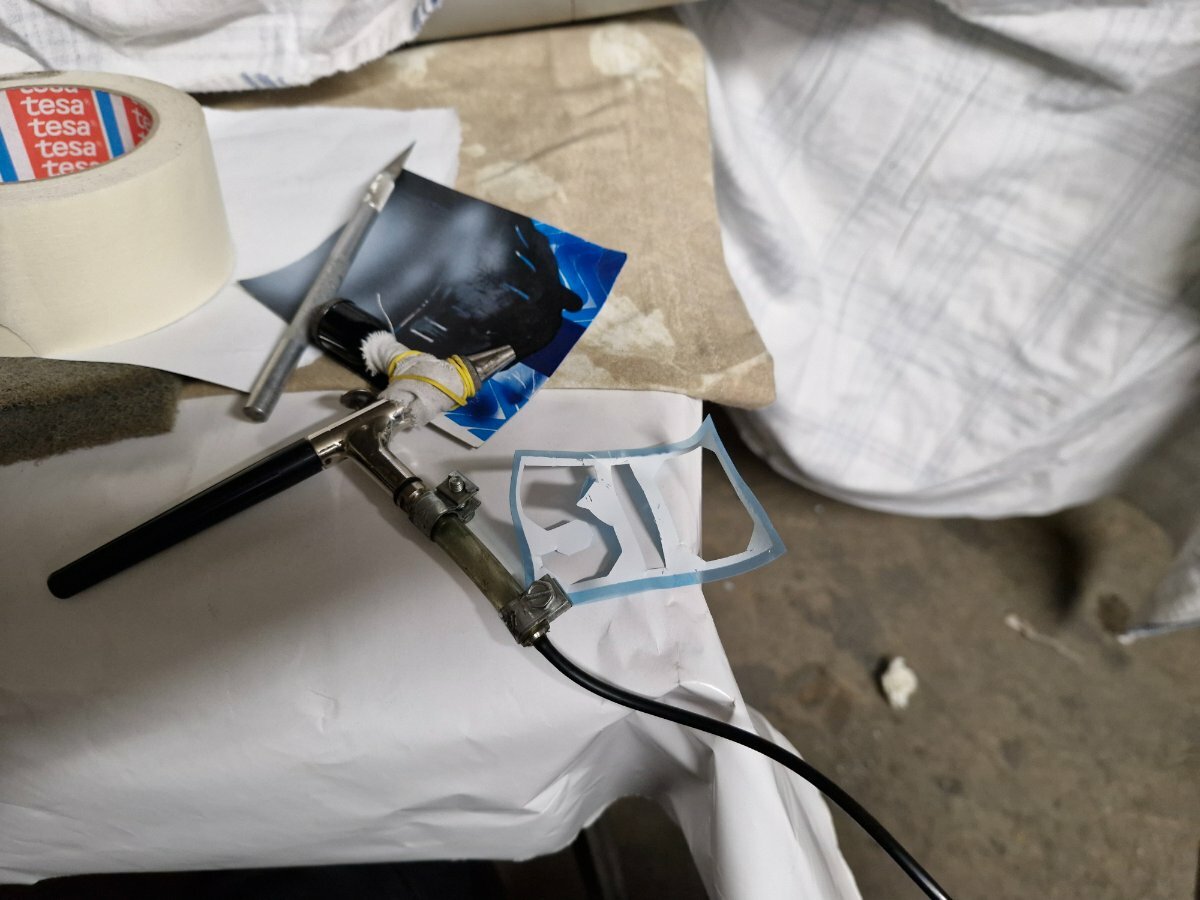

I'm having problems painting decals on my fouga magister (building blog in the electric ducted fan section )
Sinds my decals were ruined (protective paper sticking) i had some paint masks made by a friend. I'm trying to use them now on my fresh painted surface.
I placed the mask in the right position , masked the rest with paper against overspray and painted the decal with VALLEJO model paint.(water based acilic ).
When finished and after 10min waiting i tried to pull away the mask and the paint of the decal came off like it formed a skin together with the paint on the mask !
Can anyone tell me what went wrong ?
Schould i wait longer to peel off the mask ? Wrong paint ?
Any help is very appreciated  ! Thanks , Dirk

Hi all,
Thanks for the input !
I tried again this evening after giving the base a light sanding (the base is water based varnish ).
Took away the mask direct after spraying the paint , so far so good ! Many more to go !
Thanks again !
