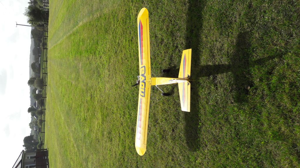

Niall Reynolds Posted September 24, 2017 Author Share Posted September 24, 2017 Spent the day flying this girl Quote Link to comment Share on other sites More sharing options...

Jonathan M Posted September 25, 2017 Share Posted September 25, 2017 Niall First decide on what model, then choose the right engine for it. If it is, for example, the Acrowot ARTF, then you'll need the IC pack (rather than the electric pack) to complete it, which includes fuel tank, engine mount with screws, spinner and complete throttle linkage. Everything else for the basic airframe and control-linkages is already in the box. You'll also need radio tx and rx, 5 servos, battery, switch, plus the usual assortment of adhesives (e.g. thin CA for the hinges), fuel-proofer, etc. The most useful thing you can do is first read the PDF instructions for the Acrowot ARTF, available (as is the rest of the spec and requirements) on this page: **LINK** Jon PS What was that model you were flying at the weekend, and what engine? Quote Link to comment Share on other sites More sharing options...
Niall Reynolds Posted September 25, 2017 Author Share Posted September 25, 2017 It was a ripmax nova 40 with an irvine 46 engine. Have bought an os max 55ax and I am buying the acro wot in a few weeks!! Quote Link to comment Share on other sites More sharing options...
