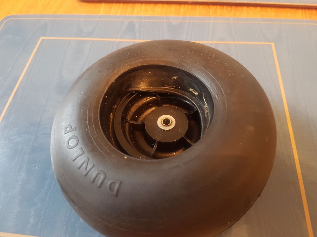

Nick Somerville Posted May 21, 2020 Share Posted May 21, 2020 Which wheels did you use, Steve? Quote Link to comment Share on other sites More sharing options...

Steve Dunne Posted May 22, 2020 Author Share Posted May 22, 2020 Nick, the wheels are Sarik Hobbies DH82 quarter scale wheels - very nice scale wheels, I sanded off the DH logo and painted SV instead. I glued the hub halves together, but obviously did not do a very good job on gluing the tyres on! They are now glued on with thin cyano. Next time... Martin, maybe I have that to come! The breaks were acually in the brass fittings at the end of the wires - one 2mm threaded rod quicklink fitting and one 3mm ring connector for the cabane strut stays. Weak points!?!. Jon, I take your point on the flying speed, which is plenty enough for circuit flying. Once I start aerobatics, however, the aircraft seems to put the brakes on heavily - loops only just get over the top and rolls are "very interesting" once the plane is inverted. Far too much drag in biplanes! The smaller prop seems to give enough power to overcome these problems, and then I only have to worry about my own inadequacies... I am trying to get to the stage where I can replicate some of the displays that the full size Stampes give, but given that the model is quite porky (a bit like me!) I may have to compromise. Maybe I'll build the next one with a much lighter rear end. Steve. Quote Link to comment Share on other sites More sharing options...
Nick Somerville Posted May 22, 2020 Share Posted May 22, 2020 Have the same wheels on mine Steve. Lost a wheel on landing the other day, though not the tyre coming off. I had used parts of the stock 8swg main UC wire for the axle to crucifix connection. Trouble was that the axle after passing through the enlarged hole at the bottom of the H King oleos were nit long enough to pass all the way through the hubs. I extended the axle with tight fitting brass tube and then epoxied a pan headed 4m bolt into the tube to support the little bit of hollow tube and keep the wheel on. Anyway I have had two failures as it seems to be a woefully flawed solution. Just bought a length of 4mm piano wire and will make up the axle to crucifix as I should have done in the first place. Will glue tyres to hubs whilst about it. I started with a 18x8 and now the engine has had enough running have changed to a 20x6. Rolls fine with a touch of down when inverted and a little opposite rudder in the final stage. Haven’t done consecutive rolls yet though as still very rusty on the sticks. Quote Link to comment Share on other sites More sharing options...

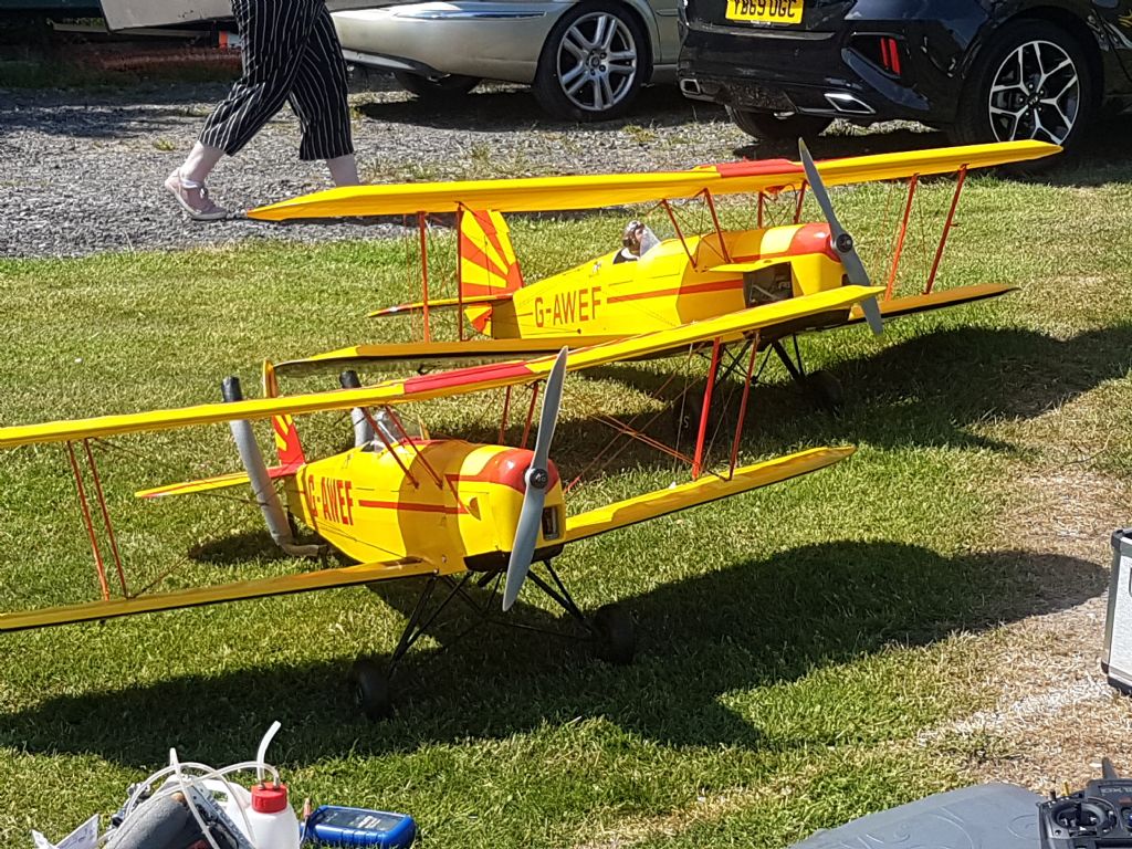

Steve Dunne Posted May 26, 2020 Author Share Posted May 26, 2020 Yesterday I tried an 18x6 APC wide prop - 8100 revs and even better flying the than Graupner 18x6. It would have been a wonderful day except for a sloppy landing. The approach was too high, I cut the revs too much and bounced it. Minor bend in the U/c - I blame very soft piano wire . I flew both the new 1/4 SLEC/Precedent Stampe, and the 30+ year-old Svenson Stampe - same colours. Steve. Quote Link to comment Share on other sites More sharing options...

martin collins 1 Posted May 26, 2020 Share Posted May 26, 2020 Interesting that you flew both makes of 1/4 scale Stampe Steve, what were your impressions of the two compared? How do they come out weight wise with one another? Quote Link to comment Share on other sites More sharing options...

Steve Dunne Posted May 26, 2020 Author Share Posted May 26, 2020 Martin, The Svenson Stampe (foreground) is 1/5 scale, not 1/4. It flies on an OS91fs, with a 15x6 prop. It was built over 30 years ago, so getting a little stiff and creaky (like me!). The two Stampes are remarkably similar to fly, and caused no little confusion yesterday when I flew both (not at the same time, we have to observe social distancing...). The old Svenson 1/5 scale weighs 9lb 2oz, the SLEC 1/4 scale weighs 18lb 2oz. I haven't yet decided which I prefer to fly, but the 1/5 Svenson is far easier to get up to and down from my loft workshop, up the ladder and through the small loft trapdoor.... Steve. Quote Link to comment Share on other sites More sharing options...
