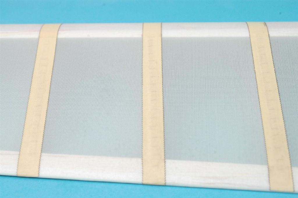

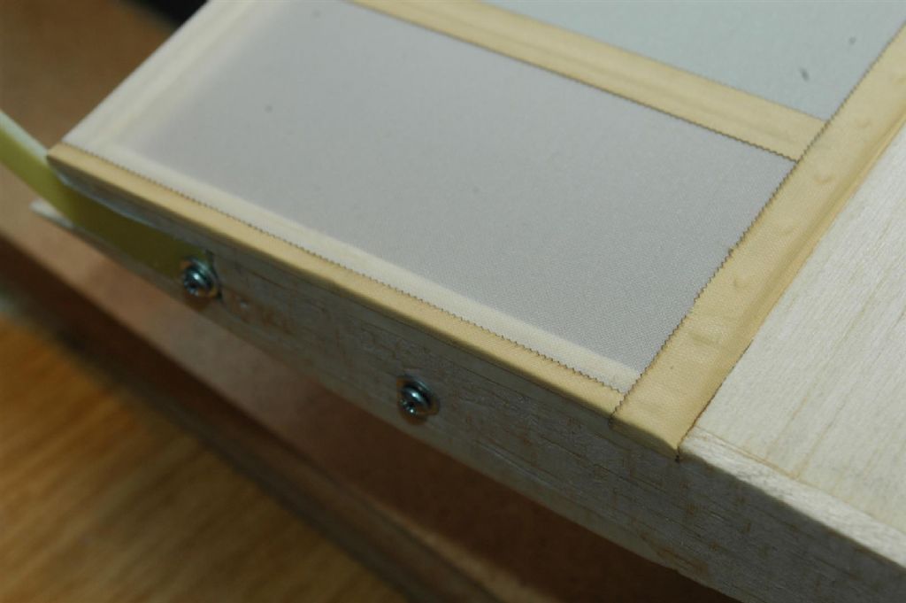

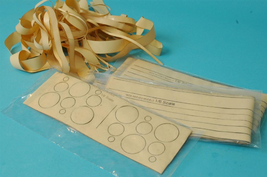

Danny Fenton Posted December 22, 2014 Author Share Posted December 22, 2014 Still waiting for the other side of the fin to harden so..... Rib tapes: The 1/6 rib tapes I am using are from Mick Reeves and are available in lots of different scales. First of all after studying the pics, the tapes along the tops of the ribs are applied first, then the leading edge and root tape. This tape also has to have the underlying screw heads. Then finally the trailing edge tap is applied. I have run out of time just now to do the trailing edges but you get the idea. This is the contents of a single rib tape pack First of all large glue dots were used to simulate the screw heads underneath the fabric where it meets the leading edge. These are done with RC Modellers glue, though with hindsight epoxy drop with a toothpick might have given us a more sturdy lump. The problem with RCModellers glue is that it flattens and melts under the heat of the film iron Tapes along the ribs first Then the leading edge, being very careful to not iron the glue dots flat! The trailing edge still needs doing but you get the idea This shot of the tip shows the chamfered channel the the tape is sitting in. For the leading edge strip I used the double width tape cut in half lengthways. That put the striaght edge in the channel. Some thin CA will go in their just to make sure it doesn't come adrift. The tip rib tape is the normal width tape cut in half lengthways, two tips from one strip. You get a lot in a pack from Mick, but no sense wasting it Cheers Danny Quote Link to comment Share on other sites More sharing options...

john stones 1 - Moderator Posted December 31, 2014 Share Posted December 31, 2014 As you say it's hard to see I would think the paint job would make it more visible though. Have you ever tried pinking shears for cutting rib tapes Danny ? would it work or would the edges look wrong ? John Quote Link to comment Share on other sites More sharing options...
Danny Fenton Posted December 31, 2014 Author Share Posted December 31, 2014 Hi John the problem is finding pinking shears at the right scale. I have bought a few and none have been anywhere near small enough. Mick Reeves doesn't charge a lot for his pinked tapes and the scale is correct, just as easy to buy them imo I have just checked my pics and there should only be 5 stitches from the front to the back of the flaps, I have done way too many. As they are so difficult to see I will keep going on this flap and correct the spacing on the rest. Kills time while waiting for epoxy to set at least Cheers Danny Quote Link to comment Share on other sites More sharing options...

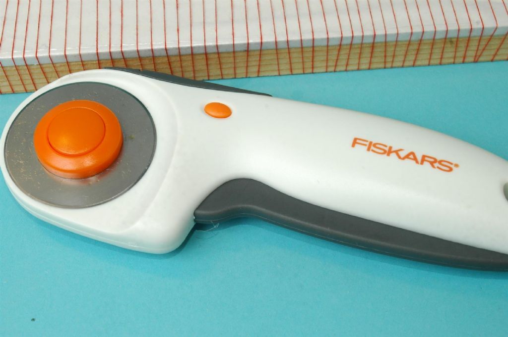

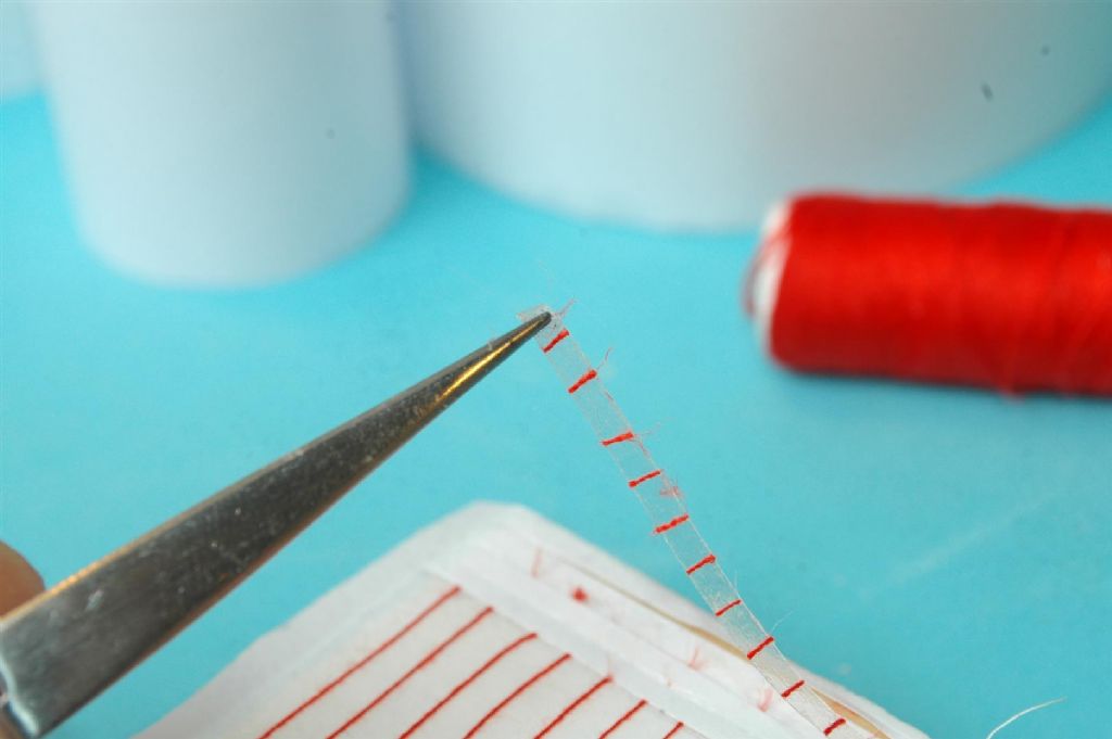

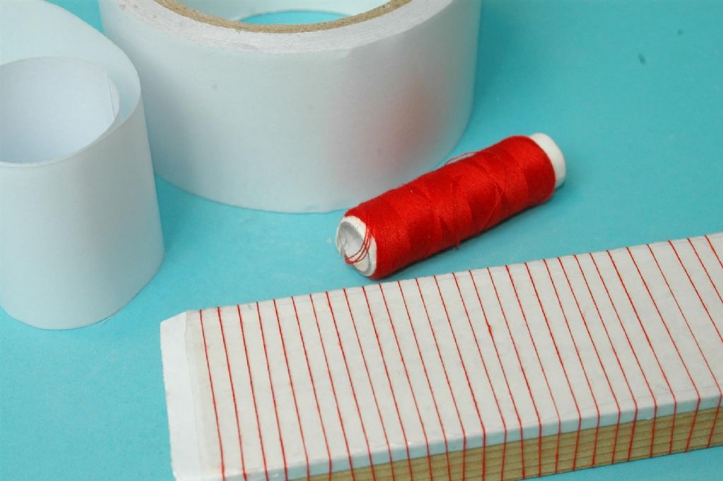

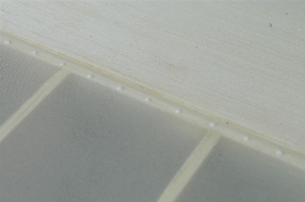

Danny Fenton Posted January 2, 2015 Author Share Posted January 2, 2015 Just realised I haven't shown how I am doing this, perhaps another video is called for If you dont want a "scale Matters" spolier look away now......... I must just say that this method was shown to me by ace scale modeller Richard Crapp, thanks Richard First you will need some pure cotton thread, it must be cotton not polyester. Polyester doesn't stick as well. You will also need some carpet tape, this is double sidded tape. The cheapest is best as you want it to be very thin. Lay a layer of tape on a strip of wood. Then another layer on top. Peel the backing from the top layer, leaving the sticky facing upwards. Wrap thread around and around the wooden stick, ensuring the spacing is as you need. Do not stretch it tight! Using a steel rule as a guide, and using the rotary cutter, cut the stuff into strips 3/16 wide. Tease the strip up and apply to the rib tops. Rememeber I used to many threads to the inch innitially and I removed a few threads to give me 5 per flap rib. These are sticky between the bits of thread which helps position the Solartex pinked tape. Hold it up to a light to make sure it is central. Then simply iron the pinked tape down. I tend to keep the iron away from the middle and just do the edges and the area between the thread strips. Cheers Danny Edited By Danny Fenton on 02/01/2015 15:25:22 Quote Link to comment Share on other sites More sharing options...
