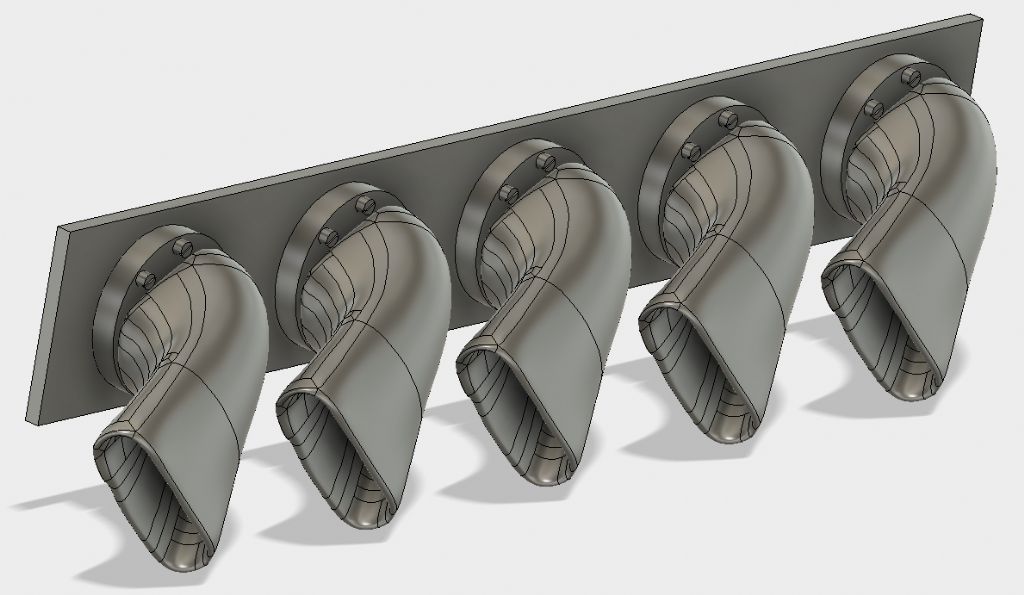

jimnick Posted January 29 Share Posted January 29 On 09/02/2017 at 19:42, Geoff Gardiner said: Thanks gents. The camera angle/lens used to take the pictures has made the wheels look a bit oversize. I have recently purchased a cheap 3D printer which is waiting to be put together. In the meantime I have been learning how to use CAD software. I am having a go with Autodesk Fusion 360 which is free to use for students and hobbyists. So far I have produced some exhaust stacks which I may use on the Mossie. /sites/3/images/member_albums/42665/723170.jpg /sites/3/images/member_albums/42665/723169.jpg More later... Hi Geoff, this is an old post but maybe you’re still active. I’m going to try and make some working exhausts to go with the RCGF15re that my father is putting into his. don’t suppose you have a 6 pipe version of your model? hopefully going to get them printed in sintered aluminium or worst case wax and cast them. Quote Link to comment Share on other sites More sharing options...

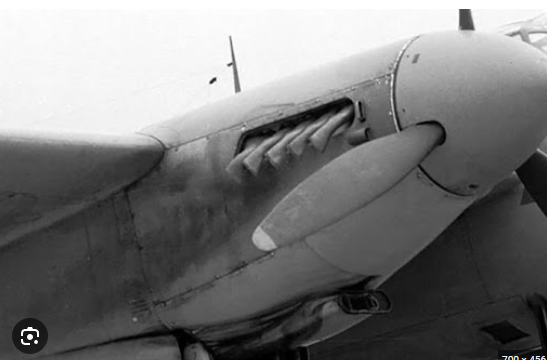

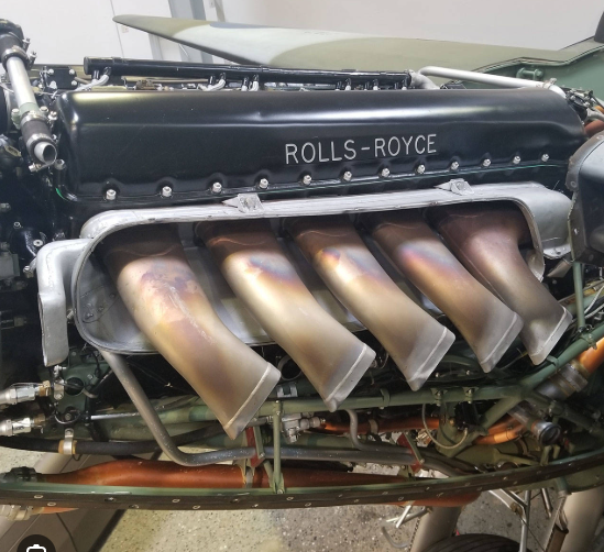

Chris Walby Posted January 29 Share Posted January 29 Six...really? PS Although the longer nacelle versions did have six exhausts! Quote Link to comment Share on other sites More sharing options...
Colin Carpenter Posted January 29 Share Posted January 29 Exhausts were siamised iirc ? Quote Link to comment Share on other sites More sharing options...
Chris Walby Posted January 29 Share Posted January 29 The problem was hot exhaust gases from the inboard stacks being ingested into the radiators/oil coolers, which required the aft cylinder exhaust to be siamesed with the cylinder forward of it to ensure the exhaust gases were ejected under the wing. British built Mosquitos were invariably fitted with the same style exhaust arrangement on inboard and outboard sides of the nacelle. Some Australian built Mosquitos with single stage Merlins were fitted with siamesed five stack exhausts on the nboard sides of the engine and separate six stack exhaust ejectors on the outboard sides of the engine with no detrimental effects to the wing leading edge, the exhaust was far enough forward for the gas to pass under the wing on the outboard side. So, if you spot a photo of a single stage Mosquito with 6 stack exhausts, these will only be on the outboard sides, the difficult to see (at the same time in the same photo) inboard stacks will be 5 stack with the aft pair siamesed. Quote Link to comment Share on other sites More sharing options...
jimnick Posted January 29 Share Posted January 29 3 hours ago, Chris Walby said: Six...really? PS Although the longer nacelle versions did have six exhausts! yes he’s building the later Mosquito FB Mk VI which some had the 2 stage engines which were longer and avoided the radiator thus able to have 6 pipes. I’m sure there’s purists out there who will mean other features won’t match but that’s what he wants so I’m just here to do the grunt work. I’ll model myself if I can find them. Quote Link to comment Share on other sites More sharing options...
Geoff Gardiner Posted January 29 Author Share Posted January 29 8 hours ago, jimnick said: Hi Geoff, this is an old post but maybe you’re still active. I’m going to try and make some working exhausts to go with the RCGF15re that my father is putting into his. don’t suppose you have a 6 pipe version of your model? hopefully going to get them printed in sintered aluminium or worst case wax and cast them. Sorry, no. I only did the five pipes. Quote Link to comment Share on other sites More sharing options...
jimnick Posted January 30 Share Posted January 30 10 hours ago, Geoff Gardiner said: Sorry, no. I only did the five pipes. would you be willing to send me the CAD. I could modify Quote Link to comment Share on other sites More sharing options...
