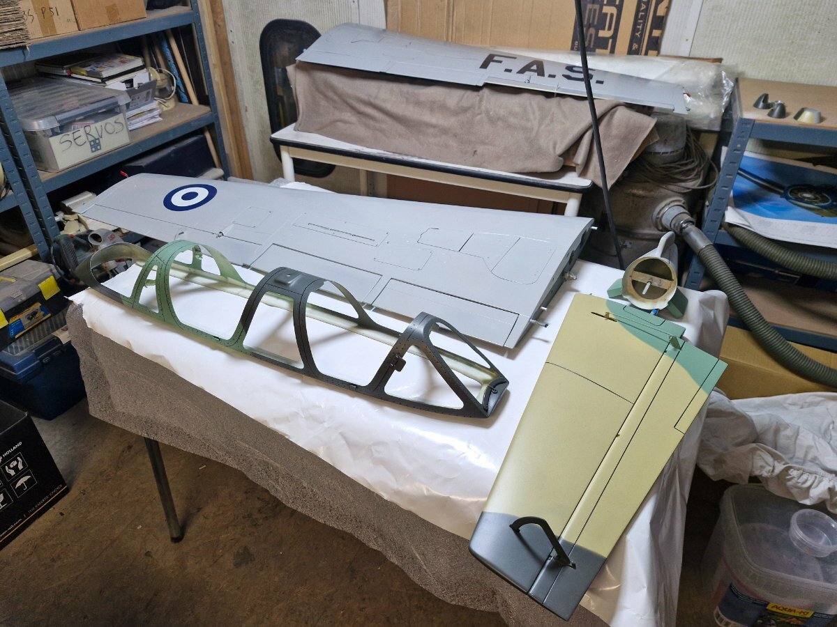

John H. Rood Posted June 22, 2024 Share Posted June 22, 2024 Dirk, Surely our wives and girlfriends will all look at this photo of yours and realise that THIS is how to design and decorate their DREAM living room for their dream house! 😸😎😅 6 Quote Link to comment Share on other sites More sharing options...

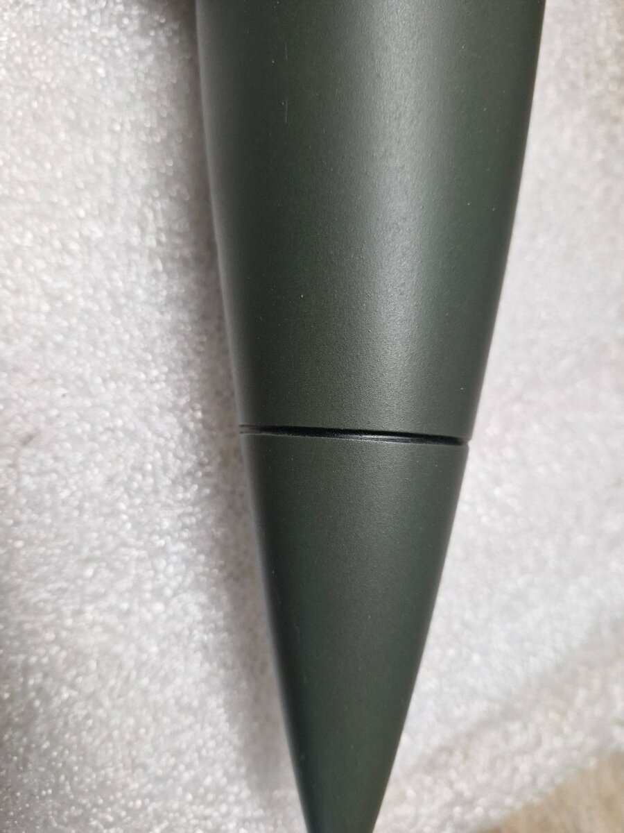

dirk tinck Posted July 4, 2024 Author Share Posted July 4, 2024 More paint , this time the tip-tanks 3 Quote Link to comment Share on other sites More sharing options...

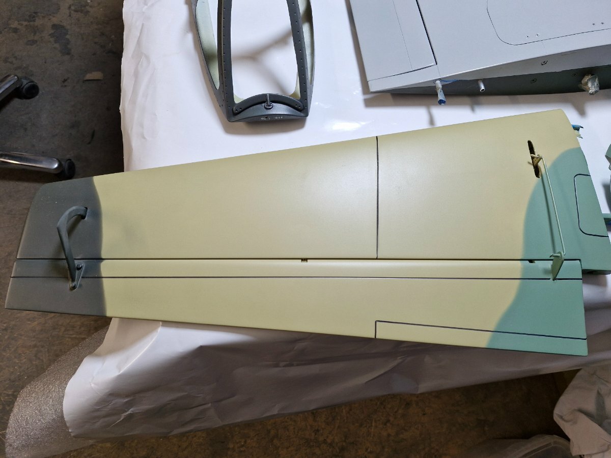

dirk tinck Posted July 7, 2024 Author Share Posted July 7, 2024 Figuring out how to paint the insides of the flaps and ailerons...Wich color ? X Quote Link to comment Share on other sites More sharing options...

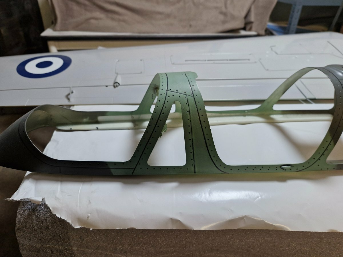

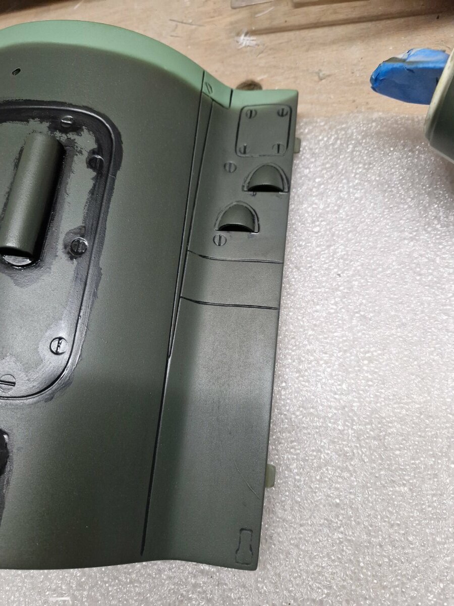

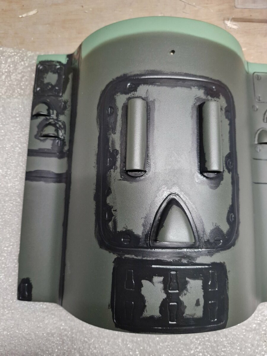

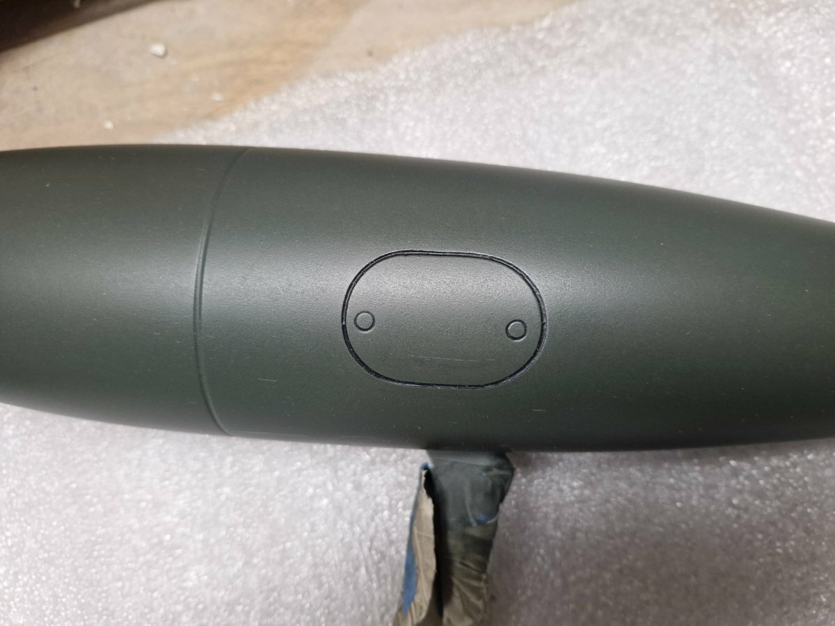

dirk tinck Posted February 10 Author Share Posted February 10 After a very thin cote of varnisch , i fiiled the panel lines with black-ish paint and then washed the most of it away to highlight them. Never done this before but educated myself with dozens of video's and magazines. Hope it turns out OK... Quote Link to comment Share on other sites More sharing options...

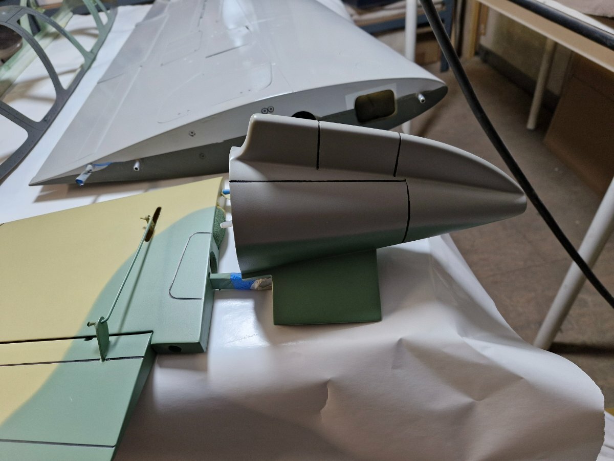

dirk tinck Posted February 16 Author Share Posted February 16 Hi all, No flying weather , so we're in the shop ! I gave some more parts a very thin coat of jacht varnish to protect the paintjob from being messed up by the weathering...dont ask... Some varnished parts got the first attempt of highlighting panel lines. It'OK i guess but the real pain comes whe i start using the little spray-gun for "misting" the dirt arround... Fingers crossed , again ! 4 Quote Link to comment Share on other sites More sharing options...

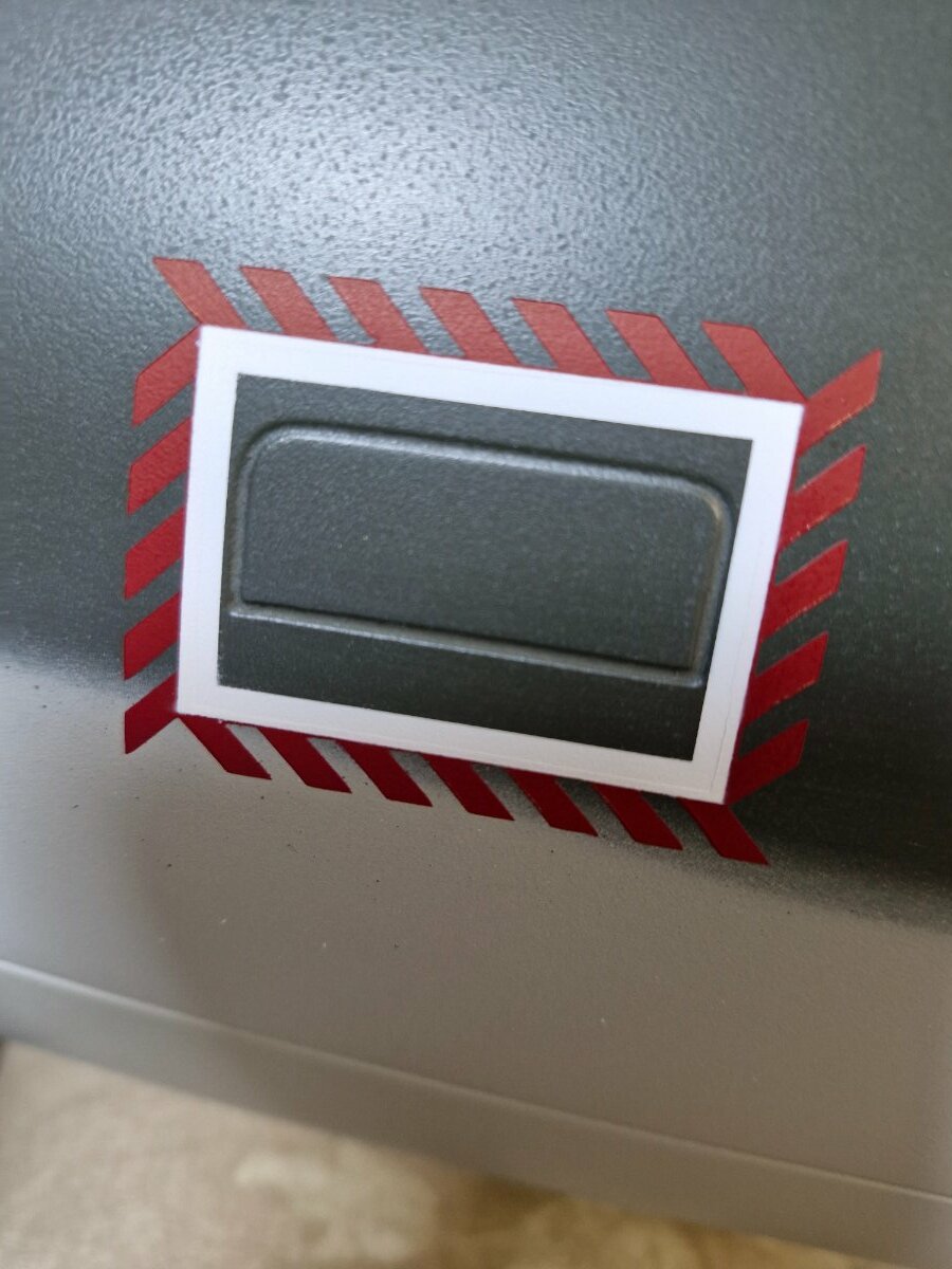

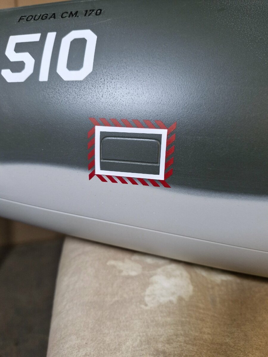

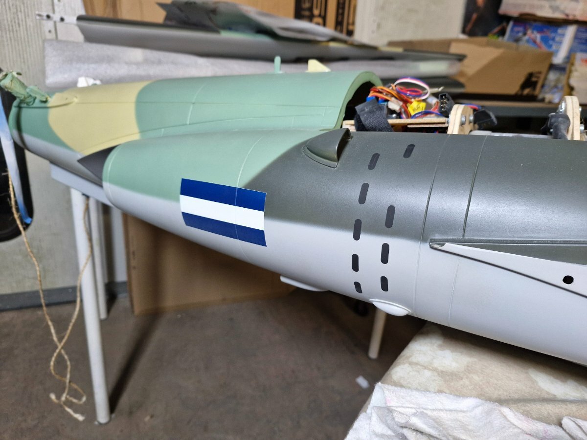

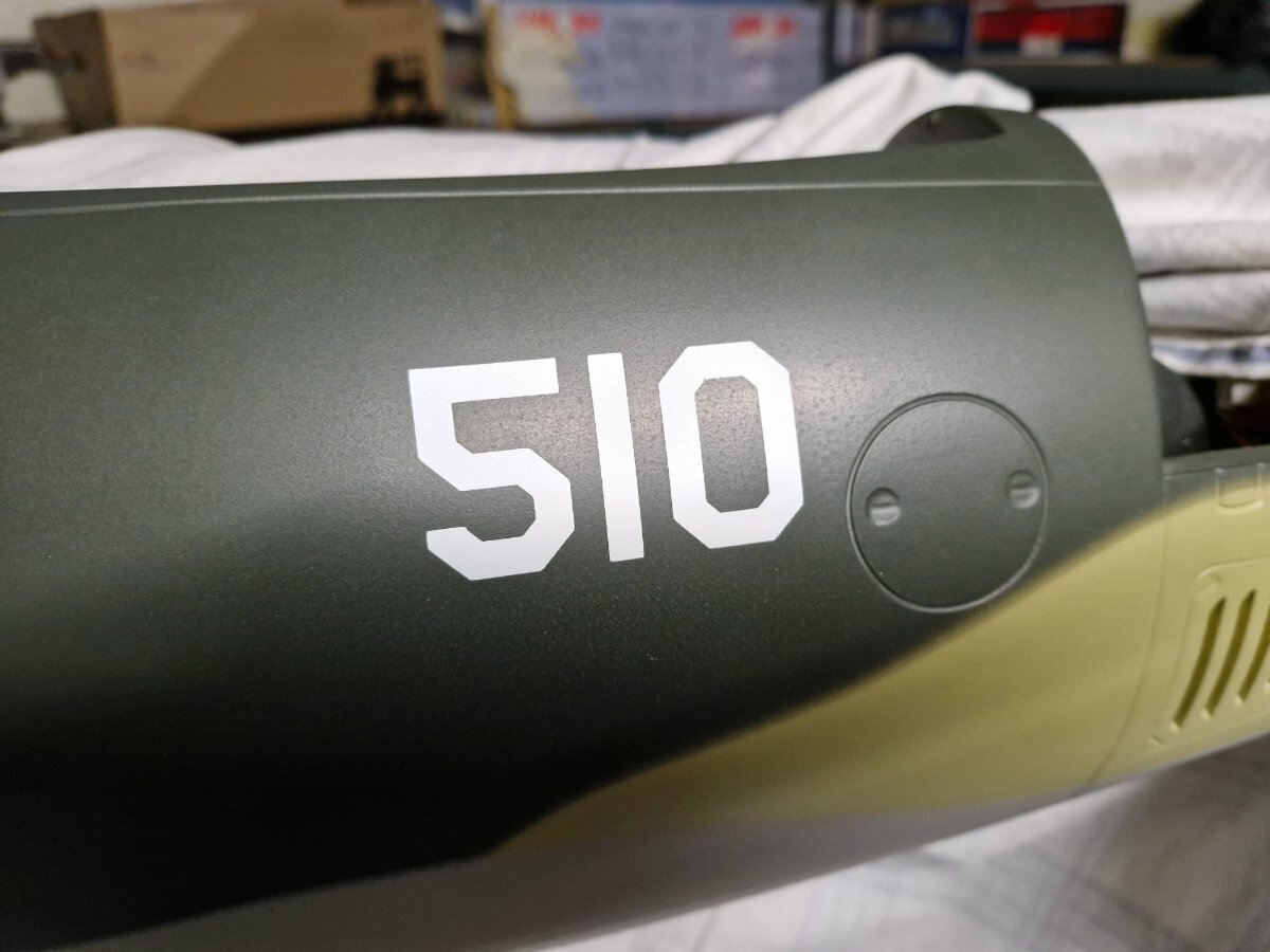

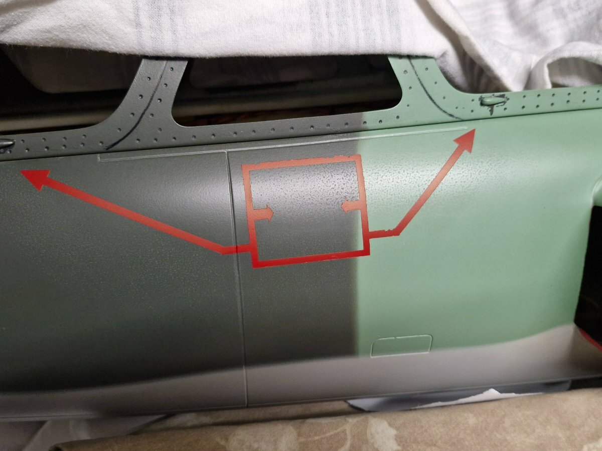

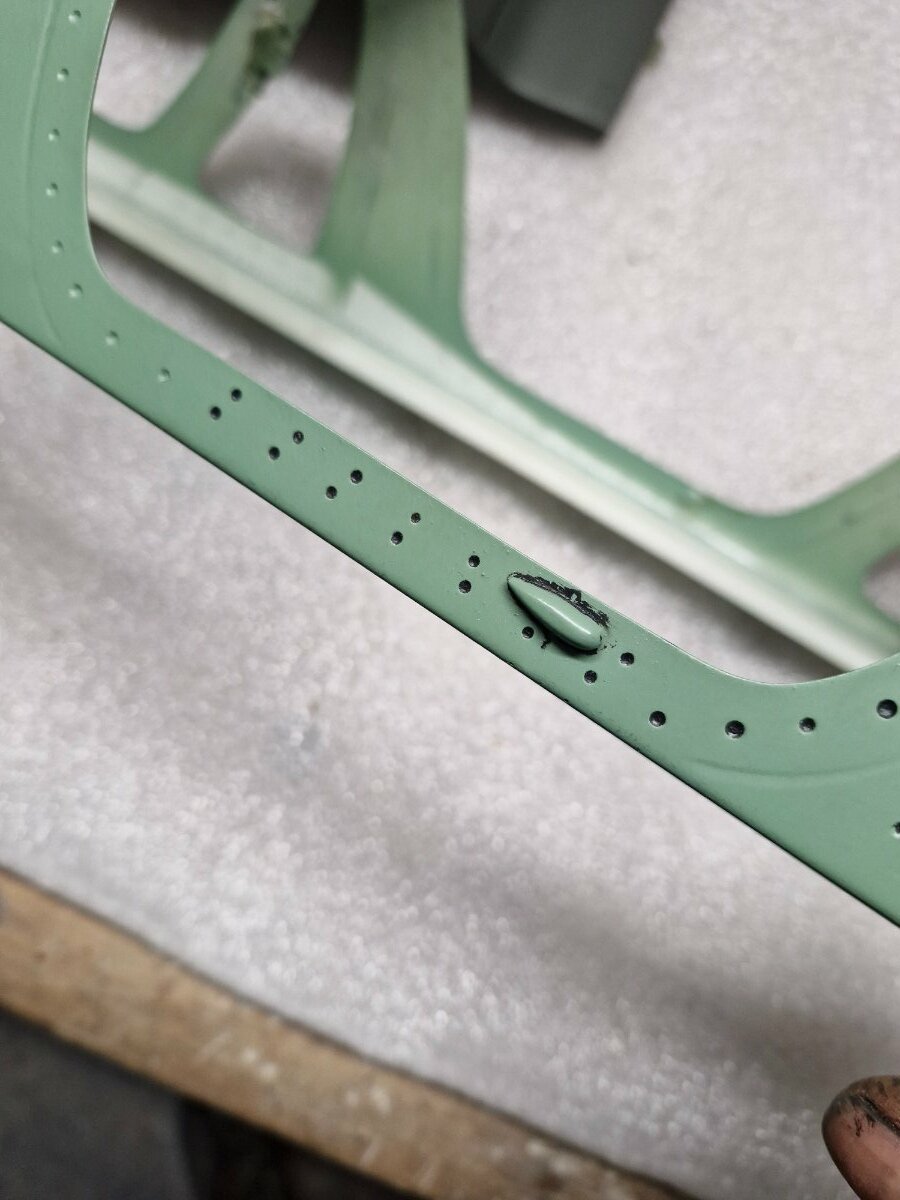

dirk tinck Posted February 27 Author Share Posted February 27 Hi all ! Before i try more weathering , i started to paint the decals by using paintmasks, not without some adhesion problems along the way ! Practice makes perfect right ? Some of the first results: Me happy ! 10 Quote Link to comment Share on other sites More sharing options...
Futura57 Posted February 27 Share Posted February 27 It's looking amazing. 1 Quote Link to comment Share on other sites More sharing options...
Andy Meade Posted February 28 Share Posted February 28 Wow, you've got that masking process pretty good Dirk! 2 Quote Link to comment Share on other sites More sharing options...

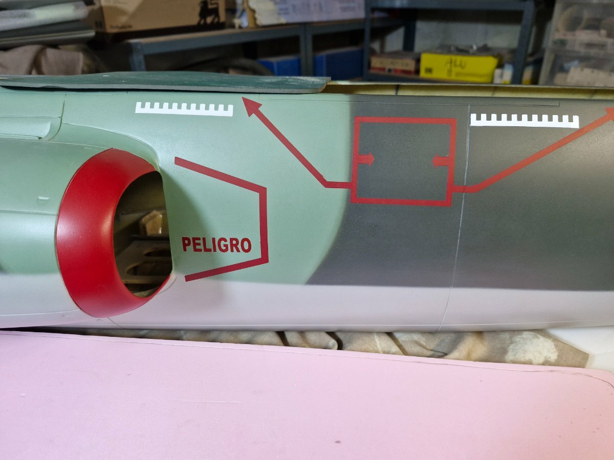

dirk tinck Posted March 6 Author Share Posted March 6 Thanks guys ! More details... X 8 Quote Link to comment Share on other sites More sharing options...
