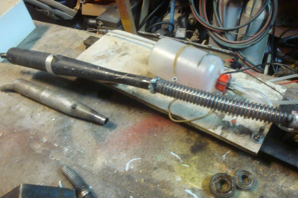

The head gasket, bearings and new exhaust have done their magic, down to 10.000 rpm on the APC 14 x 7 prop,
95db on the new exhaust, the old one was from a 4 stroke, maybe my old OS 20cc a compressor, the new one is ( I think )
an old tuned pipe for a 4cc 2 stroke, it doesn't vibrate much at all,,,
The small silencer is Diameter 30mmand total length 230mm
the bigger black one is D 35mm x 350mm.
 so what do I do with it,,, 'maybe' swap it over from my Rcgf 15cc clone in my horrible looking Golly,,,, ?
