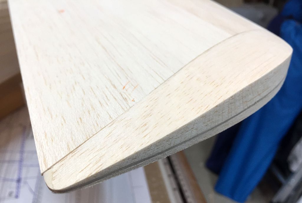

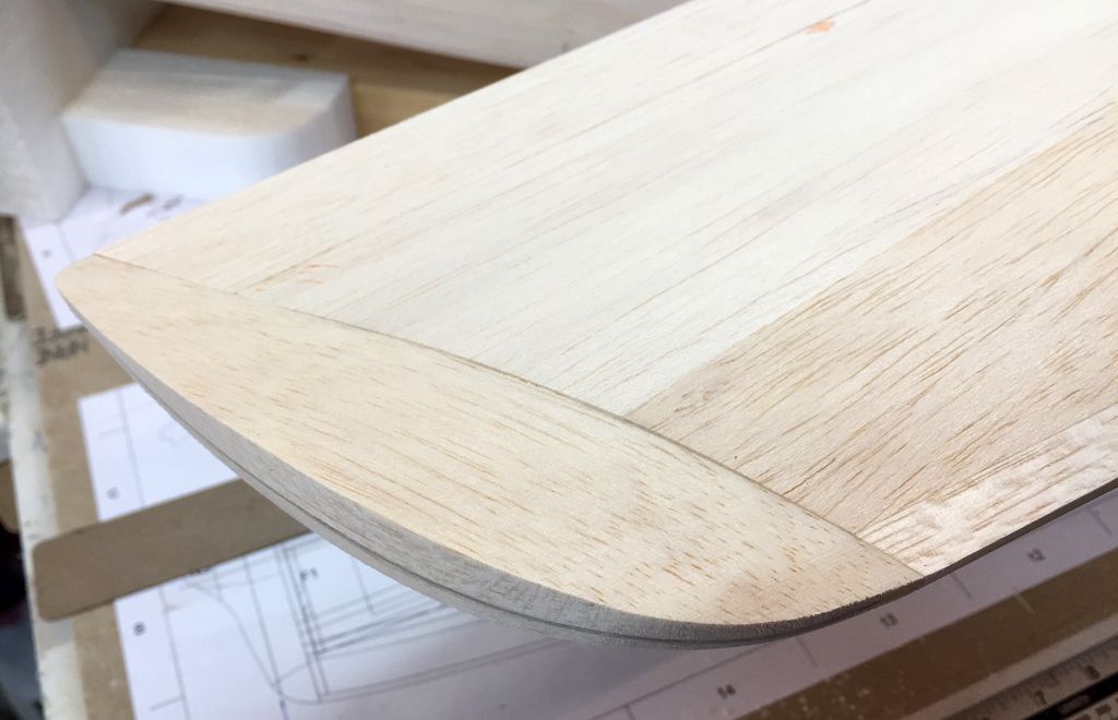

A great weekend for sanding weather wise - with sunny spells and a stiff breeze blowing all the dust down the garden - got the wing out on the workbench and took back the L/E, T/E and wingtip stock in profile just now in need of final rounding. I glued the ailerons on with 2 tiny drops of thin cyano to allow them to be sanded and blended accurately with the tip. You can see the thin ply insert in the middle of the wingtip sandwich which gives the nice stiff T/E corner.
I can now break the ailerons off their glue spots, allowing me to complete the aileron hinging and the L/E dowel arrangement.

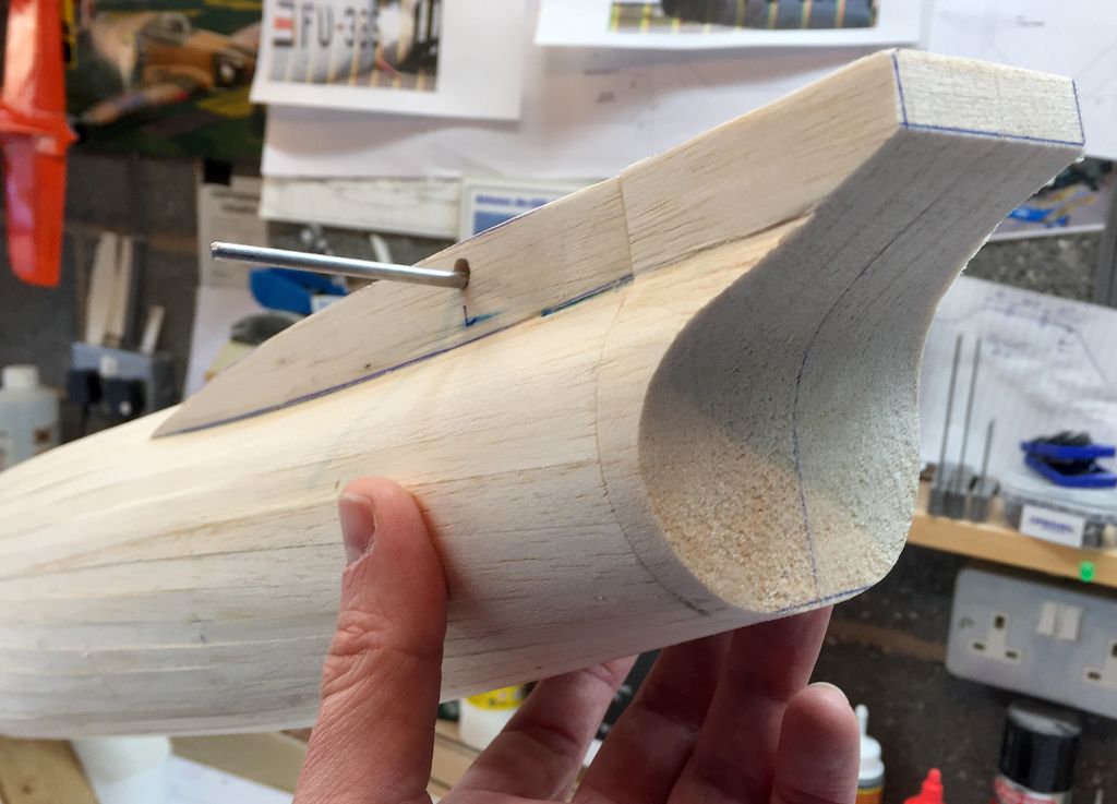

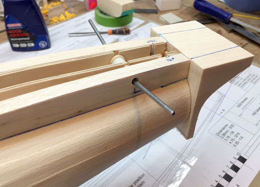

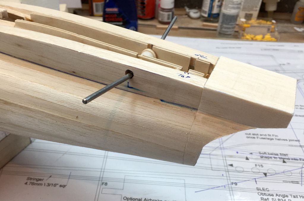

I've also cracked the tail end this weekend with the elevator 'cheeks' and the exhaust shroud now all complete. I've altered the arrangement slightly from the plan in that I've elected not to extend the cheeks beyond F10 rearwards, deciding instead to terminate them flush with F10 then adding a shaped balsa block to create the extreme rear end.
I wasn't totally happy with the profile shape of the exhaust shroud on the plan - all my 3 views suggested it had a much more prominent vertical edge with a smaller radius.
So I made one up from 4 laminates of 3/4" balsa cut out on the band saw.

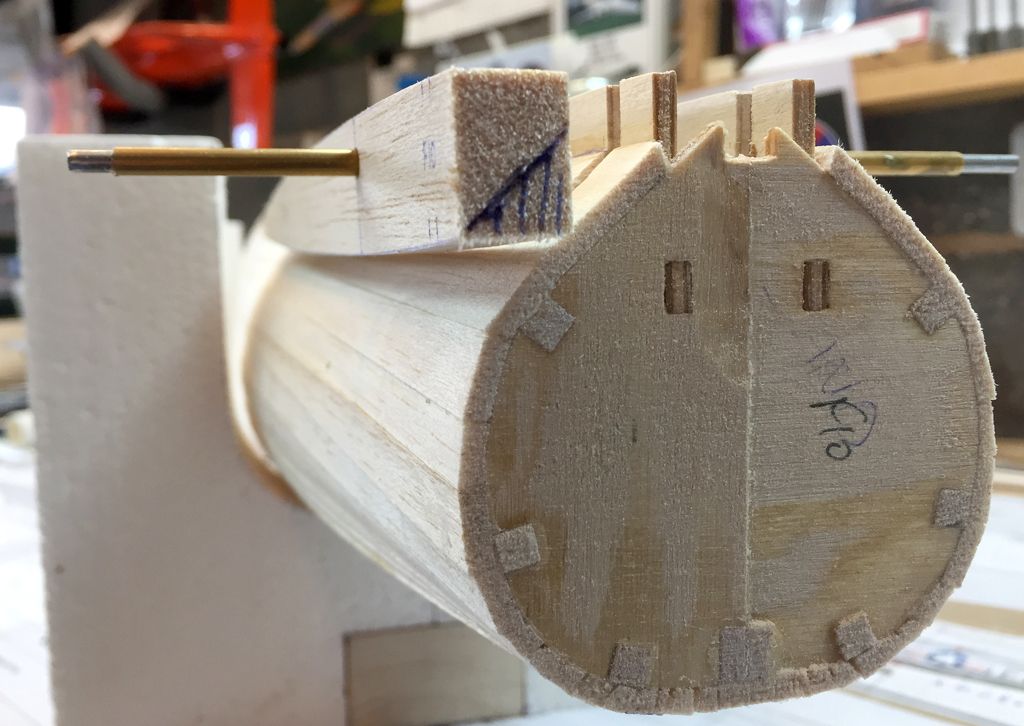

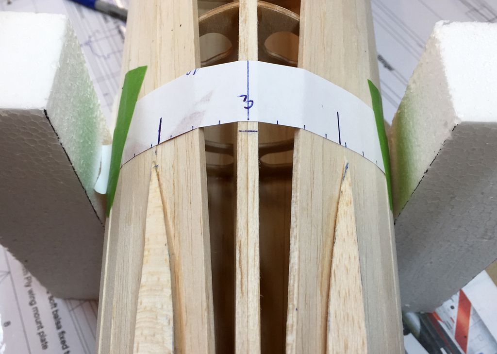

Before I could add this to the fuselage I needed to fit the tailplane cheeks which were shaped as per the drawing but for their shorter length rear. These needed a good sanding to get them to sit on the 45 degree slope just below the fin base. Much skin was removed from ones fingers with the Permagrit tooling involved!
To avoid oversanding, I found the use of a marker pen of great value - you can sand the slope angle just up to the sharp green/balsa edge safe in the knowledge you've not over done it and altered the required side profile.
I was worried earlier in the week how this job would go but it was simple in the end, the cheeks were soon made to fit quite accurately. I removed the trailing arm of the elevator actuator for ease whilst fitting the cheeks - an arcing slot is still required to replicate that in F15.
The cheeks are not mounted parallel to F15 but splay out towards the front only touching the ply tail formers at the back - they were angled purely by eye - but to get them at least symmetrical I made a little paper gauge and taped it to the fus about the centreline.

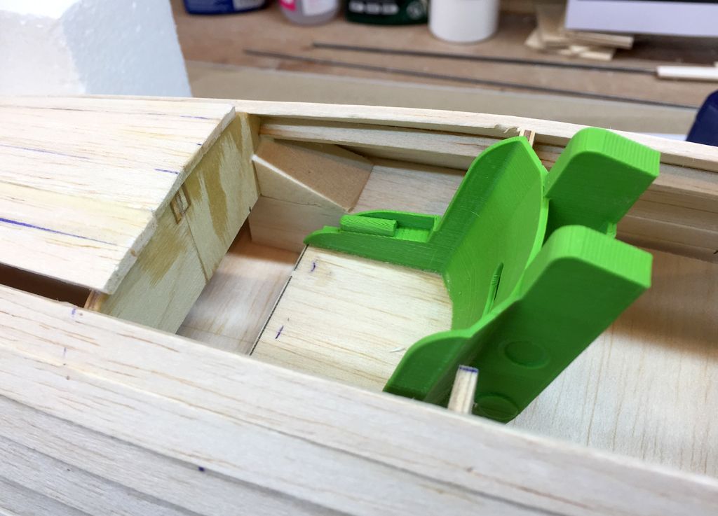

With my cockpit floor mounted on top of the battery box I was in need of a hybrid 3/4 depth seat and pilot as sketched cartoon style on my plan. Andy Meade pulled out all the stops and I received this excellent 3D printed seat and pilot made to measure the required depth - brilliant job as always Andy - much appreciated!!

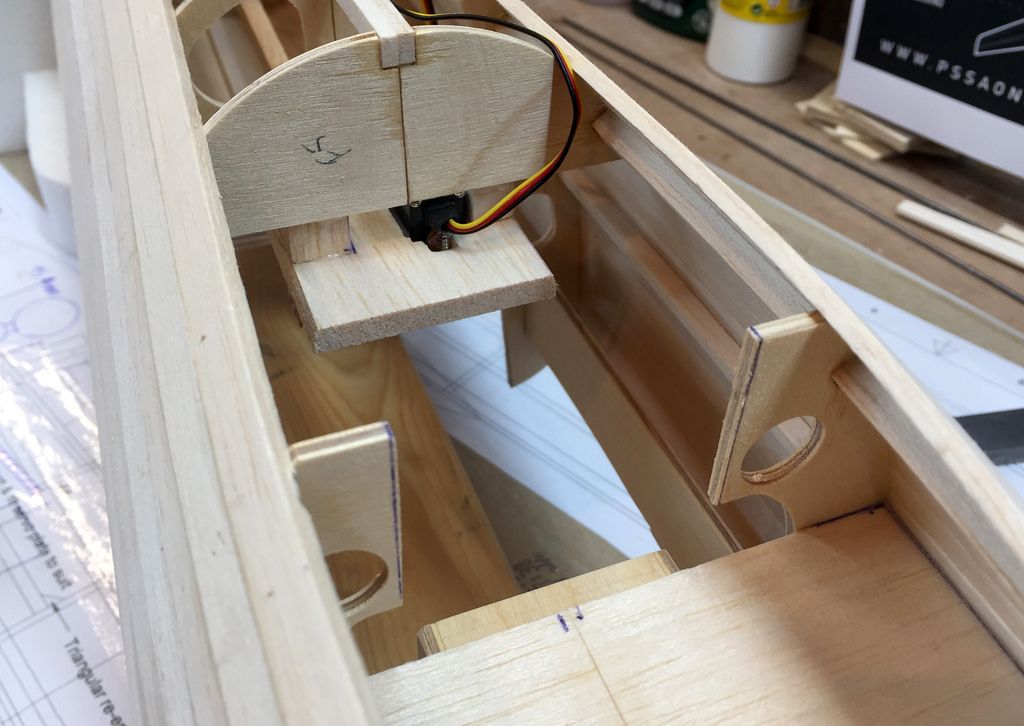

As you can see on the plan, F4 needs to be cut away to allow the seat to be positioned correctly, and sadly this caused some rework with my elevator servo mount, which (of course) I'd firmly anchored to F4. Bad planning by me. So before cutting the front of that away I added some additional triangular mounts to the rear of F5, bolstering the servo mount at both ends before the front extension was removed.
I extended the cockpit floor rearwards of F4 and that was about that - the seat and pilot could now be fitted and checked for height - all looking good! Whilst I was here, I added some very basic side console panels which will help bring the 3/4 depth cockpit to life later - all just soft balsa block.

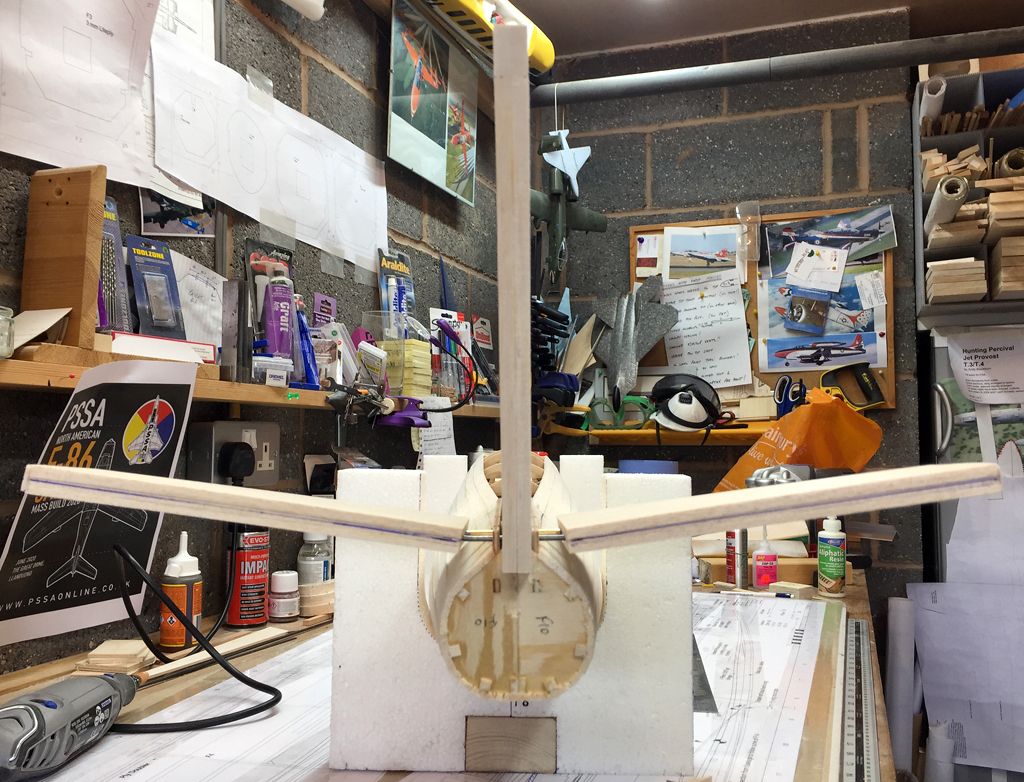

Hi Andy,
Only Chris' Sabre Dog variant was built without the tailplane dihedral - that is scale for that type (I dont understand the aerodynamics myself?) but certainly if you are building a more regular F-86 then the tailplane dihedral is the only way to go for scale.
As for levelling the tail actuator, if you have glued the 2 fuselage halves together without misalignment then the grooves pre cut in F-15 will ensure the actuator sits level - or as level as it needs to be - the width of those slots will need opening up to suit the brass tube you use as a pivot, but the depth of those slots is pre-cut and determines the angle of the tailplane axle. I can't say mine is accurate to 2 decimal places either, and there's loads more tolerance stack up yet to come with the fitment of the tails onto the bent rods. Only once its all set up with the wing and fin assembled can you really stand back and say its all symetrical, and make the required ajustments then as necessary - bending rods or opening out tailplane slots etc.
Dirk - the 1/32" ply sandwich filler in the tip blocks allows you to sand right down to that thickness (and thinner if you wish) at the T/E and it all remains very stiff and robust. I hate soft perishable T/E corners too!

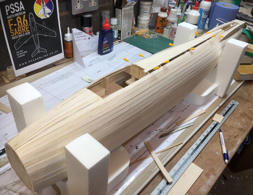

Started a job today I've not been looking forward to for a while... marking out and cutting back the wing saddle in the fuselage sides...
I used the 'sharpened metal rod' method as described very well in Steve Houghton's build blog. Using the inner ply formers as a guide, this worked well to 'prick out' a curved line just proud of the final required shape. That material was cut out by hand and I used a length of 2" dia plastic pipe with some decent grit paper glued to it to sand out to the required profile. The central overhanging ply former was tackled with the Dremel and a grinding wheel. Still a bit to do fore and aft of the ply saddle formers where the profile runs out, I'll complete that once the wing is married up. I'm conscious too that more material is needed off to allow for the thickness of the wing fillet foundation - (1/32 balsa or ply normally) - so more shaping ahead.

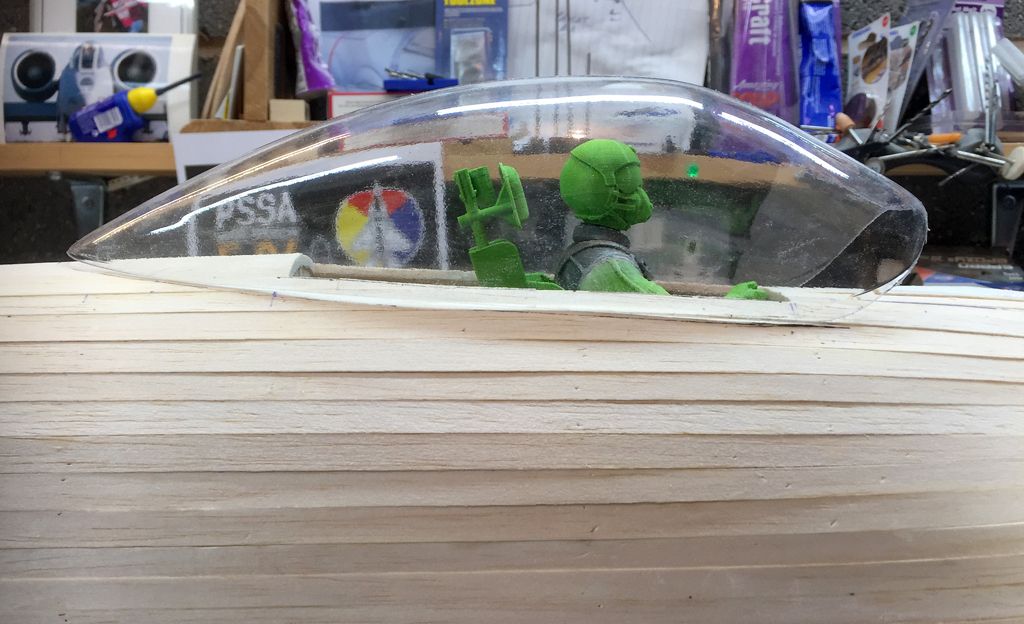

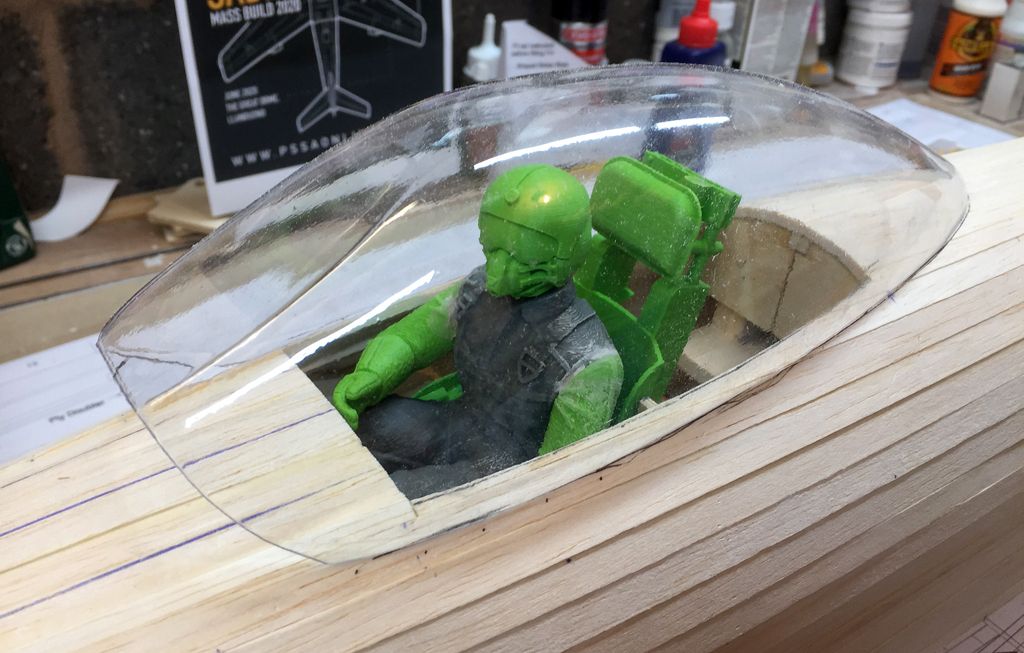

With the top planking complete I could trim back the cockpit area to suit the canopy. The canopy was trimmed to shape and fitted delicately to the fus to enable me to trace the edge onto the planking. That line was then offset by 10mm inboard to form the curved edge of the cockpit lip. i made a little sanding tool to help here.
After I finished this and refitted the canopy I felt that 10mm was too much by eye, so I offset again by another 3mm giving a 7mm lip to the canopy, this looked a lot better IMO. I've still to make up the canopy blend at the front, something to complete once I've sanded my planking...
I cut my canopy to the line as evident in the Vortex canopy, I think there's a little meat on the canopy still cut at this position - it sits a little high for me, what do others think? Maybe the line is conservative, feels like another 5mm could come off this in height for scale?
