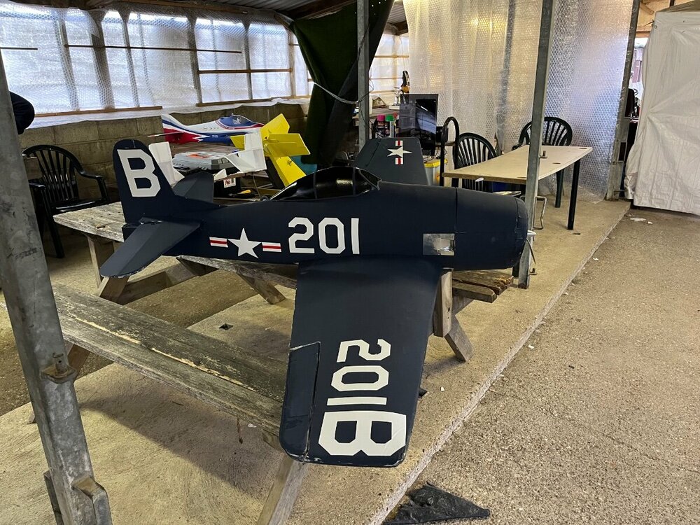

Lipo Man Posted September 8, 2024 Author Share Posted September 8, 2024 Got a few photos of the Bearcat in the air this afternoon after the thunderstorms cleared and it turned into a perfect flying day. Some modifications to the take off trolley have solved the problem I was having where it would actually be carried up by the plane after takeoff. Became a significant problem if it got stuck on one wing - had a nasty crash that way that forced the modifications. It’s now working reliably and the big Bearcat is an absolute pussycat to fly. It’s true - big does fly better! 10 Quote Link to comment Share on other sites More sharing options...

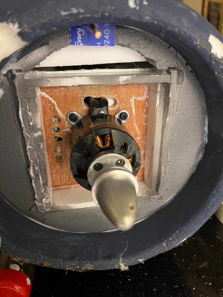

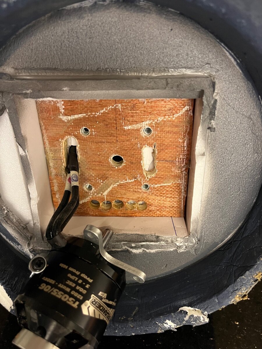

Lipo Man Posted October 11, 2024 Author Share Posted October 11, 2024 One of the implications of spending hours building our flimsy contraptions before chucking them optimistically into the air is that we have to be resigned to the fact that ,sooner or later ,our contraptions will return to terra firma with more speed than we would like. I like to think about this when designing a model, and I try to make it crash as well as possible (I crash a lot, so it’s a significant advantage). With my foamboard models, the attachment of the firewall to the front of the fuselage is a weak point. I tend to design to allow this break to absorb any impact, and I can just hotglue the firewall back on and be back in the air in minutes. That wasn’t going to work with something as big as this Bearcat, so I tried something new. The firewall is designed to be very firmly fixed such that with enough force it would rip the front off the plane. Clearly this is a bad thing. The work-around was to fix the motor to the firewall with nylon screws. The idea is if I do something stupid the screws will break, and in doing so absorb enough of the impact to minimise damage elsewhere. So - I am very pleased to say that after a real-world practical test (“hey guys, look what I can do”) the front of the plane survived with only cosmetic damage after three of the four screws snapped as intended. And next time someone is filming chase footage from a quadcopter, I will remember not to try to fly a slow inverted pass down the strip. 2 Quote Link to comment Share on other sites More sharing options...
