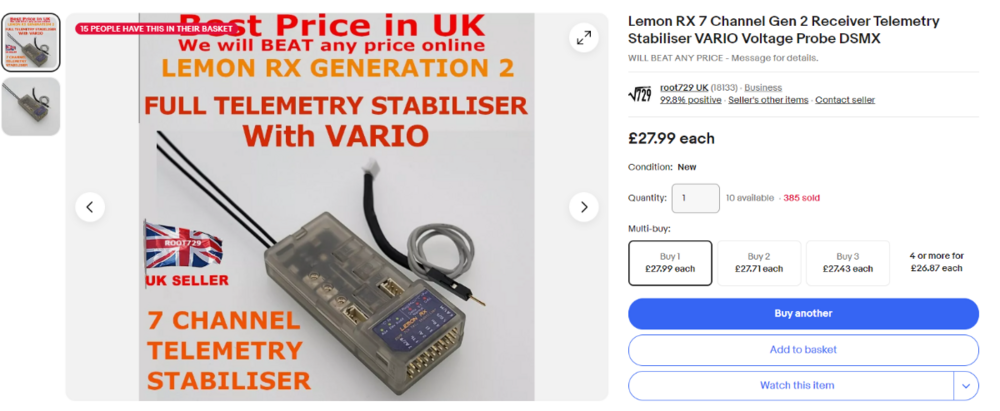

MaxG Posted July 17, 2024 Share Posted July 17, 2024 Have a look at the Lemon Rxs. They have varios that work with my Tx16s and they also have gyro stabilisation should you wish to use it. I have found them easy to bind to my 4in1, they are DSM. Quote Link to comment Share on other sites More sharing options...

Kim Taylor Posted July 17, 2024 Share Posted July 17, 2024 3 hours ago, Hoochykins said: Don't they also require a standalone telemetry box that the sensors connect to? It seems the Vario is built into this box so it would need a lemon RX and the telemetry box? No, the Lemon Rx has all the necessary gubbins 'built in' to the receiver. I've just started using my first 'Gen2' Lemon rx, so haven't set up the vario yet (no real use in my application) but the previous model telemetry rx's had vario and height built in, which definitely did work as a 'stand alone' item. No reason to assume that they'd take a backwards step. Kim Quote Link to comment Share on other sites More sharing options...
Outrunner Posted July 17, 2024 Share Posted July 17, 2024 I've got some 7 & 10ch Lemon gen 2 receivers and there is no separate box required for the many sensors built in to the receiver. The only external parts are the voltage or current sensor cables and/or optional satellite receiver. Quote Link to comment Share on other sites More sharing options...
Hoochykins Posted July 17, 2024 Author Share Posted July 17, 2024 (edited) I have looked again and I was wrong, it's all in one receiver, that saves me going over to ExpressLRS now so much appreciated. I think ELRS will be a future move for me. I've got myself a Lemon RX on order so looking forward to trying it out. Thank you! Edited July 17, 2024 by Hoochykins Quote Link to comment Share on other sites More sharing options...
