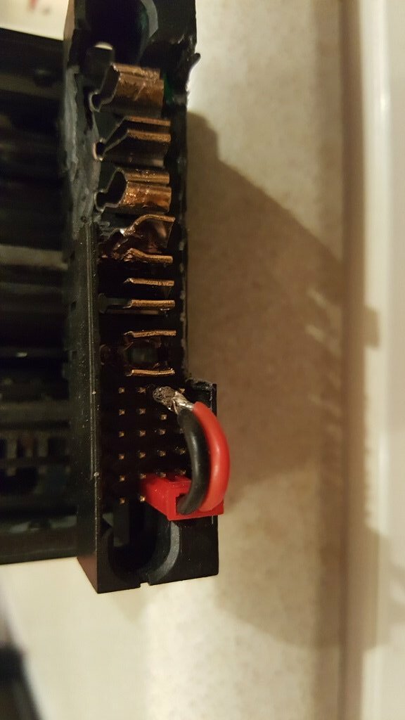

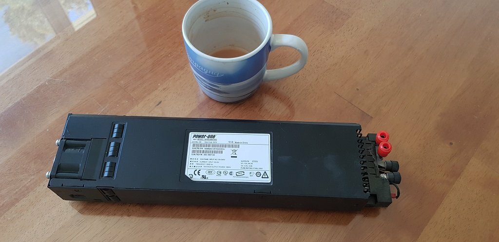

Philip Lewis 3 Posted March 5 Share Posted March 5 3 hours ago, Witterings said: Probably also going to do as @Sheepish suggested and convert a server as well for the longer term. I've made literally dozens of these over the years. Very high output, up to 87 amps, I use two of these to power two quad chargers each so in effect eight chargers for each power supply with each charger charging a 5 cell 5,000 mah pack so eight batteries per power supply being charged. If you go down the route of converting a servo supply make sure you know how to turn the 12 supply on, for instance with these ones you short together the three pins in the photo. However beware, high power they are and very compact too, but the one thing they definitely aren't is quiet! You also need to use at least 12 awg wire from the supply to the charger and that assumes you have two + and two - connections of you'll get too much heat in the wires. The good news however is that these are in effect electrical waste with virtually no demand for them, the last lot I bought were advertised on e bay at £30.00 each plus postage at cost and they had 12 of them, I offered to take all 12 for £100 and they pay the postage, and they accepted the offer. Quote Link to comment Share on other sites More sharing options...
Witterings Posted March 5 Author Share Posted March 5 33 minutes ago, Philip Lewis 3 said: I've made literally dozens of these over the years. Very high output, up to 87 amps, I use two of these to power two quad chargers each so in effect eight chargers for each power supply with each charger charging a 5 cell 5,000 mah pack so eight batteries per power supply being charged. If you go down the route of converting a servo supply make sure you know how to turn the 12 supply on, for instance with these ones you short together the three pins in the photo. However beware, high power they are and very compact too, but the one thing they definitely aren't is quiet! You also need to use at least 12 awg wire from the supply to the charger and that assumes you have two + and two - connections of you'll get too much heat in the wires. The good news however is that these are in effect electrical waste with virtually no demand for them, the last lot I bought were advertised on e bay at £30.00 each plus postage at cost and they had 12 of them, I offered to take all 12 for £100 and they pay the postage, and they accepted the offer. I ordered one of these earlier today, there's quit a good video onhow to set them up https://www.ebay.co.uk/itm/167351747060 Quote Link to comment Share on other sites More sharing options...

Witterings Posted March 12 Author Share Posted March 12 (edited) Just thought I'd update firstly to say cheers for everyone's input but also in case anybody else stumbles across it and finds it useful. I've gone a bit power supply mad .... I bought a ToolkitRC ADP 200 which is great and absolutely silent, whilst I can use it quite a bit of the time the 10Amps will be it's limitation. I also bought the ATX breakout board and have fitted 2 sets of leads to the main +12v terminals and have been using it with 2 chargers, it'll provide 20Amps / 240 Watts so will cover my needs most of the time and is virtually silent. Think this must be when the obsession kicked in 😄 as I also bought a 2nd hand server power supply, an HP DPS800GB and followed the video linked below and it works brilliantly and is still a very acceptable level of noise sitting just behind me. Think all my power supply needs are covered for the immediate future and thanks again for eveyone's input 👍 https://www.youtube.com/watch?v=qDeLH6yzlbw Edited March 12 by Witterings Quote Link to comment Share on other sites More sharing options...
