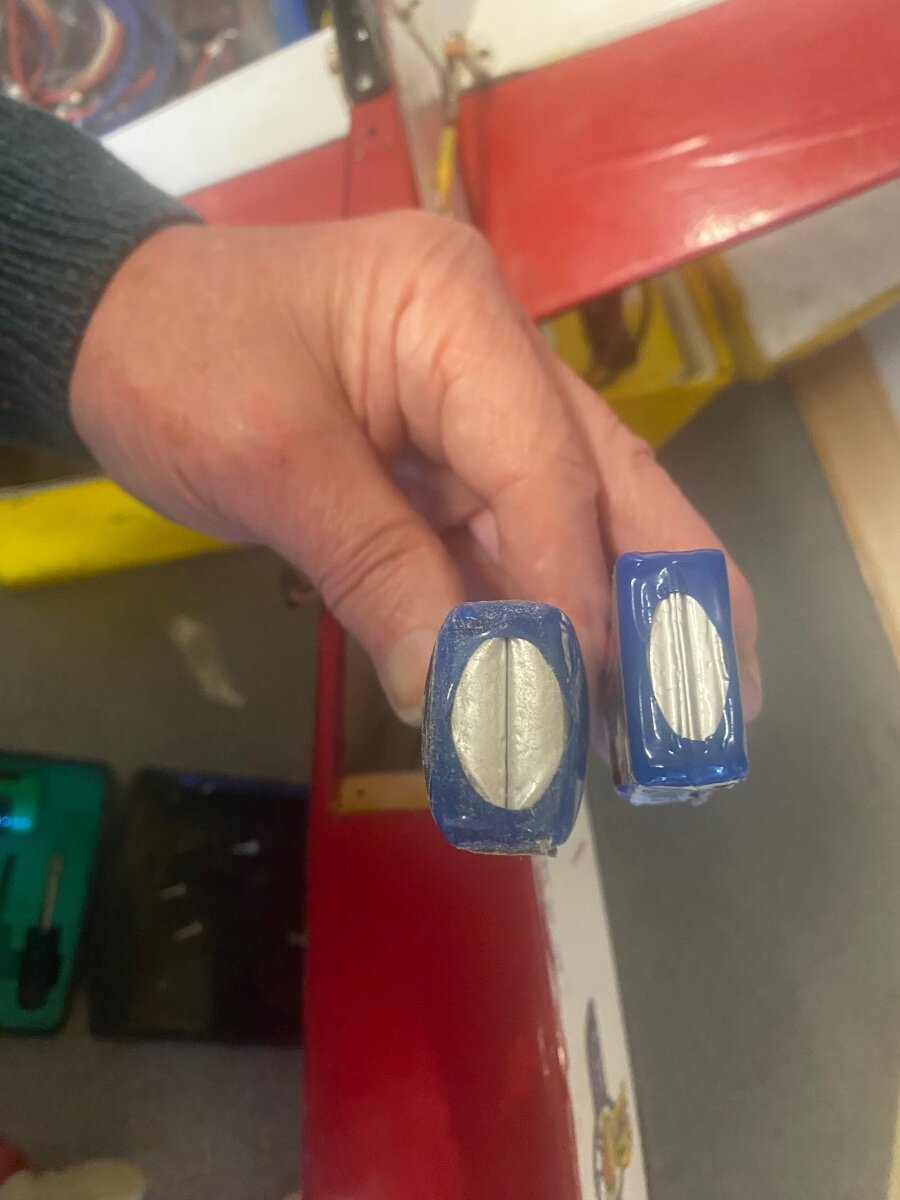

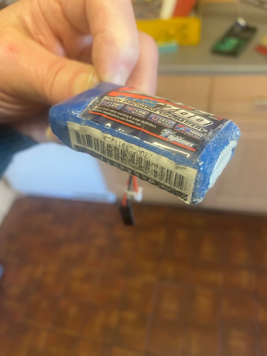

Martin Harris - Moderator Posted March 3 Share Posted March 3 I received some unexpected low battery warnings when flying my scaled down IC powered Ohmen the other day. Due to the long nose (designed for EP) it was necessary to locate the receiver battery as far back as possible, so I fitted a soft cased 2S LiFe pack to be as much “fit and forget” as possible. Some charge/discharge testing revealed the pack was well down on capacity so I decided to change it - not as easy as expected as it had swollen badly making it difficult to remove! It came as a bit of a surprise to see this swelling - I thought this was only a LiPo problem so now I’m wondering about the common advice that they’re safe to charge in situ - perhaps this should only apply to metal cased ones? Quote Link to comment Share on other sites More sharing options...

Nigel R Posted March 3 Share Posted March 3 Looks rather battle worn at this point! Phil, I thought it was the LiFe chemistry that was "less prone" to inflating. Maybe this pack had an internal fault that caused the swelling? Although it looks like both cells have swollen. Quote Link to comment Share on other sites More sharing options...

John Lee Posted March 4 Share Posted March 4 Last year I saw a similar LiFe Rx pack that had swollen a bit more than Martin's. It was being used in an RC yacht at a local boat club and the owner asked for opinions as to whether it was OK to use. I commented at the time that I had never seen one that had swollen before but that it was relatively common with LiPos. Of course I gave suitable disposal advice. So not unknown, but rare. It made me wonder as to the exact chemistry of these packs and whether they are true LiFe's? Quote Link to comment Share on other sites More sharing options...

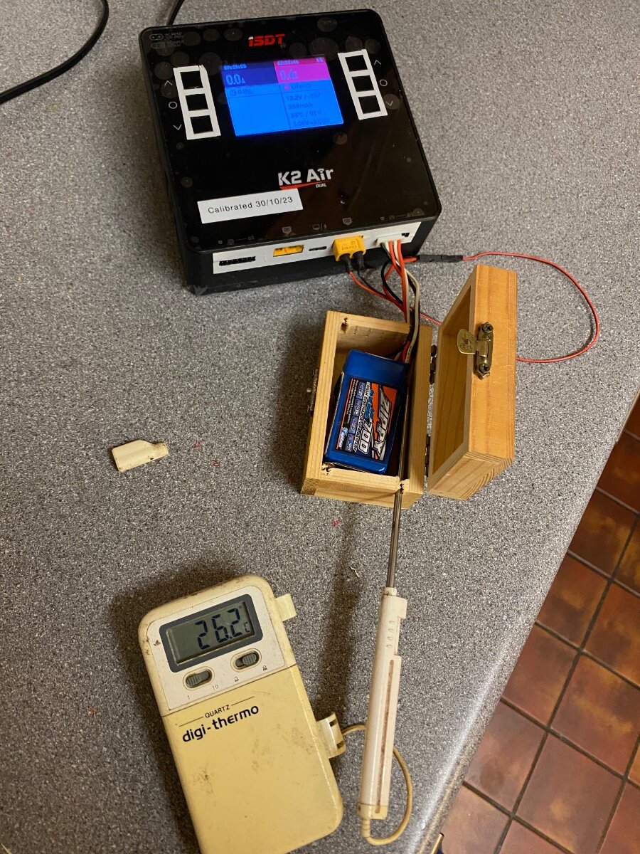

Nigel R Posted March 4 Share Posted March 4 7 hours ago, John Lee said: It made me wonder as to the exact chemistry of these packs and whether they are true LiFe's? I think LiFe is a single specific chemistry. The terminal voltage is different to the typical LiPo cell that we use, so they're "easy" to tell apart, I guess. LiPo is more a construction method. Can include many variations of lithium chemistry, gel makeup, polymer, and cathode material. Both degrade with heat and extreme of charge/discharge, which includes developing the gas build up / puffing problem. 6 hours ago, Martin Harris - Moderator said: The puffed pack has always been balance charged via an extended balance lead. Although puffed and dramatically down on capacity, cell IRs were closely matched. I don’t recall it ever being over discharged or charged wrongly. Slow or fast charge? Just wondering if there has been a heat build-up issue, where the pack was buried inside a model during charging; fast charge might well exacerbate that. Quote Link to comment Share on other sites More sharing options...
Martin Harris - Moderator Posted March 4 Author Share Posted March 4 It’s certainly worth considering but I’m not sure that much heat is generated during charging. I will try a test with one in an enclosure. Quote Link to comment Share on other sites More sharing options...
Martin Harris - Moderator Posted March 5 Author Share Posted March 5 …which I’ve done. A bit of serendipity produced a small wooden box from my workshop in which a 700mAh 4S pack, made from two packs identical to (and the same age as) the puffed pack fitted almost perfectly. It also had holes already made in it which allowed the lid to close and a temperature probe to lie alongside the pack. If I’d have designed it from scratch, it couldn’t have been any better! I charged at 1C and the temperature rose to a maximum of 4 degrees above ambient. Discharging the pack at a slightly higher than average rate in service of 400mA raised the temperature to 6 degrees above ambient. Bearing in mind that this enclosure has much thicker walls, less free space and twice the energy capacity of the model’s, I’m pretty reassured that the battery’s position wasn’t a contributory factor in its demise. 1 Quote Link to comment Share on other sites More sharing options...
