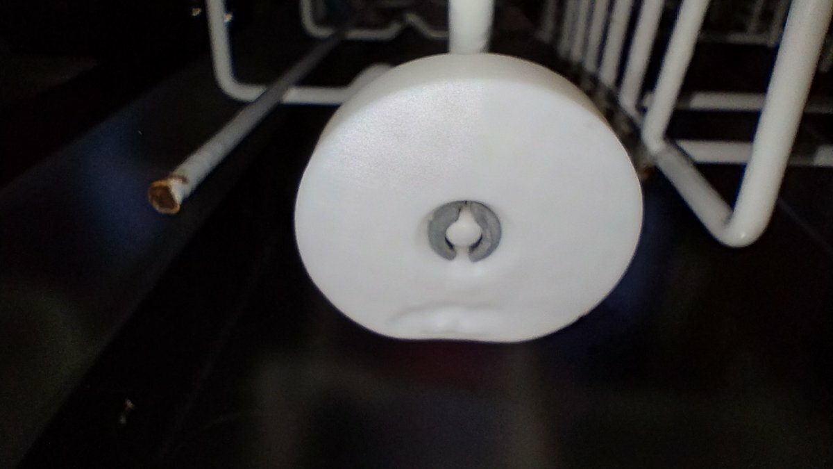

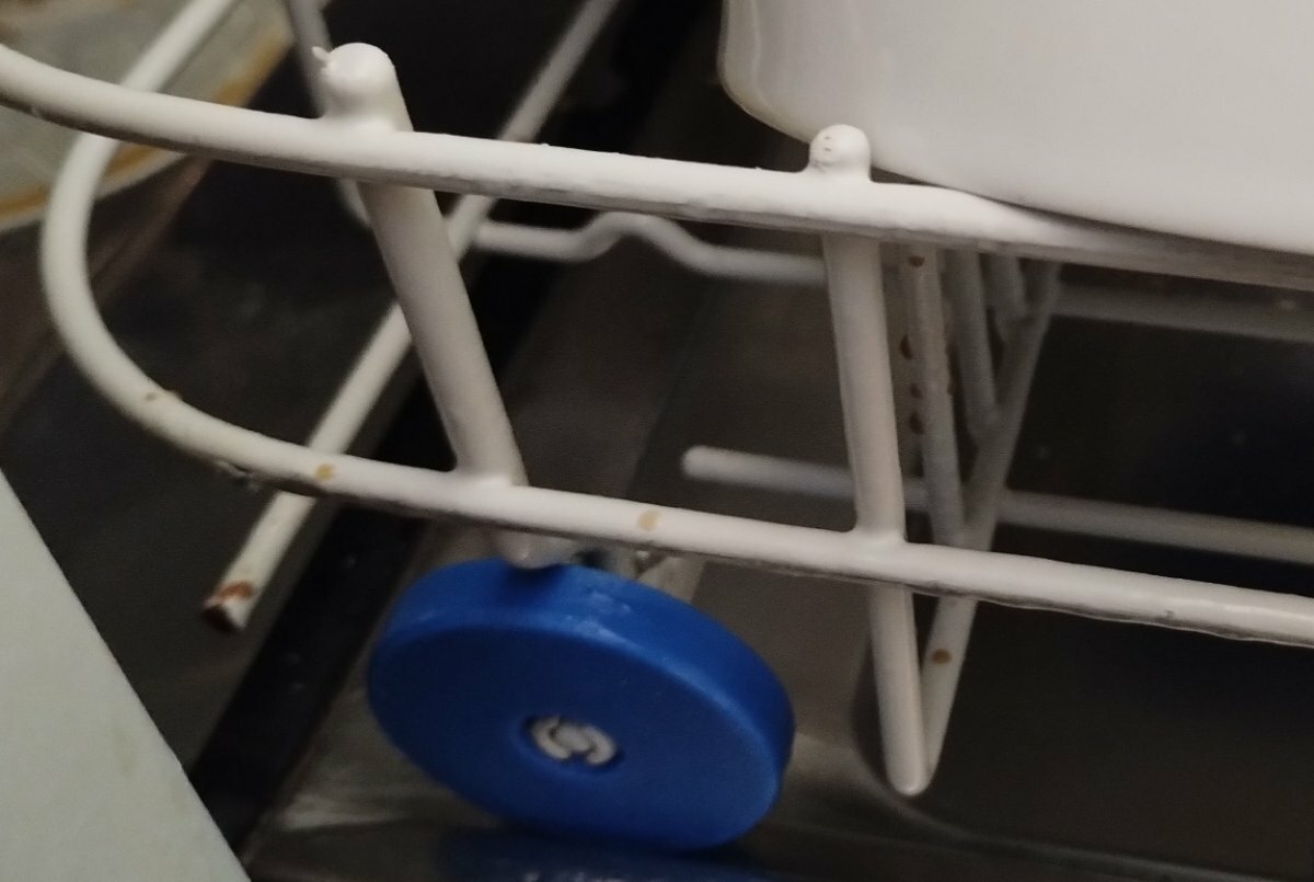

Phil Green Posted March 6 Share Posted March 6 (edited) Complete printing numpty three weeks into a Creality K1 here, with a question for the experts please 🙂 The original support wheels on the lower tray of my dishwasher have worn to the point the tray catches on the whirly thing below. All I have is Creality Hyper PLA and the new wheels solved the problem but as I half expected, they melted in a 60° wash. So the question is, would ABS survive? If not, what other options might? Ta v much 🙂 Phil   dishwasher_wheel.stl Edited March 6 by Phil Green Quote Link to comment Share on other sites More sharing options...
Ron Gray Posted March 6 Share Posted March 6 Should be OK up to approx 85° 1 Quote Link to comment Share on other sites More sharing options...

Phil Green Posted April 12 Author Share Posted April 12 Just to round this off, the ABS wheels have completely fixed the problem, they've been in there a month now and no distortion at all 😃  3 Quote Link to comment Share on other sites More sharing options...
