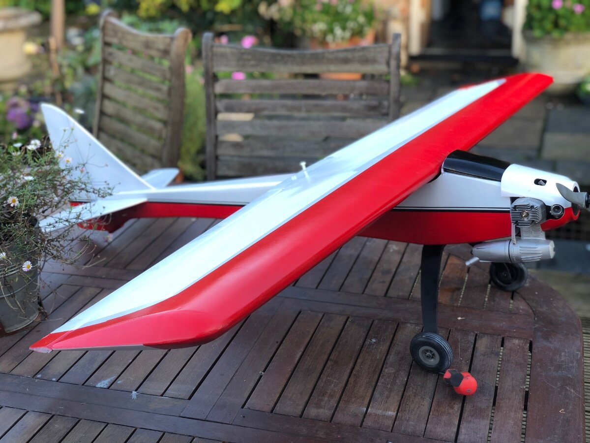

Bucksboy Posted April 20, 2024 Share Posted April 20, 2024 I’ve built a Wot 4 and then glassed and painted it with 2 pack aerosol, the aim to create a Winter hack. It worked perfectly, the covering and paint are completely fuel proof and it only requires are spray of water with detergent and a wipe down. I don’t need to worry about film lifting and it looks the same after a flying throughout the winter as it did in September. I agree that it is more work but it does create a fuel proof, durable finish. I used automotive aerosols where the aerosol had a hardener inside the tin, by activating it the tin was useable for at least two weeks. The paint is entirely fuel proof after being allowed a week to cure. 5 Quote Link to comment Share on other sites More sharing options...

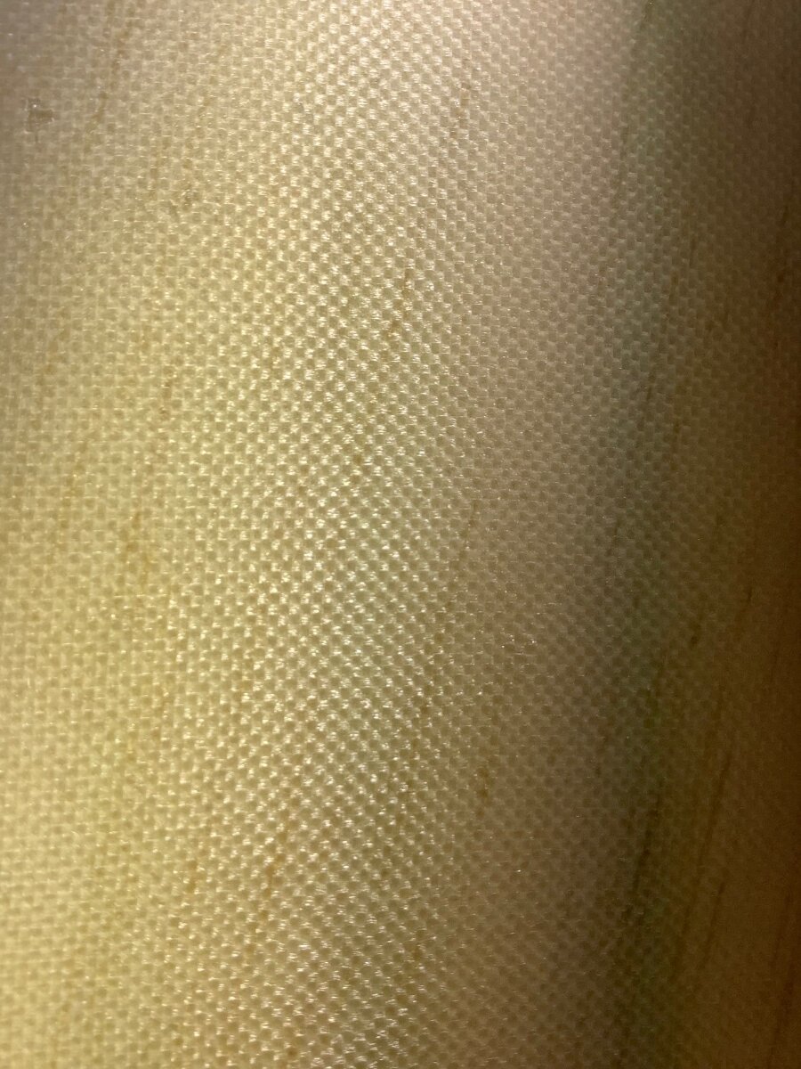

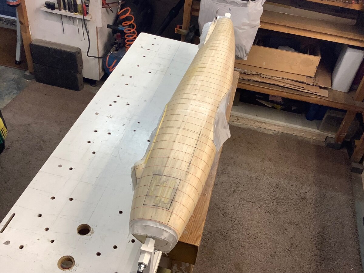

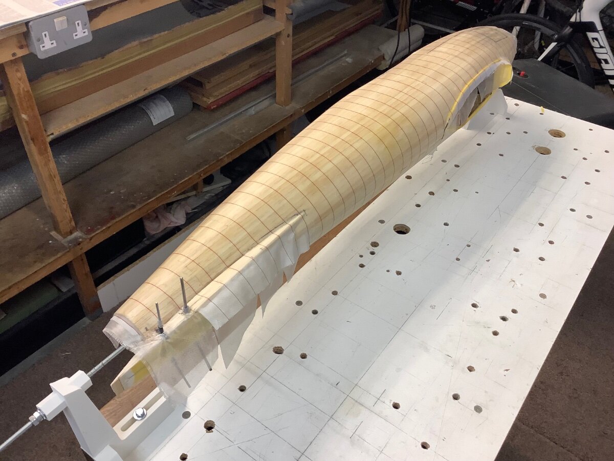

MikeQ Posted May 1, 2024 Share Posted May 1, 2024 (edited) Hello just on with glassing my Sabre. I use West System, 3/4oz glass cloth and peel ply. First off is a coat of 30-50% Non shrinking dope mixed with microballoons as a filler (careful on foam core wings not to slosh it on). Lightly sand to knock off the fuzz. For me, the first advantage of the PeelPly is the consistent finish. Its an extra step, and uses more epoxy, as I’ve found best results are achieved by fully wetting out the glass then fully wetting out the PeelPly on top (hair dryer helps the resin flow out. You don’t want to see any puddles or shiny areas in the PeelPly. The second, and biggest advantage, is the slightly dimpled surface it leaves. It makes a noise like a zip being pulled up and down when sanding. You know when to stop sanding an area when the ‘zippy’ noise stops. Start with 120 grit dry to get rid of most of the dimples and then go up some grades wet for a nice surface ready for priming. West System dry sands to a powder nice and doesn’t ball up if you keep your paper clear on the lower grades (rub it on some foam to clear it). If I go through the glass I flood on a bit of thick zap and rub in with glass powder from the sanding. Then sand again. Repeat as needed. If you don’t go through you are sanding enough off 😂 On curved/compound surfaces you can use patches of peel ply. You end up with little lines in the overlaps but easily sanded down along with all the rest. Not saying this is the only, best or cheapest way but works for me. Mike Edited May 1, 2024 by MikeQ Quote Link to comment Share on other sites More sharing options...
Andy Stephenson Posted May 1, 2024 Share Posted May 1, 2024 When using PeelPly always leave a free edge you can grab hold of to pull it off with, otherwise you will have a devil of a job getting it started without damaging the surface. 1 Quote Link to comment Share on other sites More sharing options...
